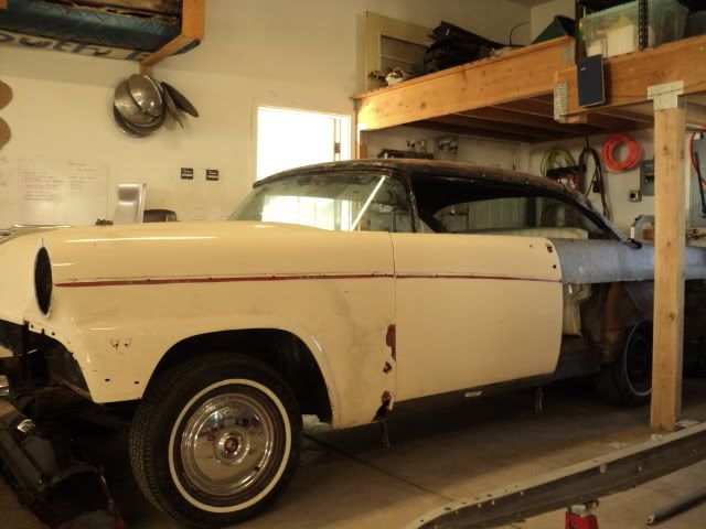

    yet... but chopping a 56 ford 2 door hard top is hard work! I have sunk the windshield on this one.

    as soon as all the metal work is done. But I might hold off till tech week. I have actually made this one look easier than the 47 I chopped earlier this year.

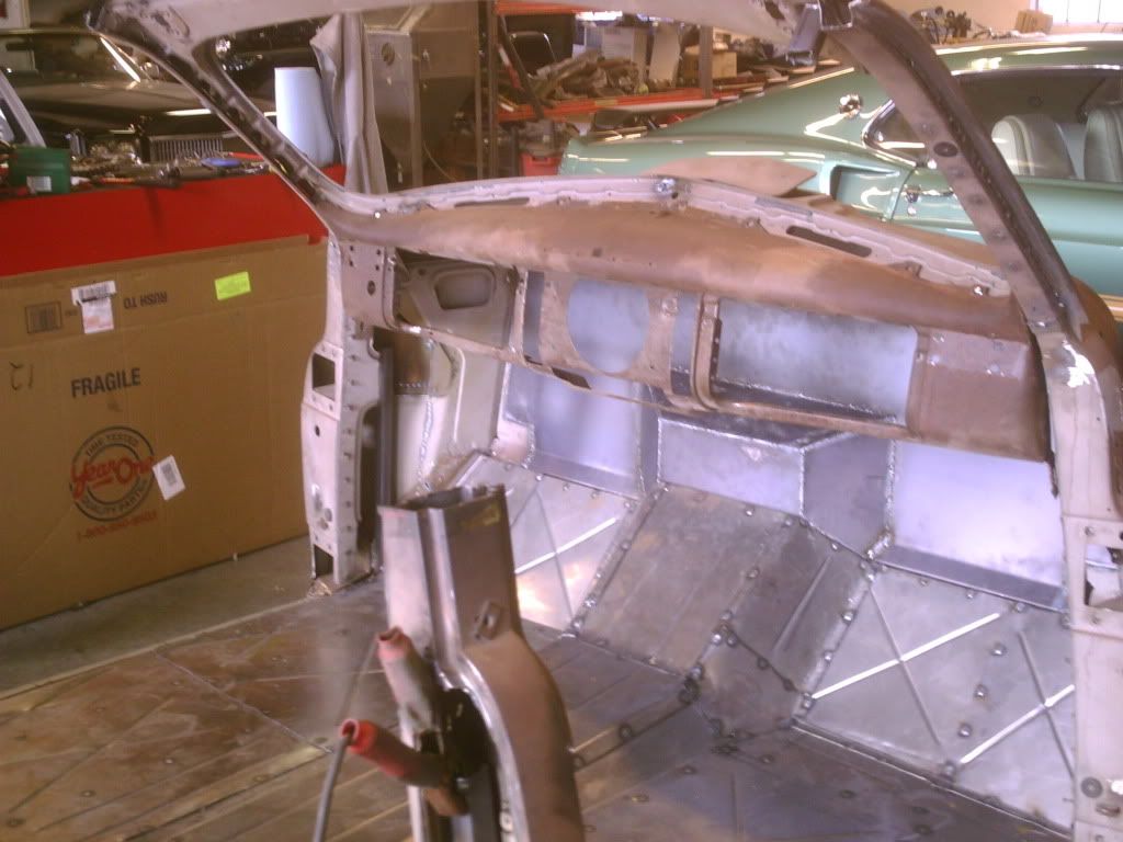

    and a few on the 58 chevy that I showed pix of before with the lego holding the filler. Needed floors. Here they are welded, seam sealed and then coated for durability. done top AND bottom

    I actually pick up some stuff from autozone. But make sure it is full bodied seam sealer. Use a glove to smooth it out and it ends up lookin factory!

    the '56 is like a conspiracy theory. looks legit on the surface, but is a total cluster of ugliness underneath. wow. as the owner i would not have been happy to find that.
    good thing it's in the hands of someone who can save it. i would have driven it off a cliff.

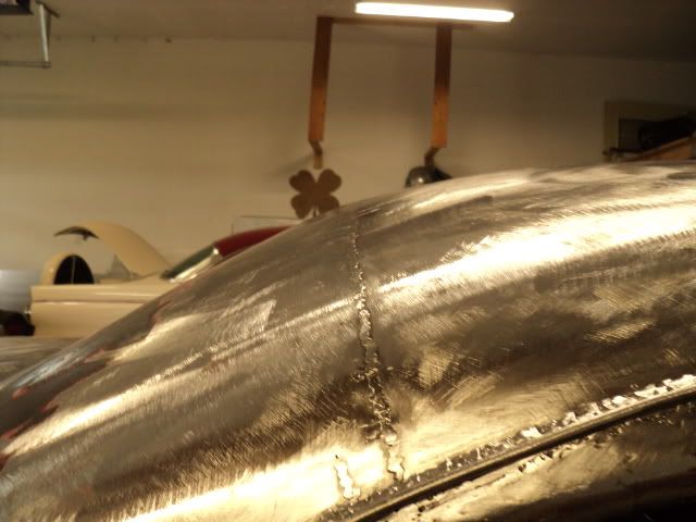

    and getting to the cowl for the sunken windshield chop on the 56 hard top. I really need to start a thread on this one. I have 100's of photos so far!
