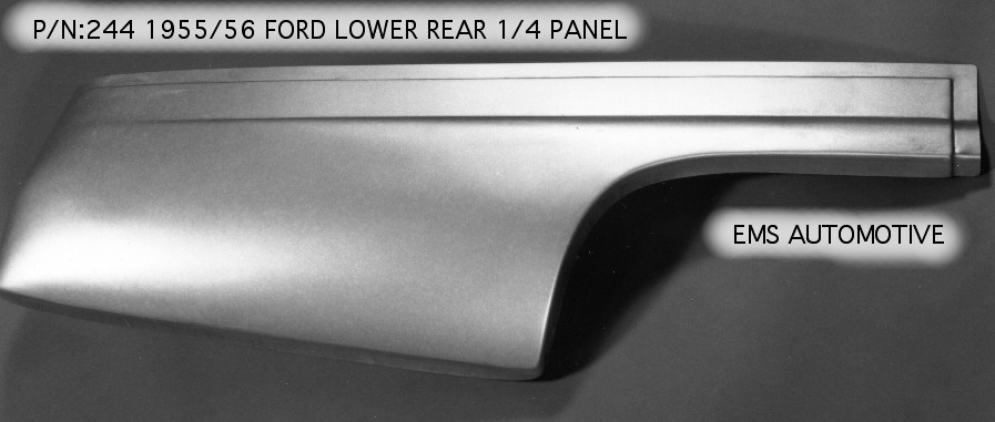

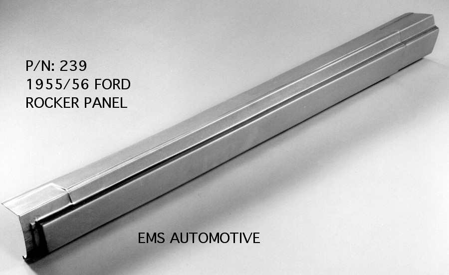

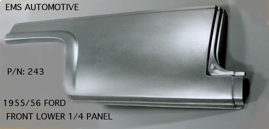

    Rust repair.com. The floor was great. THe quarter panels, not so much. Rockers either. However, I have not found anyone else that makes the rockers. I had to reshape them. Didn't even come close to fitting.

    rustrepair.com is also mill supply company, from the photo's you have ems automotive floors and toe boards, but the 1/4 panels are not ours looks like they came from schott metal products and i would ***ume the rocker did to. i did not see a photo of them.
    i am not sure if mills supply removes our identiy label or not
    try our web site www.emsautomotive.com
    would like to hear more

    Love the way you are right on top of this stuff. And yes, after looking they are schott. Thanks again.
