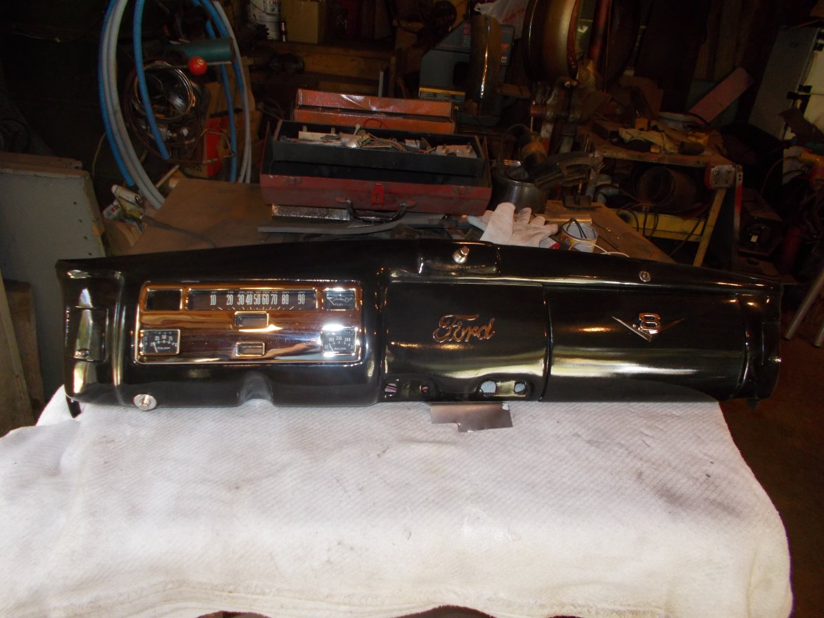

    I combine '33 - '36 car and '40 car dashes, [pic]... you could combine your '39 truck and a '40 car the same way....
    I do this so the dash can be mounted a little easier... I have the roof and posts to a '39 truck, rusty cowl top... free if you "swim" over and get them... DSCN1430.JPG
