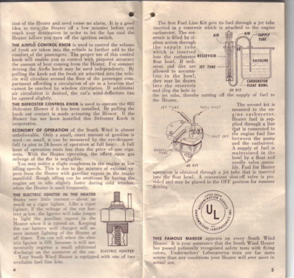

    They were a popular aftermarket 30's 40's+ heater that ran off of the (correct) air/fuel
    mixture of the carburetor.
    A thin plate was installed under the carb that had a tap for the heater to draw off of.
    Volkswagon used a similar idea for years.
    Despite popular misconception, they were considered safe and reliable as long as they
    were well maintained (fittings kept snug).
    The design of the heater insures that it is shut off as soon as the engine stops running.
    If there was no air/fuel going thru the carburetor, then there was no feed for the heater
    to run off of.
    They do supply good heat, and if installed properly they will defrost the front windscreen.

    If you need a complete manual (26 pages+/-), someone posted all the pages on the hamb some time ago
    and I keep a copy of it here:
    http://s201.photobucket.com/albums/aa296/moefuzzz/SOUTHWIND HEATER AND TEMPLATES/?start=all
    A quick reference to get you started....

    The Southwind gas heaters that I've used over the years use a fuel line t-eed in from the fuel line that runs from the gas tank in front to the engine in the rear. The VW units have there own fuel pump. Because of the age of these units and the new ethanol gas, the fuel pump diaphrams are the weakest link. Rebuilding the fuel pump is easy and simple, just get the correct diaphram material to withstand today's fuel.
    As some have pointed out on this forum gas fired heaters have been used for many years on school buses, thousands of small private aircraft, civilian cars and trucks and recently 24 volt military trucks. Swiss made Pinzgauers also had some of them on their units and used them with great sucess. The principle of operation is simple, reliable and extremely functional. There are risks with anything, hell, you can hit by a bus while crossing the street. But the fact is I feel safer running my gas heater than crossing the street. Do your homework if you intend to use any gas heater. Get an owner's manual and install everything to spec. I pre-test all my Southwind gas heaters outside on a bench. Follow the manual and you'll never have a problem.
