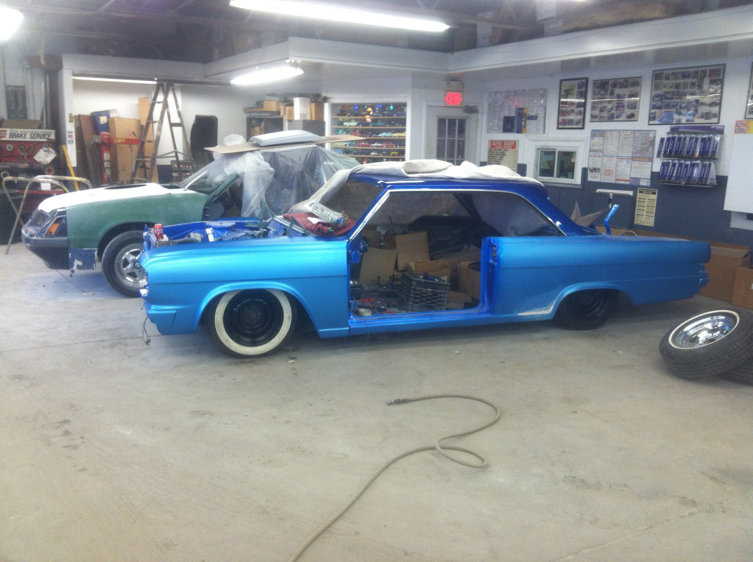

    thanks guys, just sorting thru the boxes of parts to get all the dash trim together, dyed the dash pads and polishing all the chrome and stainless. started with 2 complete cars so we got boxes of **** all over the place for this car, but we're still moving forward!

    Is the blue on the bottom of the car basecoat alone, or basecoat with a flattened clear?

    it's just the basecoat for the candy. i like to put color on everything after i seal it so after its all ***embled for final paint , just scuff it w/500 grit, couple more coats of color, then candy and clear. thanks.

  22. Hellfish
    Joined: Jun 19, 2002
    Posts: 6,814
    Hellfish
    The body blue is stunning as it sits. It looks like it's glowing! I'm sure it will look good glossy, too.

  27. RamblerJoe
    Joined: Dec 29, 2014
    Posts: 12
    RamblerJoe
    Ready for paint first thing Monday morning.

    Pictures don't do this color justice at all, my dad (autobodyed) did an amazing job with this paint job.
