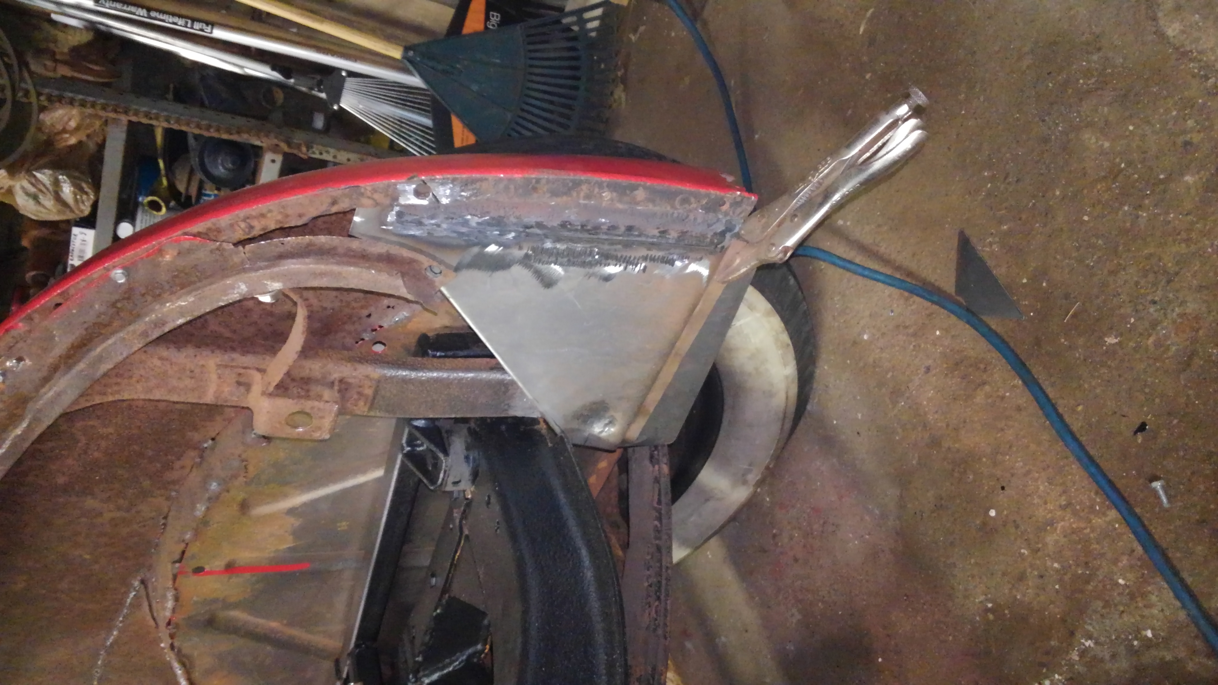

    I had a spare support so I used it.
    It was a wee bit wide so I sliced, hammered and welded it.[​IMG][​IMG][​IMG]

    It is at this point that I like to trim off the harder curved trunk gutter and replace it with a home made gutter that follows the quarter's radius down to the floor where I drill a drain hole which I drop a screw with lock washer into, water drains around the washer but not much gets back in...HIH.

    Ron, the next time you want to dimple a panel like this try drilling a small hole in the center first then put your dimple in. You should find the metal will move much easier. Please note the hole will also get larger so I stress "small hole". See ya in the spring...

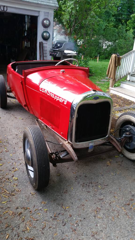

    Pulled out the roadster today to meet it's brother from the same father[​IMG][​IMG]
    Sent from my E6810 using The H.A.M.B. mobile app

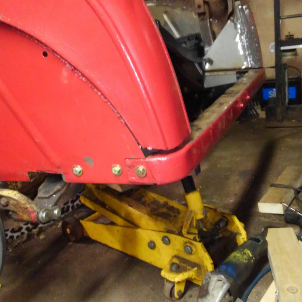

    Cut out of work last two days. 10 hrs instead of 13. Right into the garage I went. I had to secure the body to the frame and subrail. Last year it was sheet screwed and wired.
    So I lined up the cowl, doors, and quarters. Now both doors open, yay!
    Mounted a new panel below the trunk. Tomorrow is rumble lid time.
