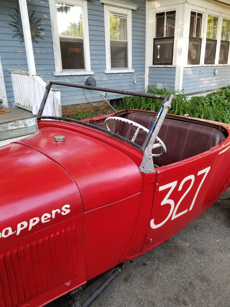

    I have been working on getting the roadster ready for the street.

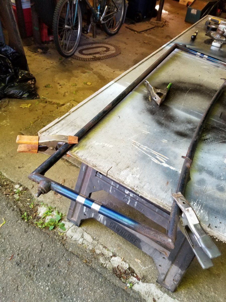

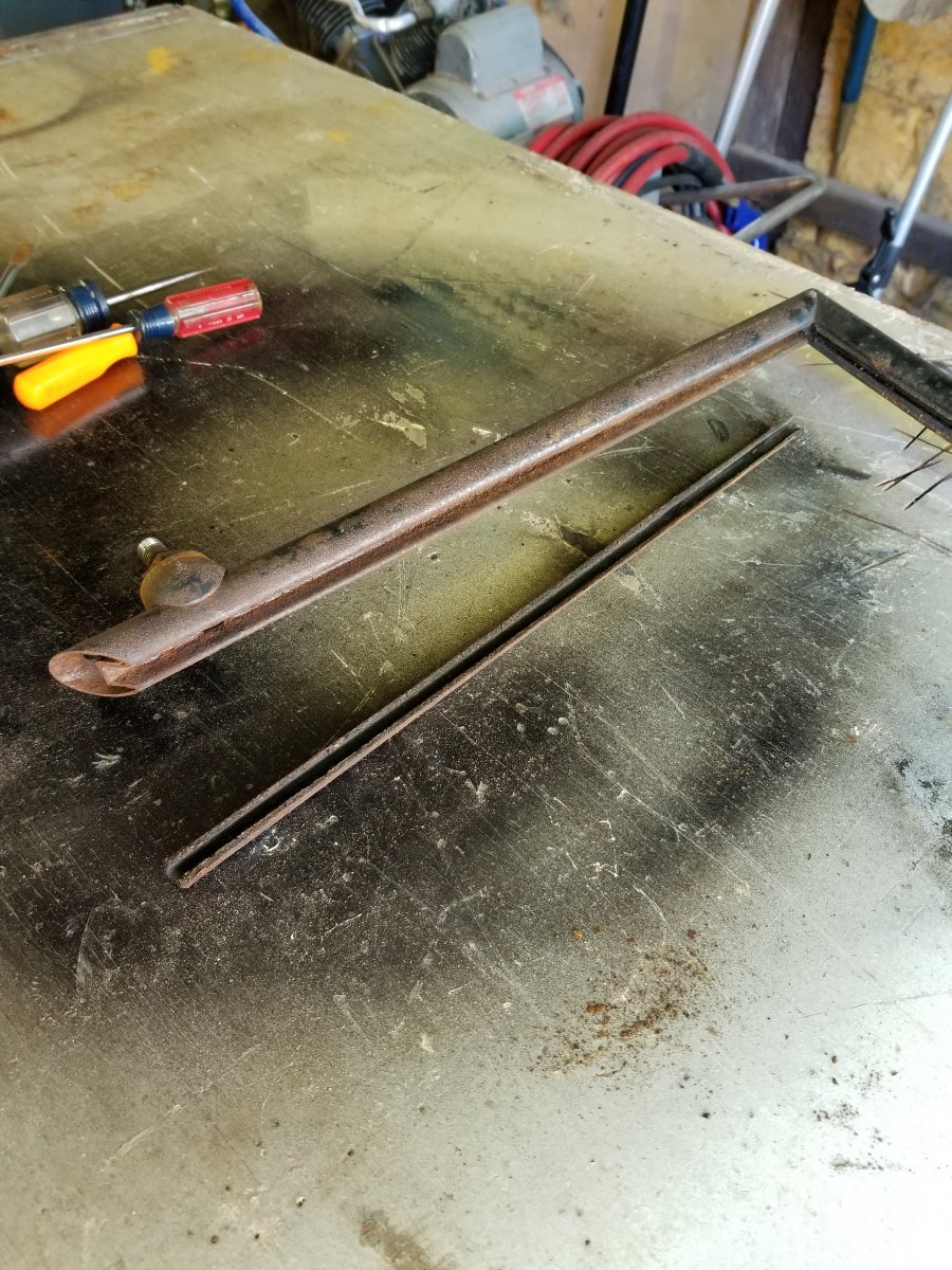

    Mounted headlights awhile back. I made windshield stanchions from 25 model T stanchions. I found an original windshield, pricey but worth it. No rot and the screws all came out!
  3. wheeldog57
    Joined: Dec 6, 2013
    Posts: 3,857
    wheeldog57
    20190609_170805.jpg 20190609_172818.jpg 20190609_175553.jpg 20190609_182431.jpg of course I had to chop it. Check out how mint the windshield frame is, even the gasket came out in one piece

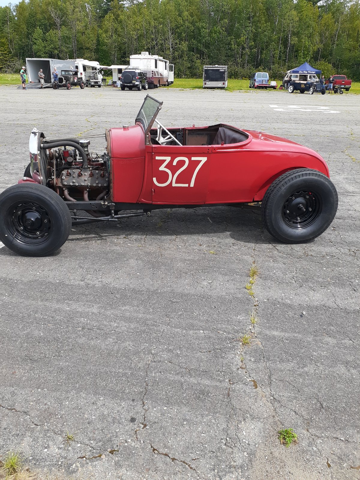

    I bring the roadster to a race and it doesn't want to run. I had approximately 20 gifted guys and gals working on the secondary ignition Friday and Saturday, we all decided the dive helmet distributor needs to be thrown into the woods.
    I had it on and off 7 times on Friday and 3-4times on Saturday. 20210820_141739.jpg 20210820_141747.jpg 20210821_104732.jpg 20210821_132039.jpg
  13. wheeldog57
    Joined: Dec 6, 2013
    Posts: 3,857
    wheeldog57
    We tried EVERYTHING to no avail.
    However, even though I worked on the car for 13 hours Friday and 6.5 hours Saturday I still had fun and learned ALOT from some very smart gear heads.

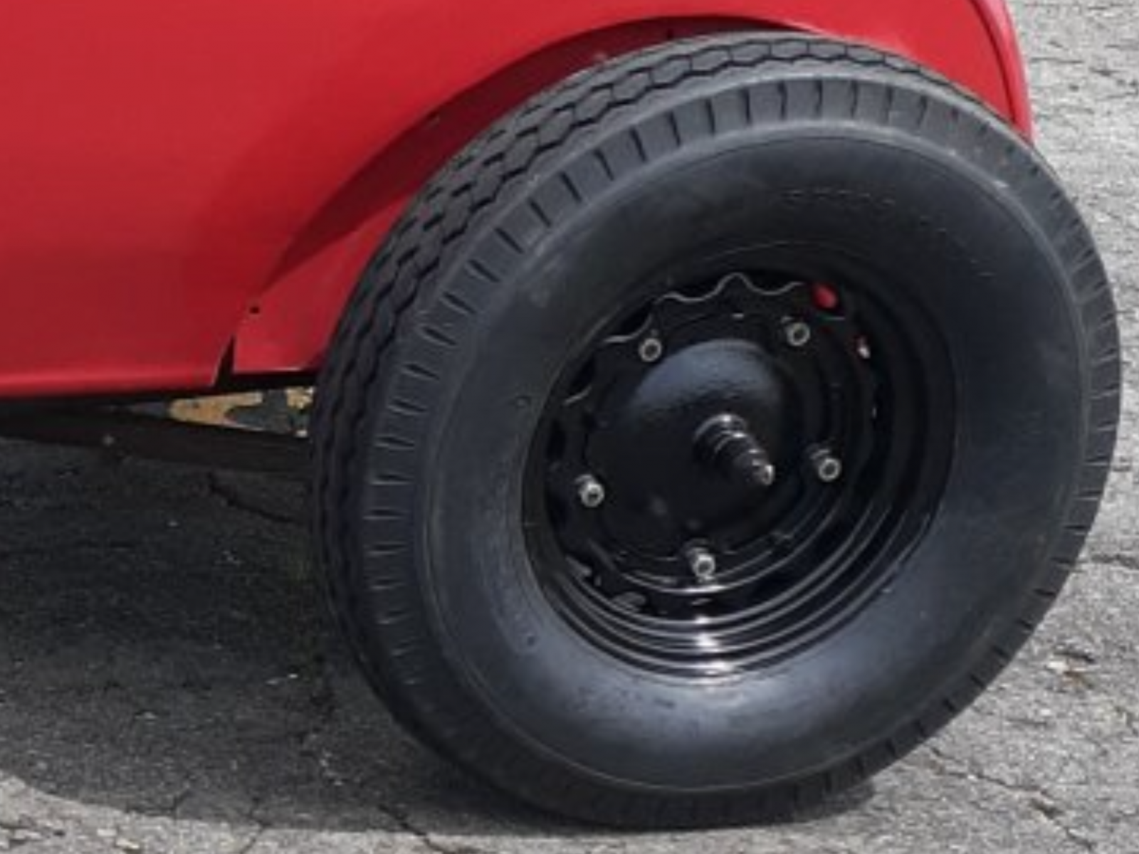

    What size and brand are the rear tires?
    Any idea how tall they are?

    @A ***** 7.50x16 cheapos off the web 10 ply
    A Boner likes this.

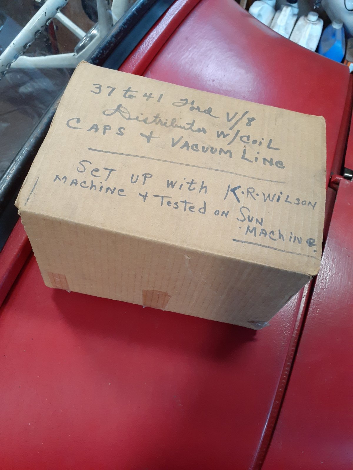

    I really want to run this car at Pinetree Jamboree in Winterport, Maine this August so I got back to basics. In the course of trying to get it running and trying EVERYTHING under the sun at 2021 PTJ, we smoked the ballast resistor, swapped the wires on the coil ( I am baffled by this) and the original distributor was the main problem.
    So, long story longer, used-known good 2 bolt crab distributor and front cover, new points, condenser, wires, plugs, and resistor. . . . Wait for it. . . . . My s**** pile runs again!!!
    I am thrilled!! I put in for a spot at PTJ 2022 and am hoping to run at Jalopy hillclimb this fall in NH also. Thanks again for all the help and advise from everyone!!!
