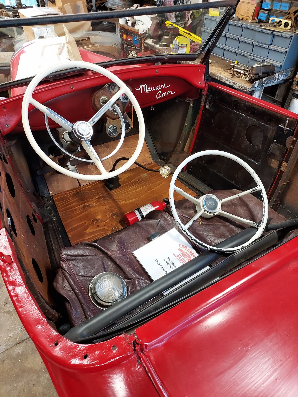

  1. wheeldog57
    Joined: Dec 6, 2013
    Posts: 3,848
    wheeldog57
    Out with the newer and in with the older, cooler, and almost fits the column bell 20230623_175617.jpg

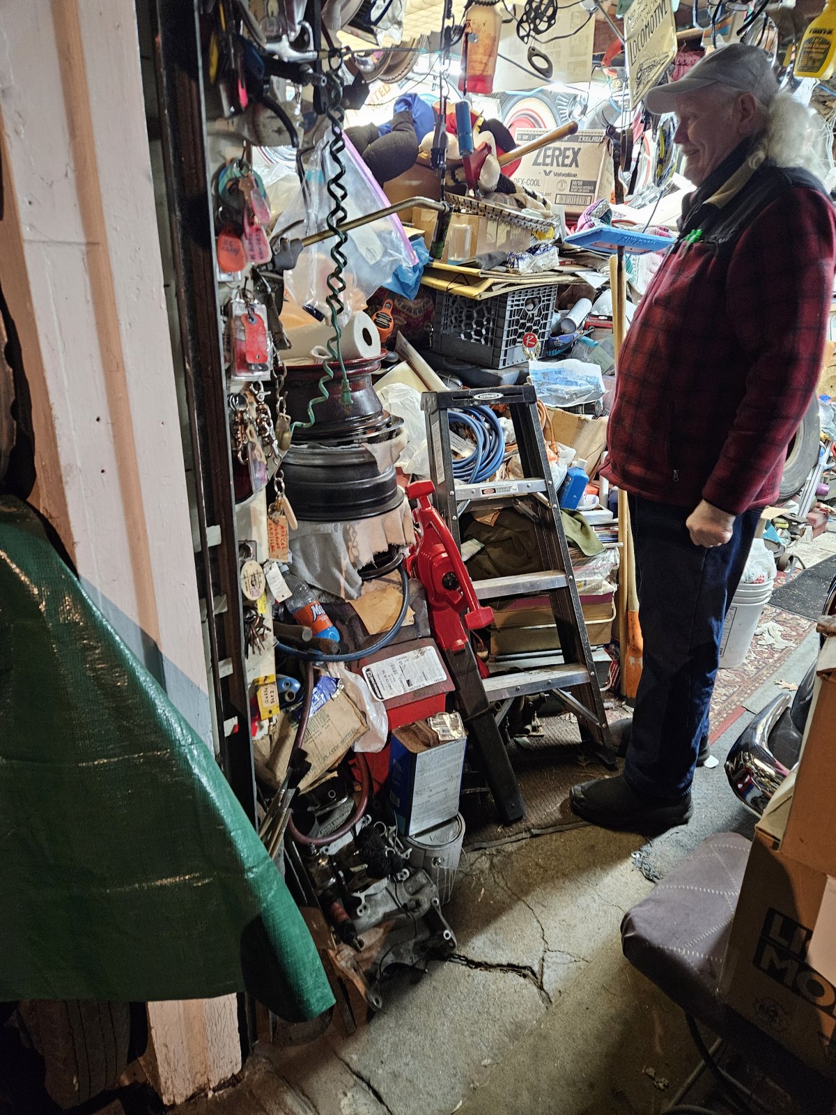

    Made a deal on a rebuilt 1950 255ci. Looking to slam it in the roadster in the next few weeks. Rebuilt by Phil Miller right down the street from my house.
    Going to be an adventure removing it, it's about 6ft to the left, hahaha 20240214_175752.jpg

    Who knows what other treasures you'll uncover once you start the excavation!

    A short block 57 283, v8 60, and a Rambler motor in there as well.

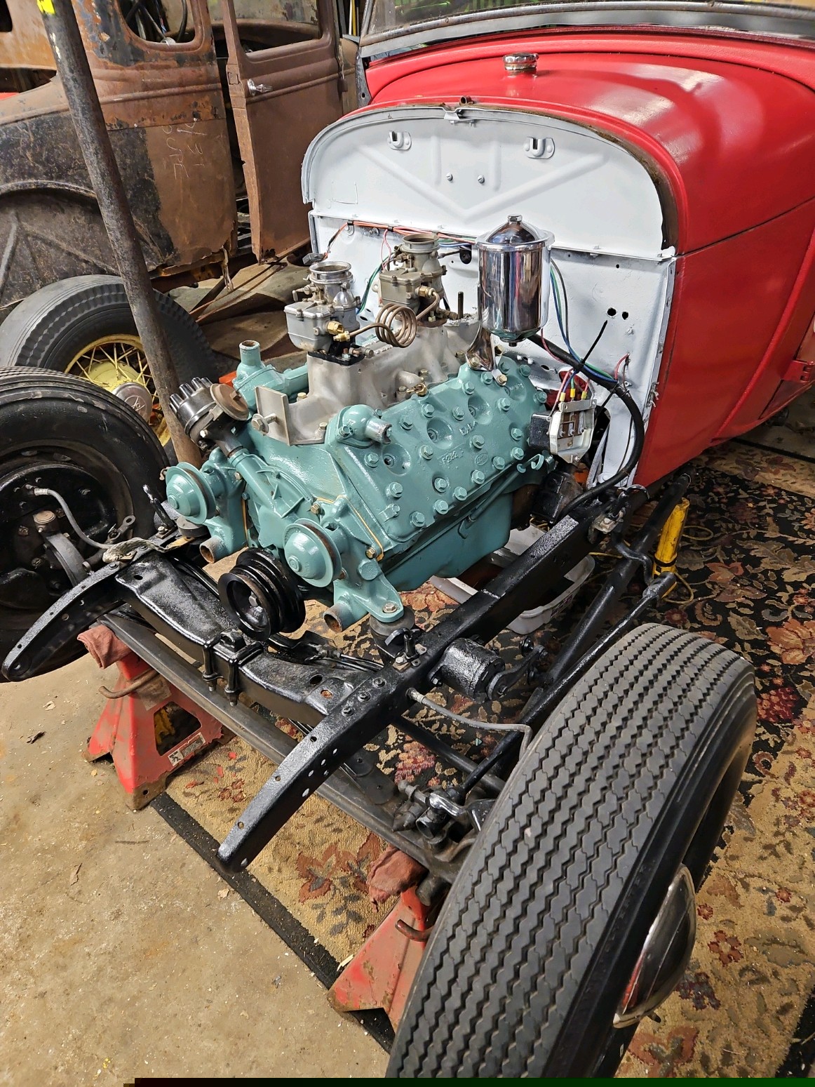

  8. wheeldog57
    Joined: Dec 6, 2013
    Posts: 3,848
    wheeldog57
    Felt kind of sad pulling out the motor I put together myself but. . . . . Got to make way for 255ci 20240308_173921.jpg 20240308_183258.jpg 20240308_203221.jpg 20240227_200059.jpg

  10. Jeff34
    Joined: Jun 2, 2015
    Posts: 1,241
    Jeff34
    Is it gonna fit with those 8RT pumps on the front, or are you going to switch them out for the shorter pumps and single crank pulley driving everything?
    winduptoy likes this.
  11. wheeldog57
    Joined: Dec 6, 2013
    Posts: 3,848
    wheeldog57
    @Jeff34 nah, I don't think it'll fit. Looks like the belt will hit the distributor.

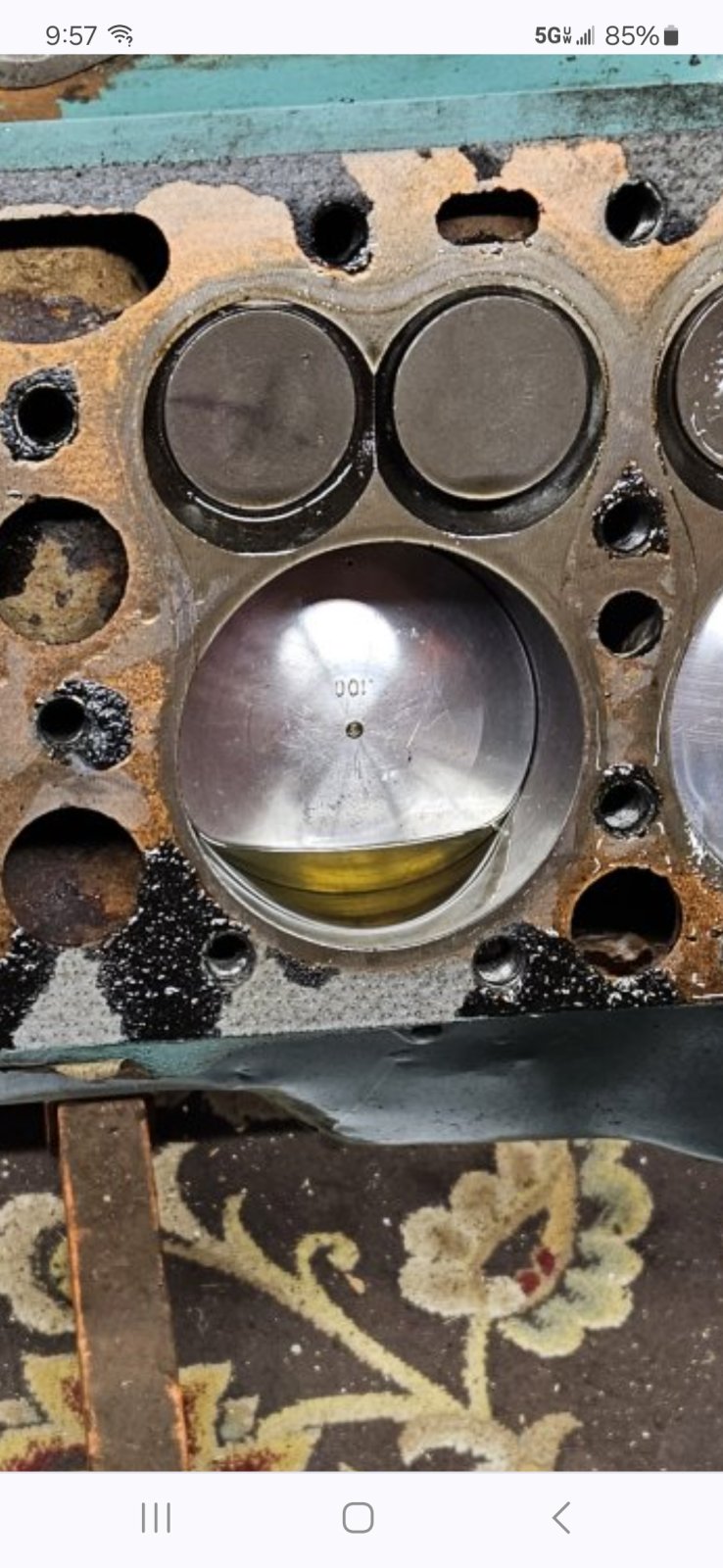

    Interesting. . . . . 7-25-73. 030

    .100 over! If that's correct, she's a bit bigger than 255 now. I've heard you can bore some of those blocks out .125 but you've got to check a ****load of them out with some kind of sonic testing or something to make sure the cores were perfectly aligned when it was cast.
    She's damn clean inside though, a sight better than the 255 Merc I brought home a couple years ago which had a very active mouse nest under the intake.

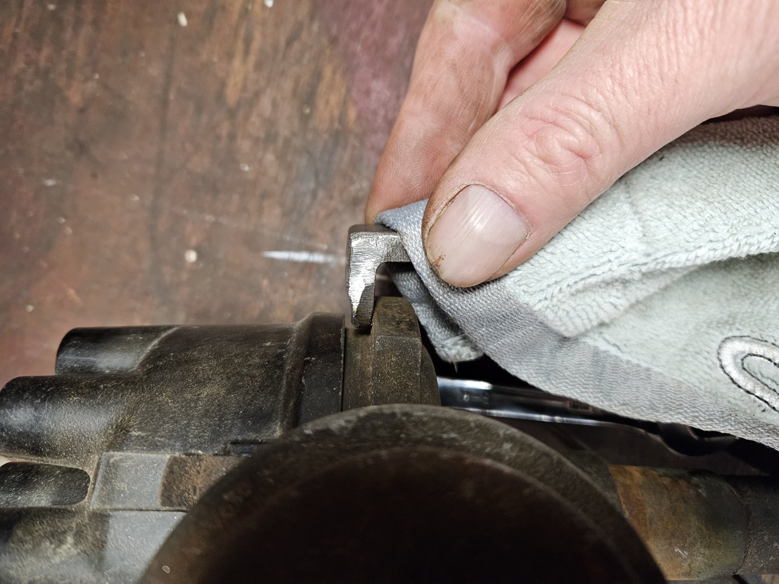

    A couple years ago a fellow 'Snapper asked if I had a distributor hold down for an 8BA. Hes building a 28 RPU. I took it off the motor under the bench never thought about it. . . . Now I need one. So I made it.
    I don't even remember what it's supposed to look like but I bet it's something like this 20240327_193108.jpg 20240327_193509.jpg 20240327_194426.jpg 20240327_200227.jpg

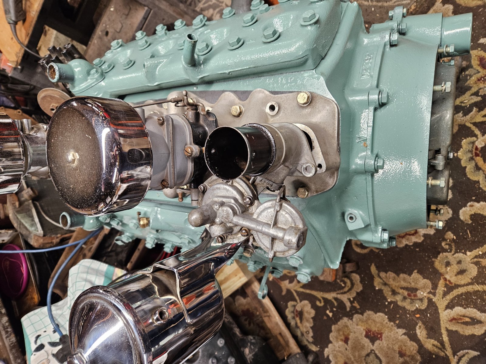

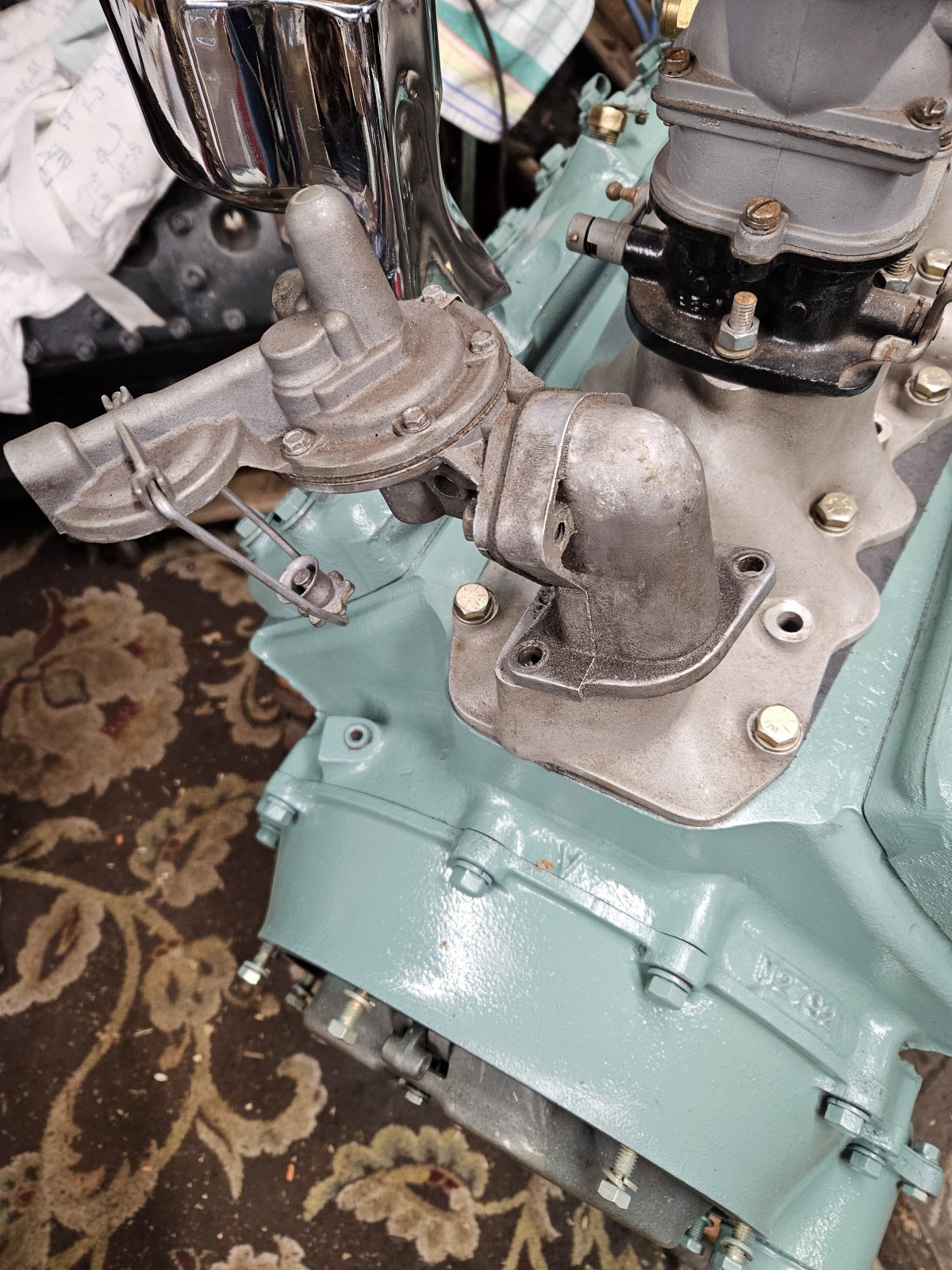

  19. wheeldog57
    Joined: Dec 6, 2013
    Posts: 3,848
    wheeldog57

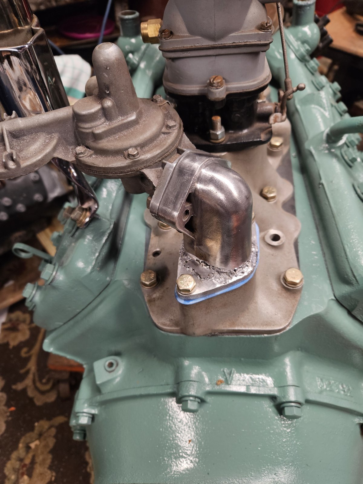

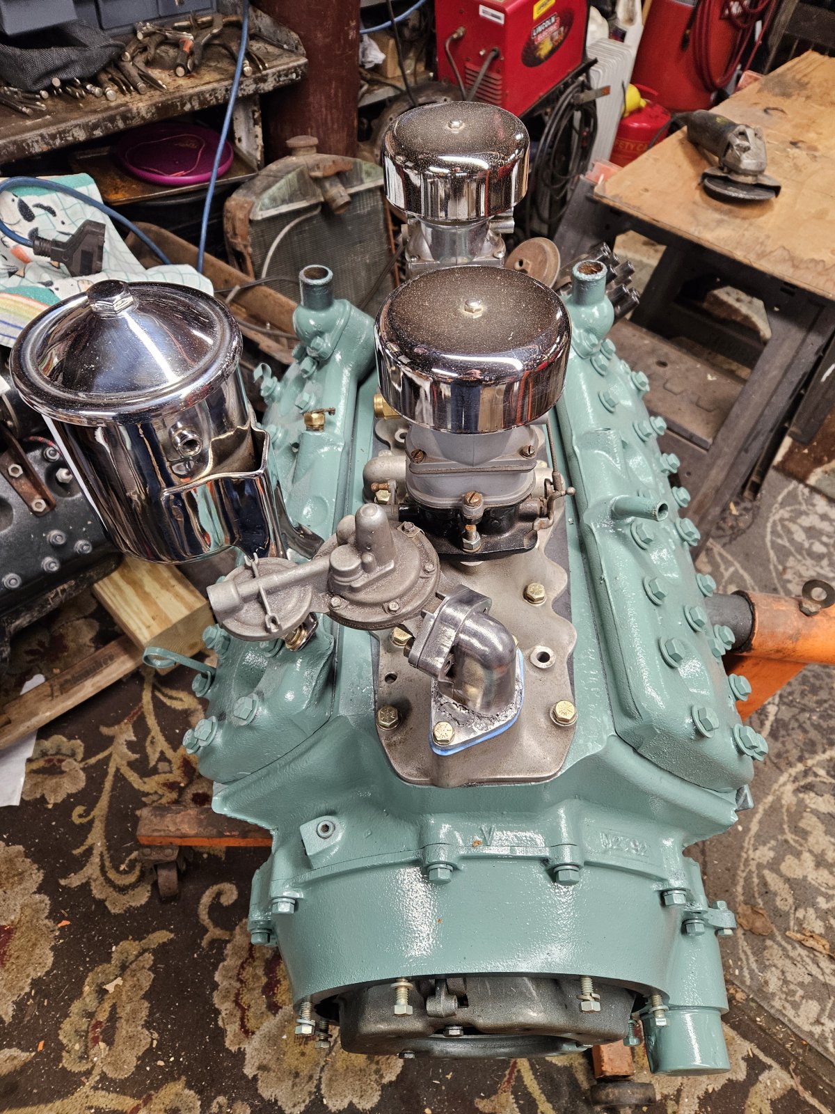

    Offy intake has canted fuel pump mount where my old motor had straight mount.
    After much consideration I cut and welded. MIG was not happy on that alloy!
    20240328_192622.jpg 20240328_192651.jpg 20240328_201910.jpg 20240328_201914.jpg
    Now I have to figure out how to fill the oil, hahaha
  20. wheeldog57
    Joined: Dec 6, 2013
    Posts: 3,848
    wheeldog57
    The fuel pump stand broke right off when I was stabilizing the motor on the hoist.
    But it's in
    Jeff34, Outback, brEad and 9 others like this.

  24. Jeff34
    Joined: Jun 2, 2015
    Posts: 1,241
    Jeff34
    Yeah, MIG welding AL can be difficult. I'd TIG it myself, and I'd probably pre-heat the parts before I welded them. I've done that before with good results, especially on thick material.
    brEad and wheeldog57 like this.
