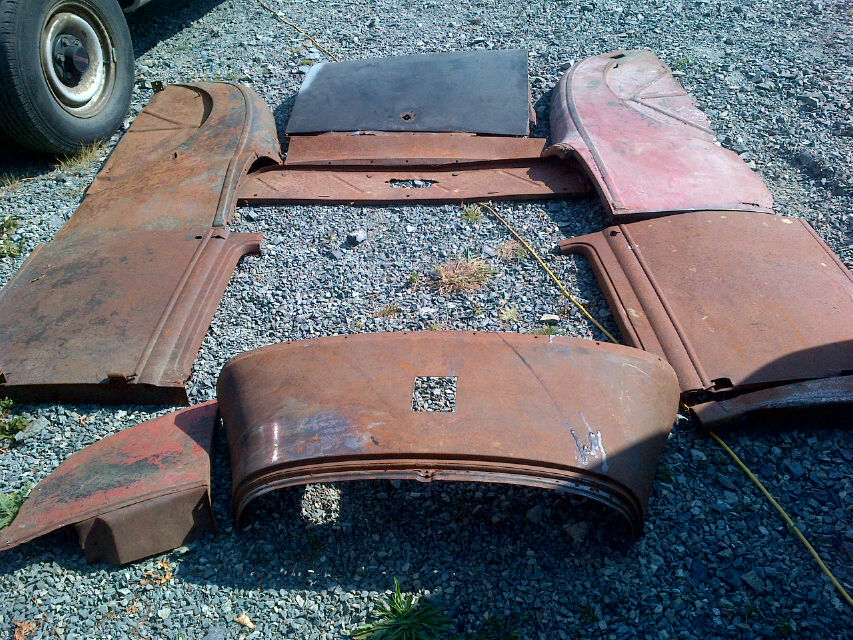

    Your coupester pile has '30 -'31 doors but '28 -'29 coupe, sport coupe quarters, the q's are not tall enough to flow into the beltlines... I used 5/4" plastic decking... careful some have cost saving dimples on the underside, it is flexible, on a hot and sunny day I let it SAG over a horizontal beam, hung a tire and rim on each end, it bowed over 2 feet, then I cut some posterboard templates of the quarter and tulip panel's top edge... then transfered that outline to the 5/4", cut them out with a saber saw / metal blade, some of the 5/4" have sawdust moulded into it, you can sand it ! I cut slightly bigger and then sanded... the bolts also easily PULLED the 5/4" down flush with the q's...
    pic #2 is a '29 sport coupe come cabbie with 5/4" plastic decking...
    pic #1 is a coupester useing the forward 16" of '35 tudor door patches as cowl patches, that leaves about 28" of flat patch panel, used them on the doors, a pair of '30 doors and '29 q's with '29 La salle ****pit combing and a 5/4" top rail......

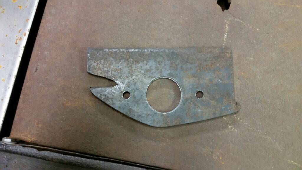

    With the steering sorted, up next is the brakes. The pedals are model a that I hacked and bent up to mount on the x member with the original shafts. I fabbed up a plate to mount the master cylinder 1483146402368.jpg

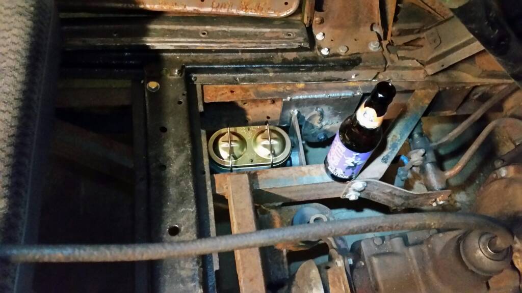

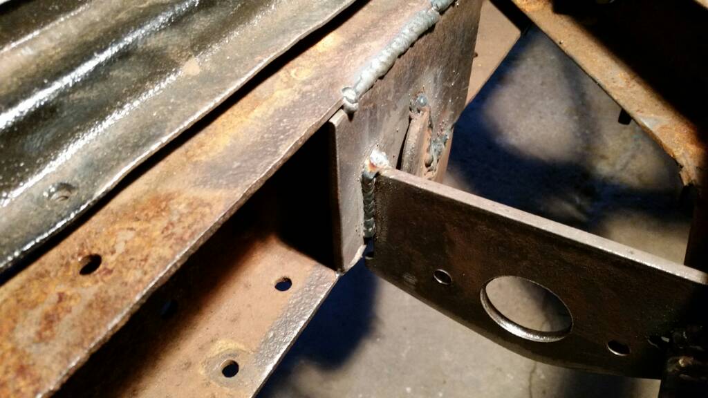

    Go a lovely bout of food poisoning a couple days ago but I got some done today. Welded up the master bracket. I thought I had a clevis from an old Camaro but after an exhaustive search I didn't find it. 1483397598562.jpg 1483397605117.jpg 1483397612445.jpg

    Gee, sorry to hear about that! Looks to be a long reach between the master and the pedal- are you extending the push rod?(or maybe you already have a long one?) I got my clevis from NAPA. Love the look btw!

    Master cylinder bracket looks good- is that a bottle of "break fluid" next to it? (HaHa)
    A guy with your talents should have that MC working in no time!

    I am going with the extended version of the push rod

    Thanx Mike, that bottle is ****tynose porter.

    Thanks for the ingenious suggestion! hmm my tape measure doesn't seem to have 5/4" on it :confused: I have an idea or two for the blending most likely bending the upper belt line (about mid way) over 90 degrees on the door tops and using tube or 1/2 round around the rear.
    I'm pretty sure I am further "up" than you lol! this stuff is all Canadian the guy I bought this stuff from does source from the eastern provinces which are a bit drier but this was pulled from the "junk" pile the left over parts discarded after someone bought a "good" replacement 1/4, cowl etc. from him....the pics might be deceiving there is not a straight panel and the bottom 6-8" of everything is swiss cheese....the roadster stuff is probably 10x worse because it was a Vancouver Island (ocean) car :)
