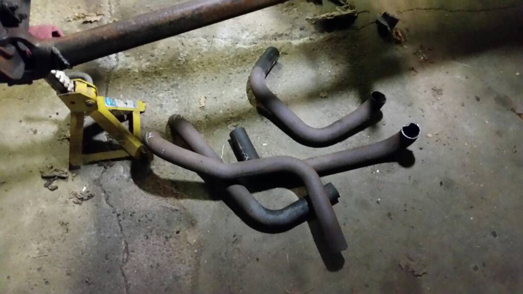

    Last year a guy on the HAMB gave me an old set of headers, thanx Zeke32. I chopped 'em up. . . I now need to make them fit- I have a couple options 1490578319930.jpg 1490578329104.jpg 1490578336464.jpg 1490578345044.jpg had to see how the caps will look

    Now I have about 10-11hours into headers 1491095632872.jpg 1491095643130.jpg 1491095659171.jpg 1491095672505.jpg 1491095694755.jpg 1491095712585.jpg

    Jeezus, Ronnie- I've got THAT to look forward to making headers?? I'll be cross eyed! HaHa
    No joke, you're moving right along, Kiddo!

    Impressive job on the exhaust! The whole thing is coming together really well.

    Today was grinding and welding, finishing up the headers then onto the rad/grill shell/hood fit debacle. . .I think the rad shell has to go up another inch to get the hood where it wants to be 1491175485834.jpg 1491175492767.jpg

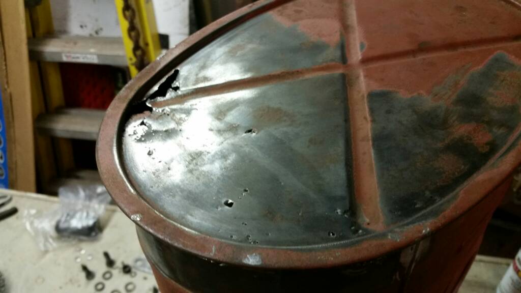

    I needed to patch a hole in the tank 20170427_201943.jpg so I wire wheeled it and. . . 20170427_202735.jpg 20170427_202740.jpg now I need a tank. Ever try to mig weld over solder? Hahaha, not happening!

    Bummer on the tank. I like the column drop/tach mount though!

    Ronnie- we can shoot over to Vinny C***idy's and look for a tank if you want- he's usually got a few in the collection. Everything's lookin' good!

    Go go go.....just hook up the front brakes for now....hang the column with coat hanger .... put a boat fuel tank in the front seat....oh wait, that's what I'm doing.

    Ron if it helps and you don't come up with a tank, I have the tanksinc poly tank that came with my car. It has the mounting straps and all the doodads you would need to get you to the race.
    More than welcome to use it ...
