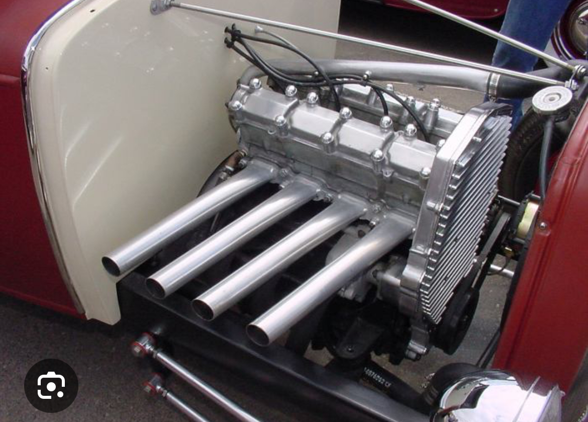

    I love the looks of @pecker head 's little roadster pickup.
    Been thinking about using a later 4 banger from like an HHR or Ford's version. I need something super common, with a 5 speed that has a rear wheel drive ******. Easy on gas, easy to find parts. No frills, just the bare necessities.
