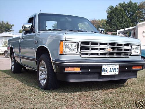

    You want economical, but you will also want some performance. You will also want some comfort if you are going to drive it 90 miles every work day.
    Yes a light vehicle with a 4 cyl will be "peppy"............but I doubt a roadster will be cheap or comfortable for long daily drives in the sun or rain. Best something with a closed cab and A/C. My son had a 4 cyl S10 and I can tell you from experience that the dang thing just kept shifting up and down at highway speed and every grade. Annoying as hell.....and I like S10 trucks. If you get a manual trans, you will find that a small low torque engine will require shifting and shifting and shifting some more........especially if you have the A/C turned on.
    The V6 S10s ....especially with a 5 speed don't have any of those problems and are pretty quick.....not hot rod quick but they will outrun soccer moms.
    Moving along.........The easiest bang for the buck would be an S10 with a smallblock V8 and a 5 speed. You can find them easily with blown engines. Don't worry about headers and steering clearance. The LS is a wider V and is harder to install. I have one in my pole barn that I'm putting an LS3 with a 5 speed in......so I know it gets into a lot more parts changing ($$) for brackets and stuff.
    The A/C will be a little challenging no matter which engine (LS /SB). I'd look for an engine out of a late 90s Chevy pick up and get the computer with it. You can get harnesses to adapt it.........or go with a Holley injection. Put that in place with a 5 speed and it will cruise and get good gas mileage as well. I like the old Square body but a decent later model is easier to find. Its best if you find one that already has a clutch pedal if going to run a manual trans.
    Then slick the outside up a little if you want it to look hot roddy.
    Get a used copy off Ebay "Tbi and TPI engine swapping" by Mike Knell and it will tell you everything you want to know.
    Wish it was mine

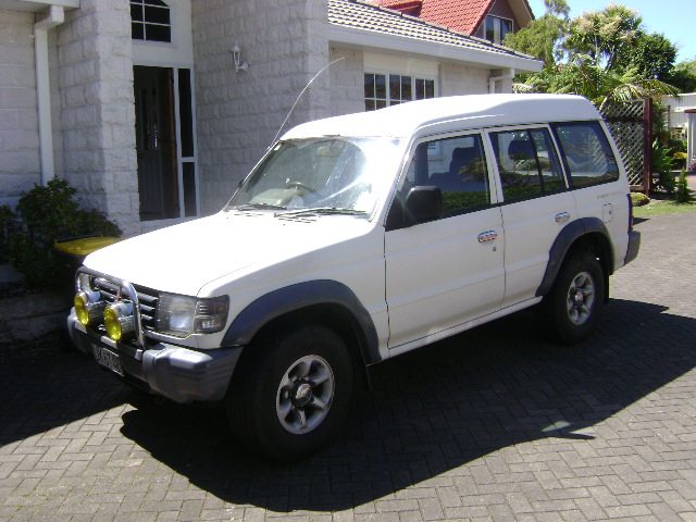

    Back in 2008 I was playing with alternative fuels for a Mitsubishi Diesel [4d56-T] in a Pajero 4 x 4.
    The alternative fuel was Waste ATF that I got for free from the local transmission shop that I cleaned and blended with gasoline at 90/10 ratio.
    I travelled over 100k on "free" fuel [actually it cost the 10% gasoline content]

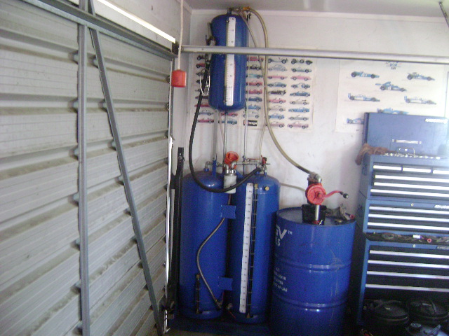

    Here is a "cold upflow processor" that I made from 2 propane tanks and a compressor tank.
    This ^^^ would dewater ,and separate the light from the heavy oils [and was closed-loop so there was zero spillage]
    AND I needed to be disciplined enough to throw out the heavy oils/sludge
    Understand there is no such thing as a "free lunch" ,I was swapping my effort for fuel.[it didn't make itself]
