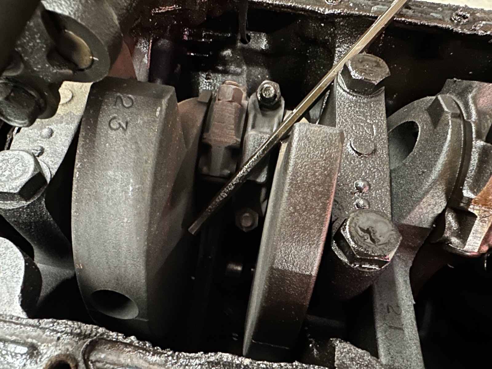

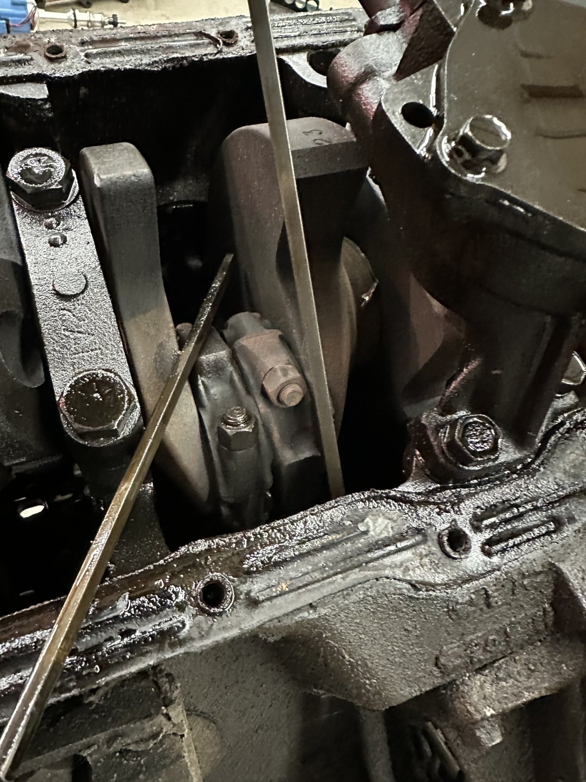

    IMG_7655.jpeg IMG_7656.jpeg Picked up a FE engine that seized. I assume the owner did his own distributor swap and dislodged the oil pump rod, the keepers were not on the rod. 1 and 5 rods got hot.

  2. I have seen those twisted like a barber pole.

    This one was just laying in the pan lol.

    Just below the oil pump I see a spun main bearing as well. Block is likely hurt too. That's a shame.

    Yep. Line hone needed for sure, rods resized, and what ever needed. Deciding if it’ll be worth it.

    That is when a piece of valve stem seal got in the oil pump and locked it up. Lol. I have fixed a many of them.

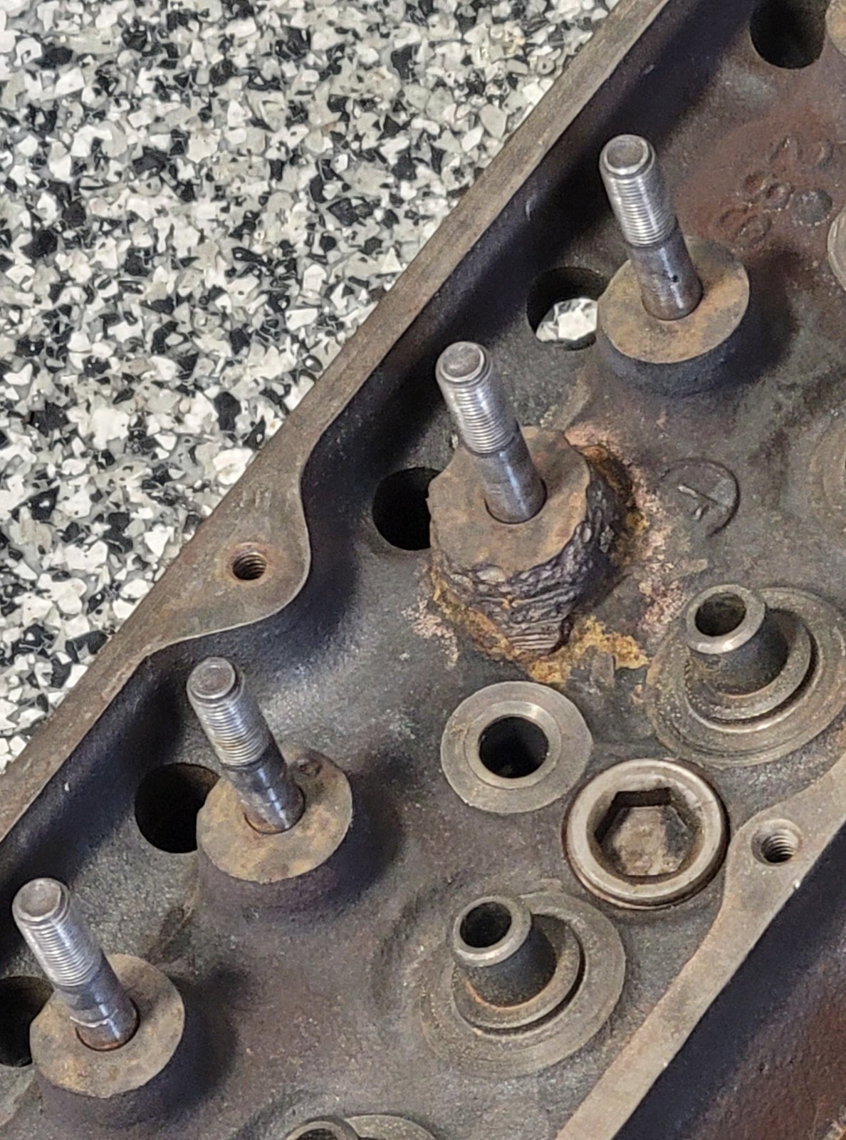

    Things can always be worse. I purchased my latest car, and this is what the seller didn't tell me.

    What the heck is going on there? Welded up and ground down?

    Truthfully, I got no idea what was going on, I just repurposed them into door stops. The guy also welded the studs to one of the brake drums also.
