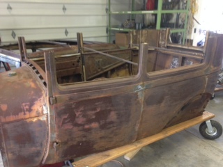

    1.jpg Son and I have worked together on several other type of projects over the past years, dirt bikes, race cars, airplanes, construction as well as in business. This will be our first attempt at building a street rod ! We have some fabricating knowledge that will come into play on this build. We will try and keep posting as we progress along and welcome all comments good or bad. We have gathered up a lot of ideas and help from the HAMB site and not sure this build would happen without all of your help. We have a few ideas for this build that will be different, hope you like them. More on them later !

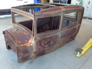

    We started gathering pieces about six months ago, first part to hit the shop was a 29A sedan body. We settled in on this body as it has NO rust, bullet holes or dents, just a slight layer of "patina" rust ! Most of the glass was still in tact ! According to the seller it came to AZ from S. Dakota barn ?
    First item of business was a 6in chop, a terrifying thought for two newbies. Thanks to all the posts we visited here it seemed doable !
    The backhoe came in handy getting the body from the trailer onto the rolling cart.
    Once room was made inside our overcrowded home shop we began laying out the chop/cut. We braced the body up for stability and started cutting. Didn't take long before the roof was off and the 6 in of excess metal was gone !
    The re-attaching of the top went pretty much as we had hoped with a lot of time spent on getting the angle of the "A" pillars correct and also the rear corners of the top. With the top welded back in place we set the body aside and made a trip to the local steel yard to gather up material for the chassis. Right now the chassis rails are under construction and eventually will be the platform for a suicide style front axle, Jag

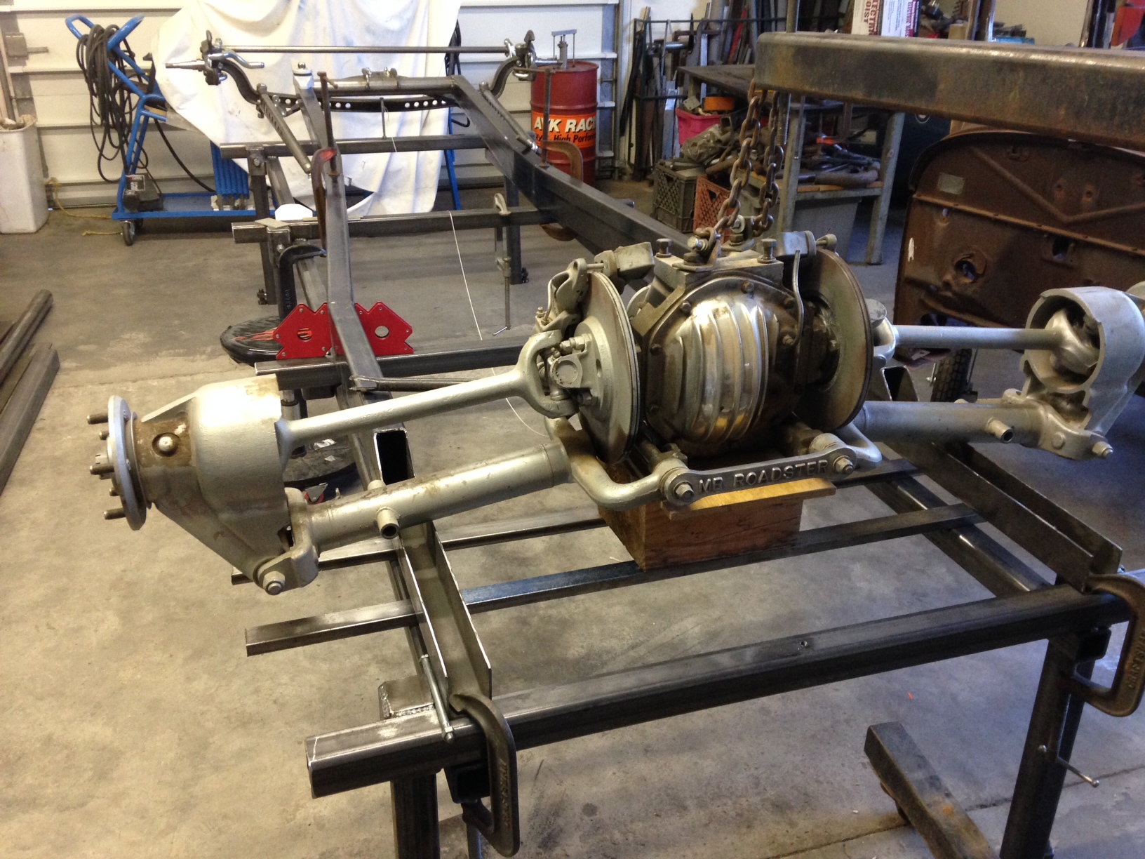

    I has been slow going on our project but some progress has been made with a chassis. Spent some time making a frame table so everything starts off square etc. We chose 2X5" X .120 wall square tubing for the rails. Built in a slight "Z" on the front and pinched the rails. No "Z" on the rear as the plan is for the rear axle to be mounted on top of the frame rails . The notches at the rear of the rails is for axle travel. 24.jpg
    We are going with a suicide style front axle, most of the parts coming from Speedway. We got it mocked up with adjustments for the castor at 7-9 or 11 degrees.
    23.jpg Front axle is a Super Bell with a 5' drop, Posie spring.
    Left the front end set for awhile waiting for more parts and began fabricating mounts for the rear axle. After taking some rough measurements it looks like we will need to widen the rear axles and arms about 2 inches per side for adequate body tire clearance. We didn't anticipate this but it shouldn't pose any major fab problems ! 22.jpg
    Will post more pix when we finish mounting the rear axle. The plan is to have a roller in the next week or so, time or other projects permitting
