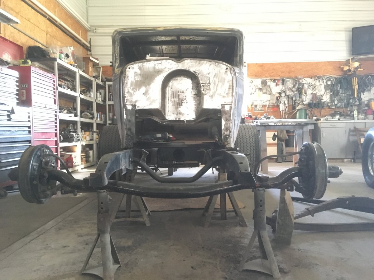

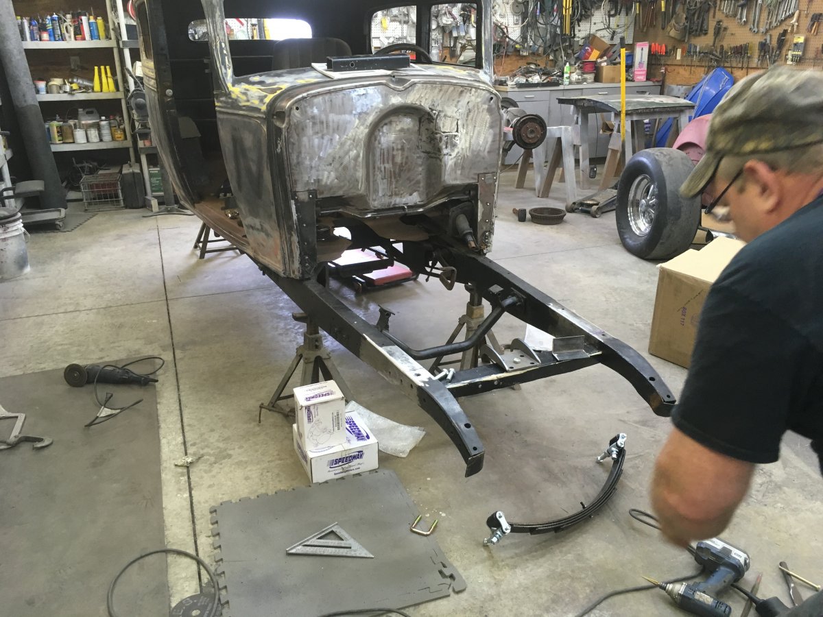

    Mine is obviously in need of some work....But a great start. My brothers have vowed to help and we have made some good headway so far. We started by ripping out that nasty MII front end and built a new cross member for a transverse spring front. IMG_0062.JPG IMG_0622.JPG

    Speedway 4" drop axle with disc brakes front, GM 10 bolt rear. Plan on installing a triangulated four link and coil overs soon. IMG_0623.JPG

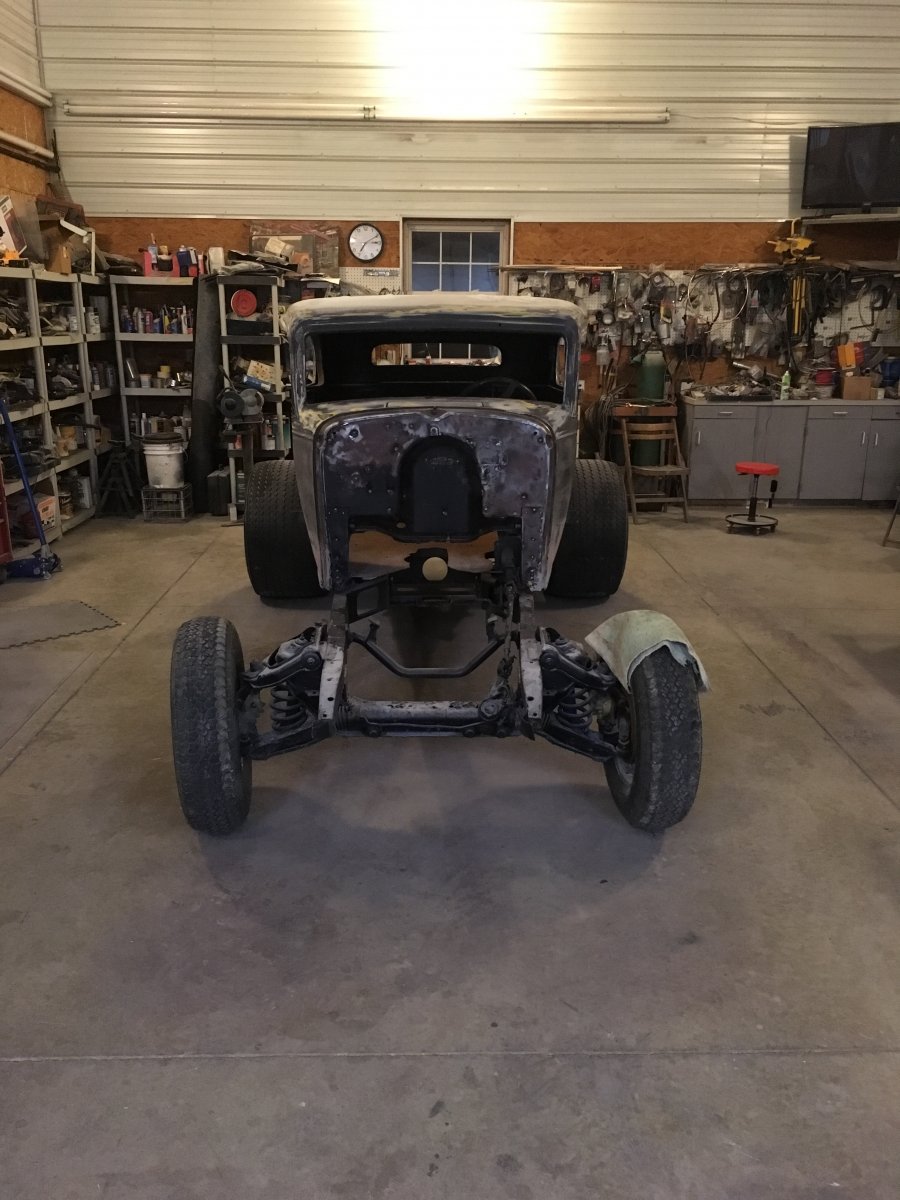

    I've analyzed about a gozillion pictures and I realize just how important stance is. I found some craigslist specials for $300 and will see how they work out. 205/60/15 fronts and 29/18.5/15 rears. IMG_0745.JPG IMG_0747.JPG
  6. Removing that independent front suspension is a great start! HRP

    Those rear tires are way, way too wide. Way out of proportion and will look odd.
    Gasser 57, RMONTY, chop job and 9 others like this.

  28. Nicholas Lyon
    Joined: May 19, 2017
    Posts: 21
    Nicholas Lyon
    Well, a few reasons I suppose. First of all if you recall it had a mustang II, and that obviously had to go. The original frame horns were gone that had the front spring hangers, no axle or springs. So I did have a couple other options laying around. One...
    Was this 30's Plymouth axle. We had plans to try to fab up some springs and place the axle on top. But not enough clearance, and I'd be stuck with drums. Plus the location of the front axle is placed too far back in my opinion. I love the look of hair pins, and with the spring behind setup it stretches the wheelbase a couple more inches and puts the c/L of the axle just in front of the c/L of the grill and enhances the stance In my opinion. I also have a 30's ford with wishbone, but want to have that dropped, surfaced, and drilled for future prospects.
    By the time I priced all the pieces and parts to get old stuff to work, it was more feasible for me to get a kit from speedway
    Bowtie Coupe likes this.
