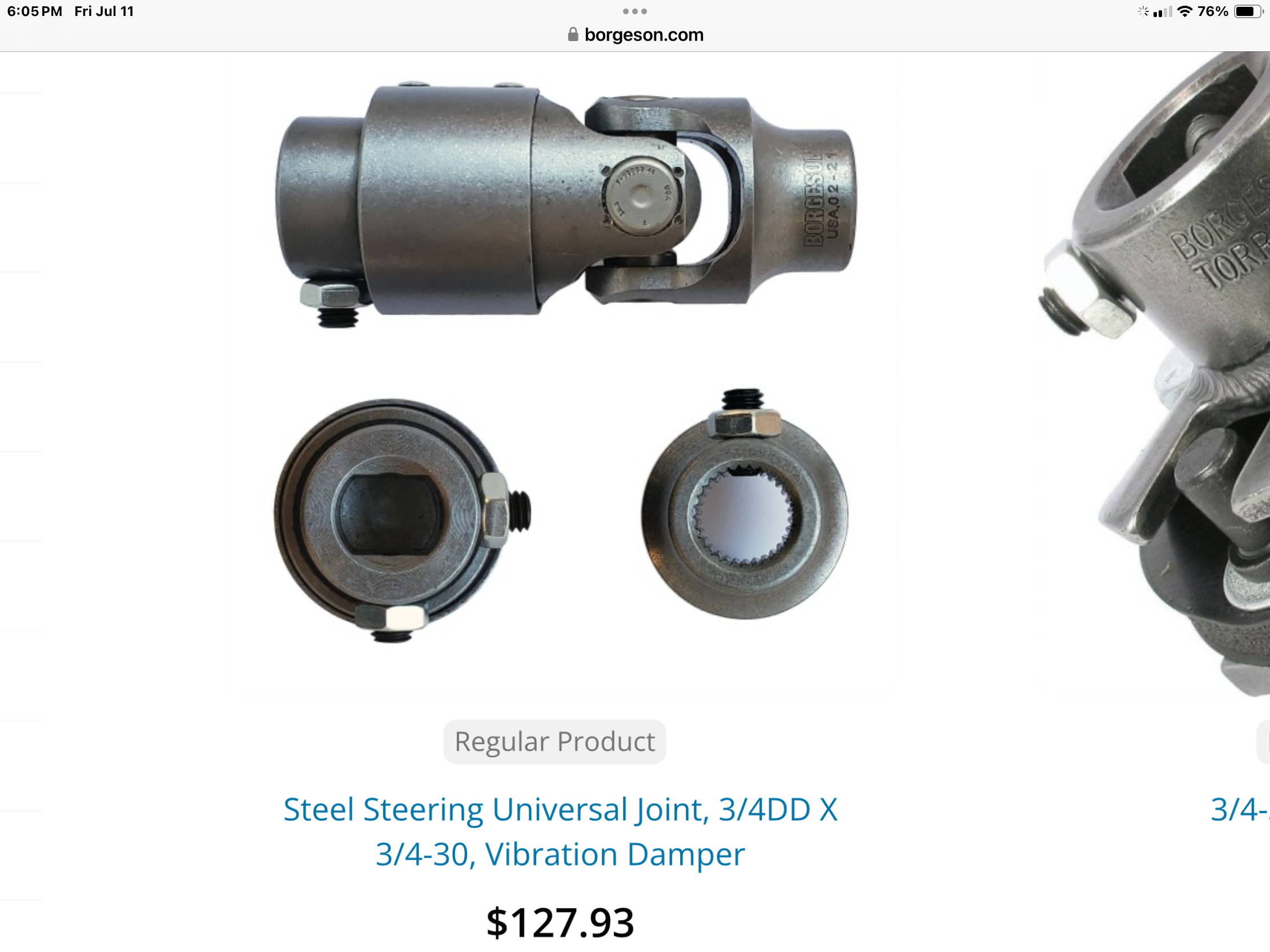

    Same set up as mine, I used a Bogensen stabilizer in the steering shaft IMG_8440.png

    That is neat. How's that work? Fluid filled? Rubber dampener? I take it there is nothing hard connecting the shaft to the box or another shaft?

    Rubber joint and It's in the same category as rag joints

    Absolutely, put it on when I built it 25 years ago. So I don’t know if it does anything, but my car handles like it should, no shimmy and the wheel feels good over bumps
