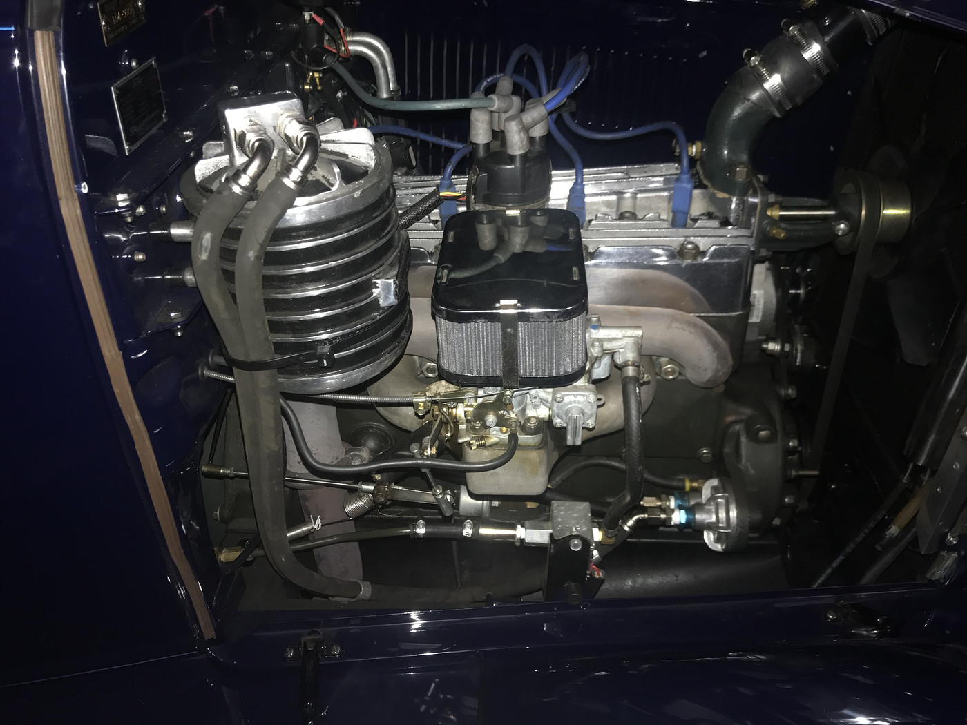

    On my Model A engine I have a police had, Tattersfield downdraft intake with a a1.JPG Stromberg 81 carb and a Clings adapter with a 39 trans.
