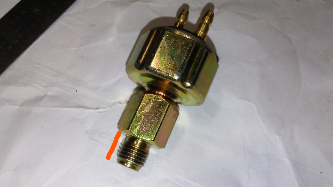

    Trying to locate a 1/8" NPT to 3/8"-24 IFM fitting with a threaded shank long enough to thread into an unused master cylinder port. Do they even exist? :confused:

    That is the one in my pic....and it's too short to seat.

    Doing the exact Same thing, I have the same speedway adapter and its too short. would love to find one that would work.

    Checked them....nope.
    Can't do that as it will encroach into the NPT portion of the fitting.
    There isn't one anywhere near me.
    Nope....fitting needs to seat on the inverted flare at the end of the fitting.
    Around 3/16" or so.
    Without getting all spaghetti, the only option I can see at this point is to drill out a port plug and braze a NPT fitting onto it, which seems a bit hokey to me. At this point it would seem there isn't a specific fitting, with a long enough threaded shank, to enable it to be used in an unused M/C port. I would think there must be a demand for one....there I go thinking again o_O

    Does this port in the master cylinder have a seat for the inverted flare?

    Checked all my HD catalogs and found #63609-72, but it is also too short...looks to be the same fitting as the one from Speedway. Russell has a #240-723 fitting, but it is too long. It's intended to be used with a banjo fitting.
    Yes, but it is located too deep to use the normal length threaded fitting without bottoming out on the shoulder of the adapter before seating.
    Thought of that, but am concerned there won't be sufficient thread engagement, as the fitting's threaded shank is so short to begin with, at only 1/4" of exposed threads. It may be the only solution to use this fitting though. Just concerned about stripped threads.
