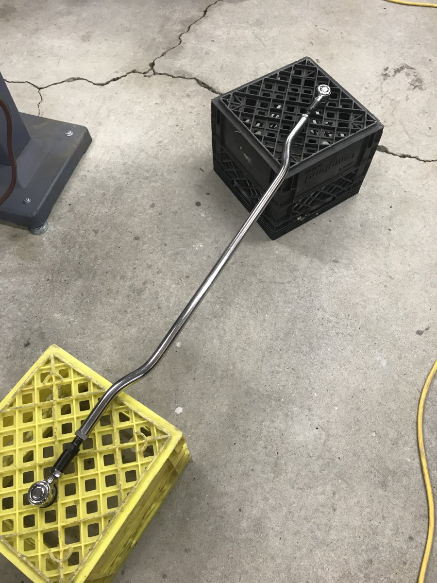

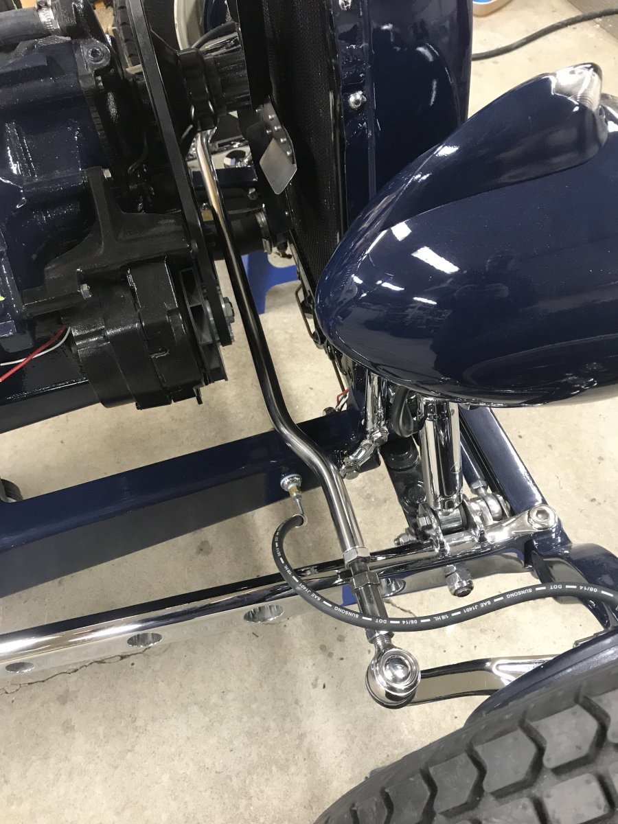

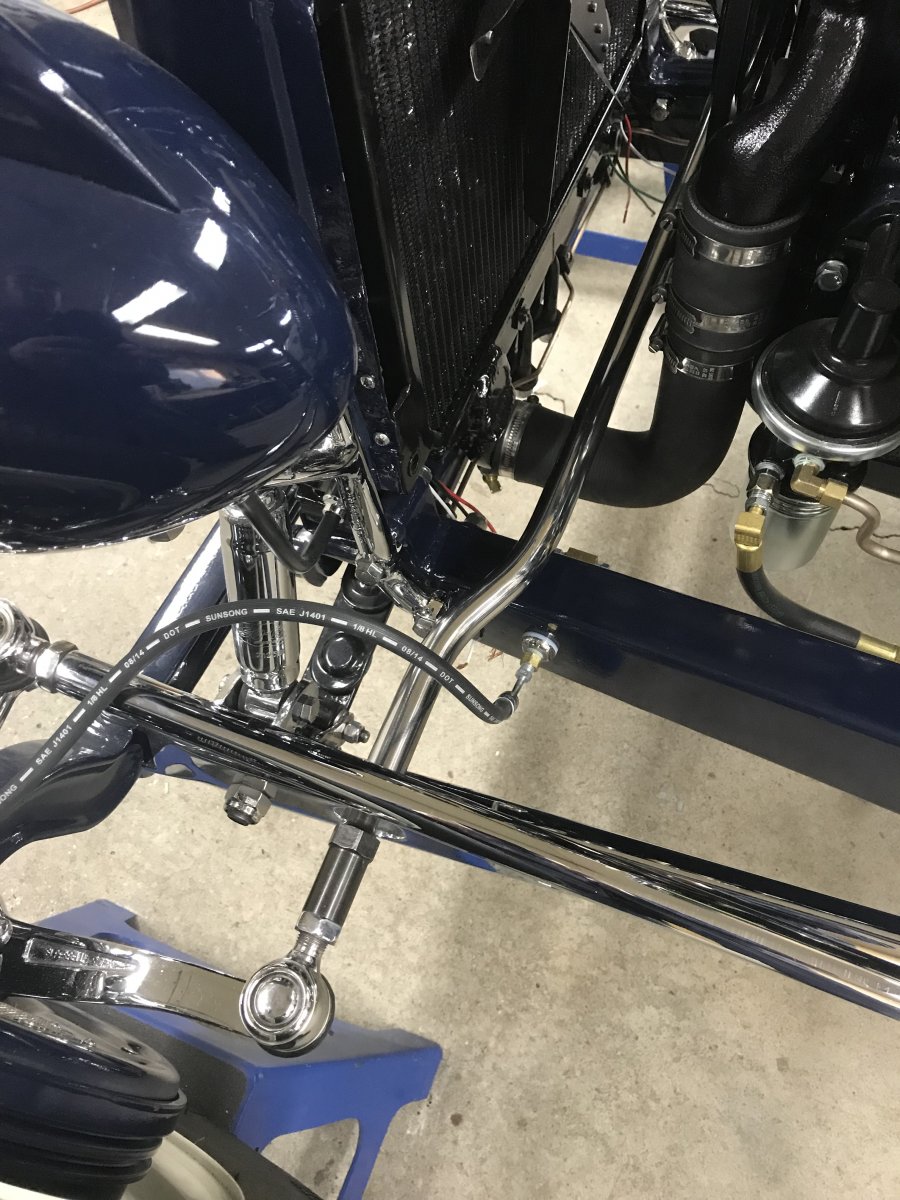

    Whatever you do, totally ignore the guys trying to tell you not to use stainless for a tie rod or for any other steering components.
    I made a custom offset tie rod for my RPU and it turned out great.

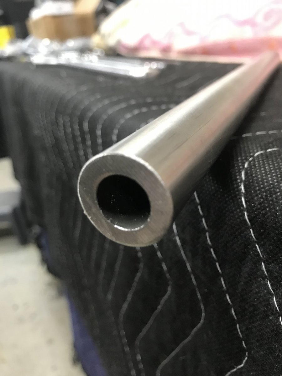

    I ordered a Stainless tie rod longer than I needed from Speedway motors and then cut it down.
    It was advertised as being Stainless Steel 7/8”x .156 wall tubing.
    I just measured the extra piece that was cut off and it’s actually 7/8” x .1875 , that’s a full 3/16” wall thickness.
    That’s really stout stuff.
    If you can’t find anything I can make you a 7” piece threaded the way you need if you don’t mind waiting for a few weeks.
    Larry.
