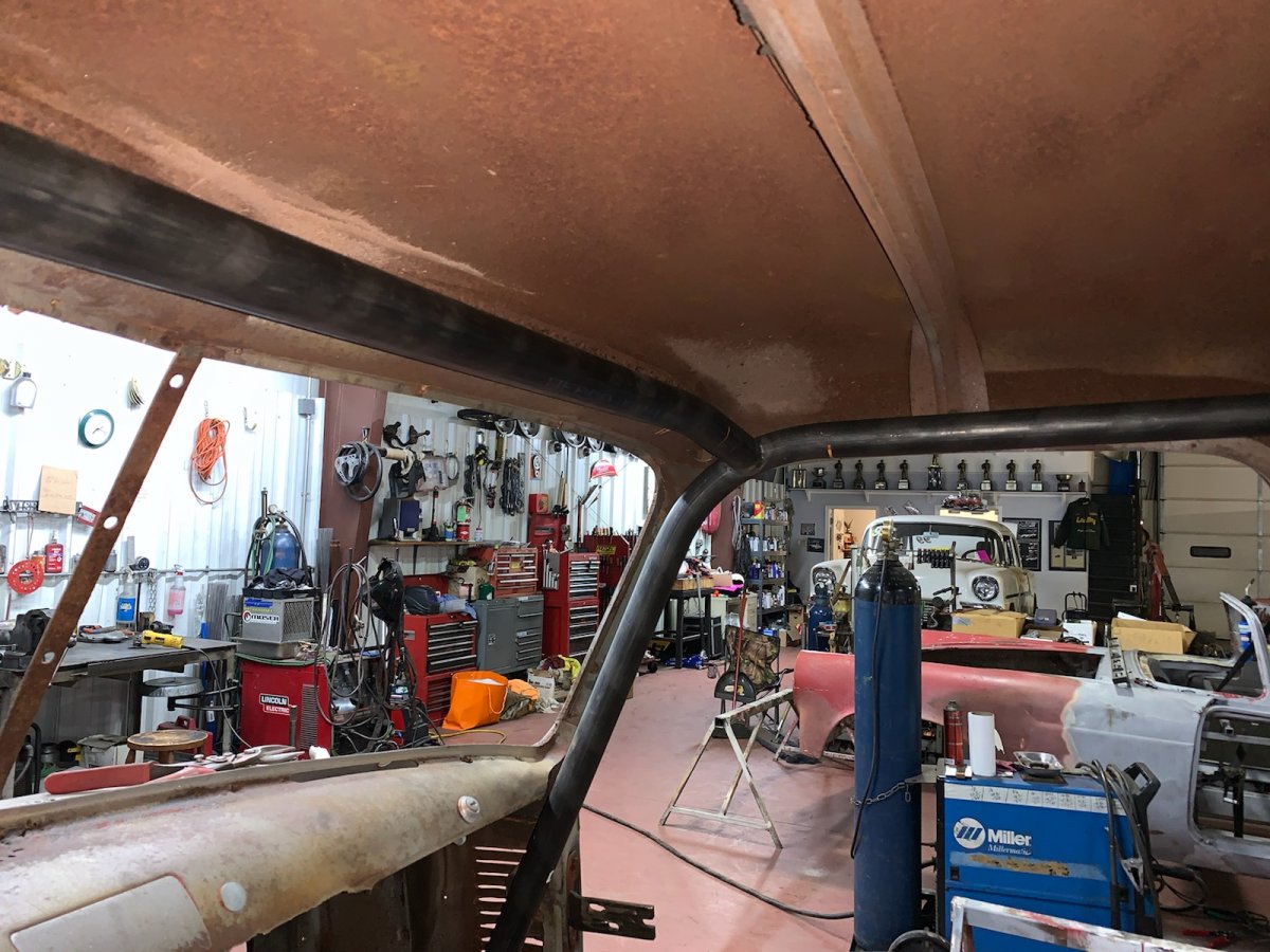

    I have to warn everybody this project is on a strict budget and I don't have a lot of time so don't laugh because your going to see a lot of things that are not built to my style. The roll cage is the next project and it's no exception. The bars in the next few pics were bent and installed in less than 3 hours. No pains were taken to make it fit good.
    The front p***enger out rigger for the a pillow bar.

    Rear outrigger for the main hoop.
    enloe, mad mikey, catdad49 and 4 others like this.

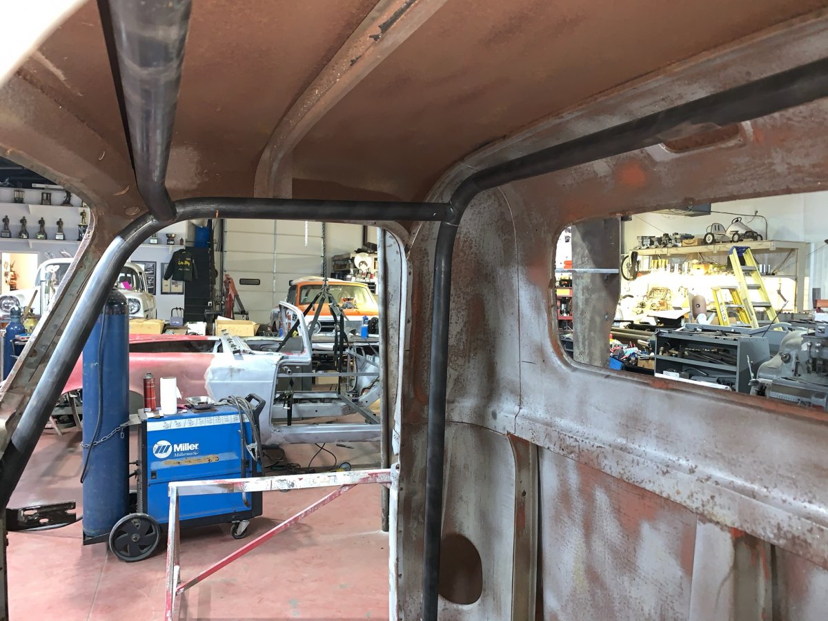

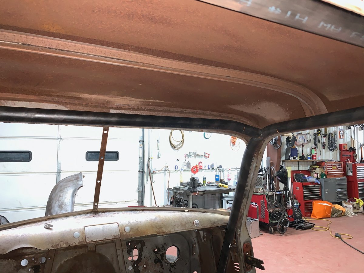

    Roll cage pics. Still a few bars and braces to add later.
    mad mikey, catdad49, loudbang and 8 others like this.

    I'm not quite sure what anyone else thinks, but I'd be happier than a ground hog in soft dirt to have a cage that nice in my heap! Especially in that short of time frame! I think you're being a tad too critical of yourself. :rolleyes: I have no doubt that EVERYTHING will be top notch when it's done. If you want to see Shoddy workmanship, let me at the pipe rack and the bender, I'll show 'ya how it's NOT supposed to look! LOL!!! :D:D:D Lookin' good Brother! I'll be watching 'till the bitter end! :cool::)
    enloe, catdad49, loudbang and 3 others like this.

    LOL the pics make it look better than it really looks. I am building it so the cab will come off so it had to fit a little loose for that to work. Thanks for following along.
    enloe, mad mikey, catdad49 and 5 others like this.
