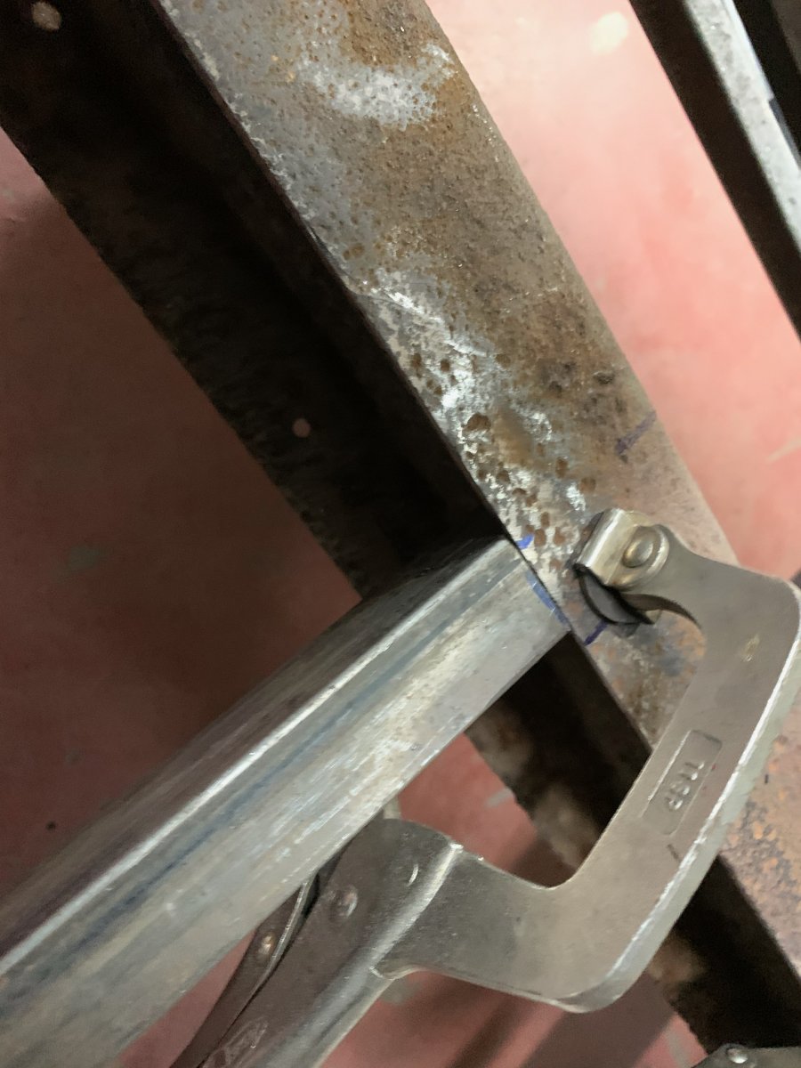

  6. Quain Stott
    Joined: Nov 21, 2006
    Posts: 2,068
    Quain Stott
    Today we worked on finishing up the engine mounts and mounting the v-drive. This pic is of the mid mount that I felt it needed.

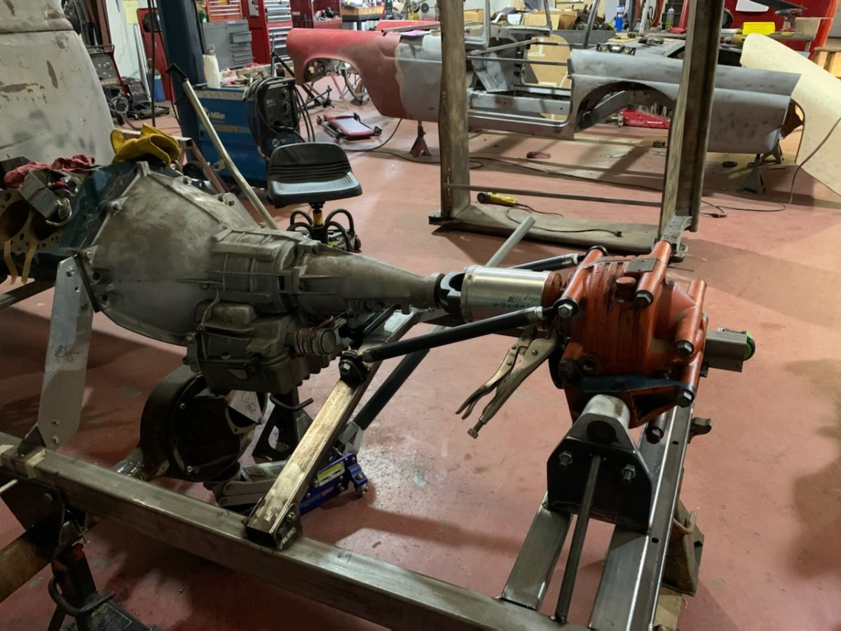

  7. Quain Stott
    Posts: 2,068
    Quain Stott
    Anyone that has followed my builds know how picky I am on drive line angle being perfect.
    99% of all drive shaft / u-joint failure is from a misaligned drive line angle, not horse power like most think. This wheel stander will really test ones knowledge on mounting the engine to get the drive line angle right. Plus it has two drive shafts that have to be tuned together. First step is to get the output shaft in perfect line with the input of the v-drive. We made a trick little fixture to do it as seen in the pics. It was bolted to a yoke then welded to a 4" aluminum bar then machined to a perfect fit for the register in the flange of the v-drive. The little notches are machined in the aluminium fixture so vise grips will fit in there to clamp it to the v-drive flange. When this is all finished each u-joint will have 1 degree angle.
    Keep in mind all of this had to be figured in before mounting the engine, transmission and rear end housing. Something that is over looked in most builds until it's to late.

  10. seb fontana
    Joined: Sep 1, 2005
    Posts: 9,111
    seb fontana
    from ct
    Did you machine 1° on ends of aluminum? Or going to adjust to the 1° with the turnbuckles..
    Quain Stott and loudbang like this.

    The jig is flat we will put the 1 degree in it with the turn buckles. I wouldn't put any angle in it but the u joint has to have angle to grease it's self.
