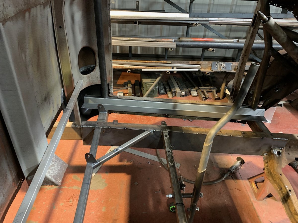

    I worked tonight on boxing the ch***is in the center of the truck. I used .090 mild steel plate (Donated By good friend Wayne Swafford) To make the box. Since I plan to wire weld it I didn't worry much about fitting it perfect. Here's two pics of the plates tacked in place. I plan to go a little farther forward with the boxing later. wheelie truck 5.jpg Wheelie truck.jpg

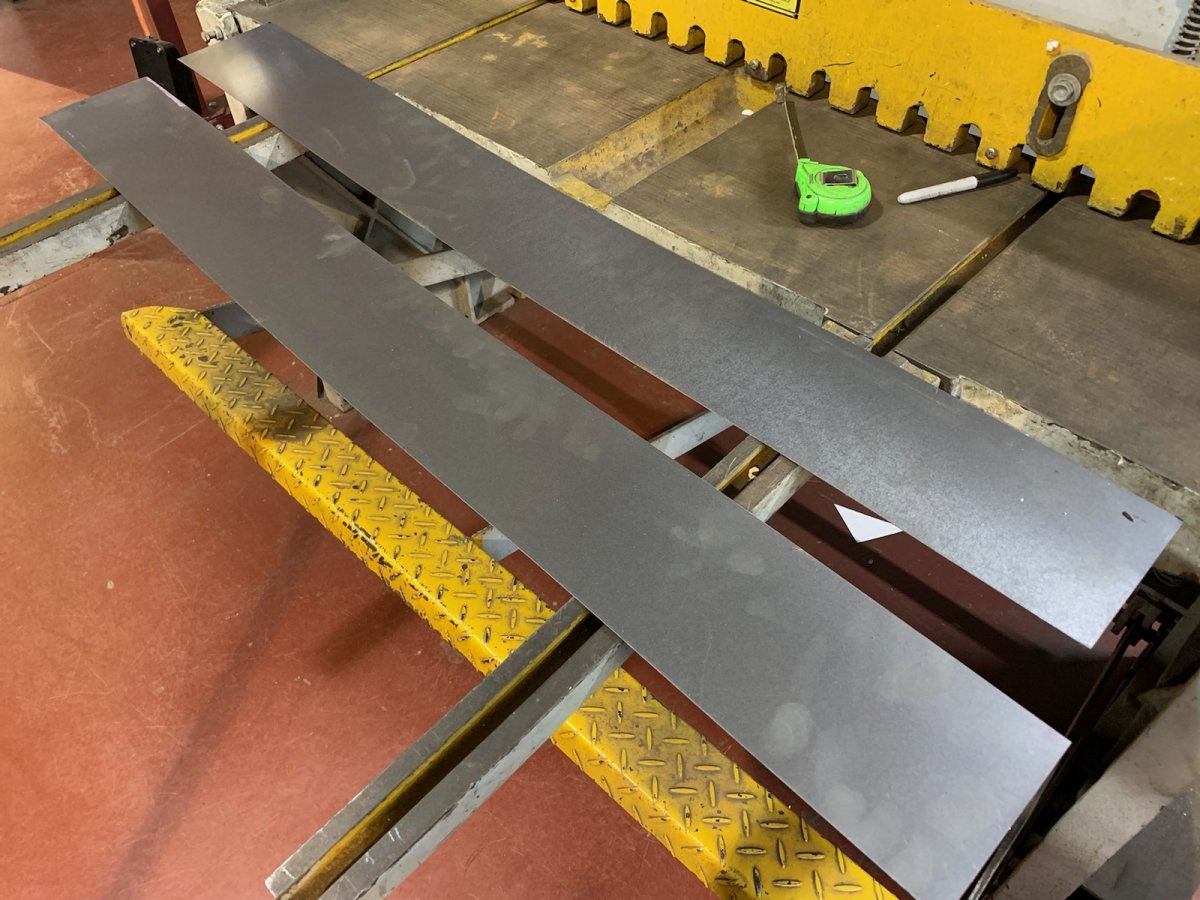

    Just 2 quick bends to offset the distance so the floor will set flat on the factory frame. IMG_1104.jpg IMG_1105.jpg IMG_1106.jpg

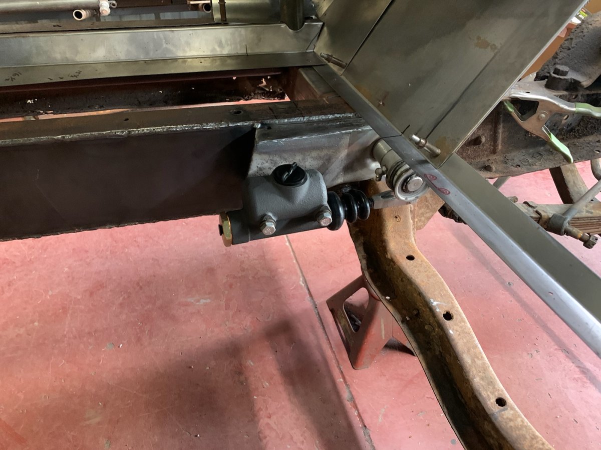

    Spent a few hours on the truck for the first time in several weeks.

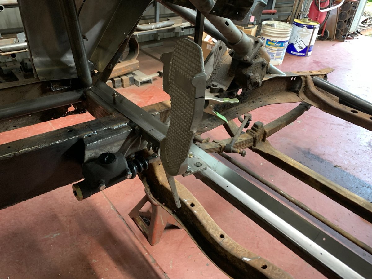

    Used the stock pedal and master cylinder mount but had to cut and weld it to the ch***is since boxing the ch***is closed of the original mounting holes. ws25.jpg

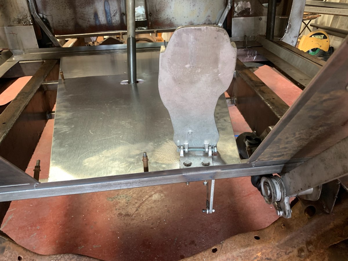

    Quain Stott

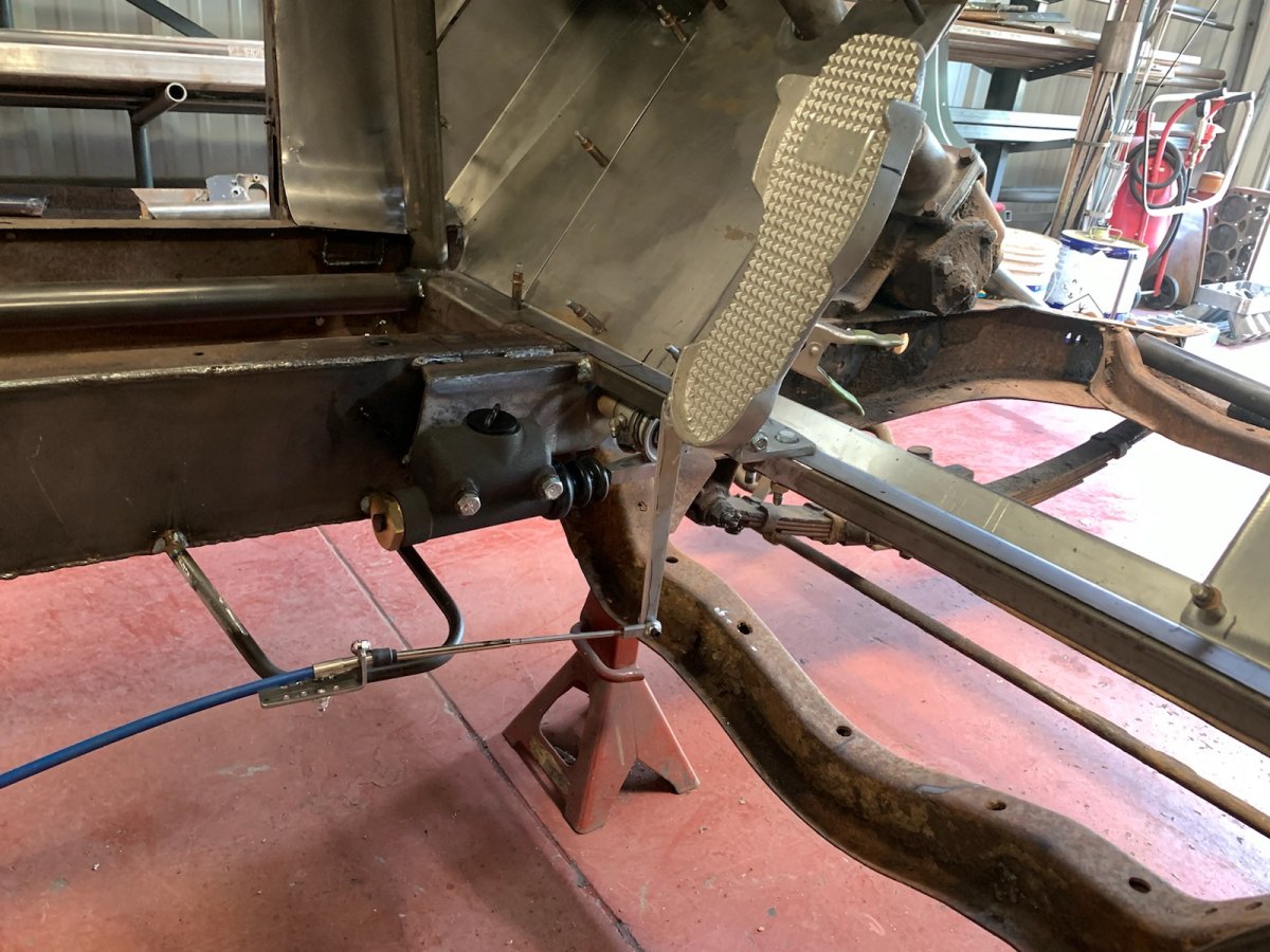

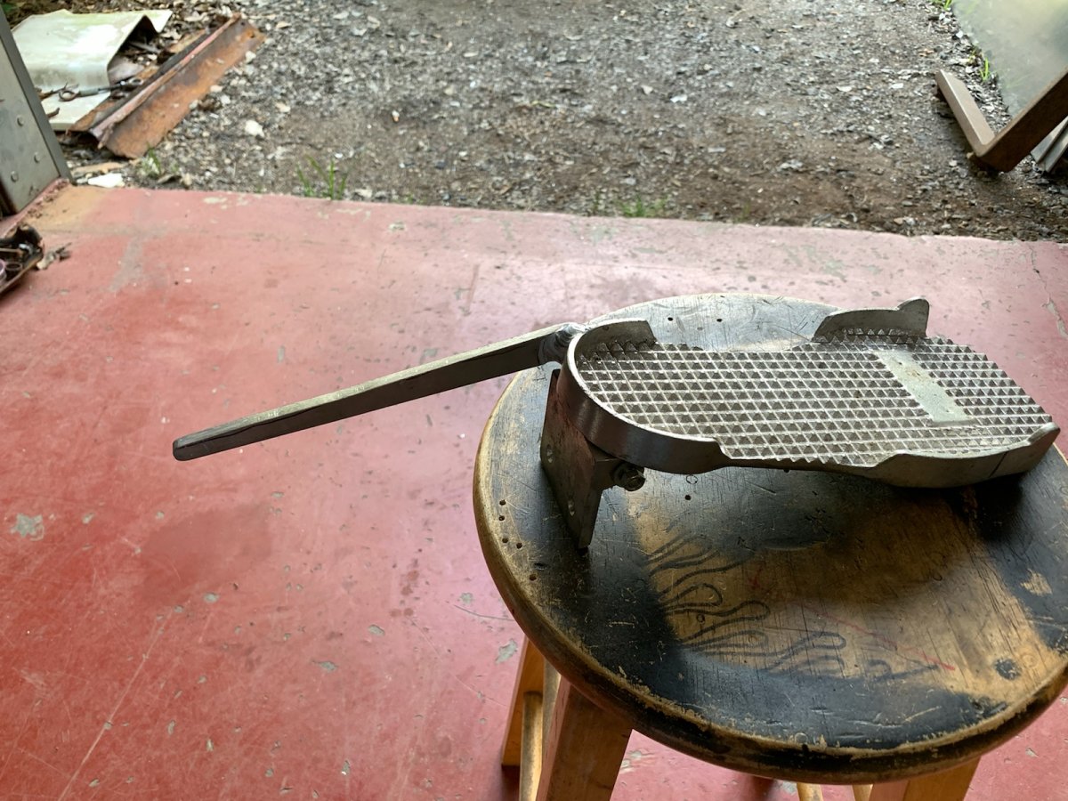

    Next on the list is the throttle pedal. Since the engine is in the back and I didn't want a bunch of cables running along the floor pans, I come up with a way to make everything under the floor. I took a replica of an old style foot petal and welded an arm on it to work a cable under the floor. I made it 1 to 1 ratio like all throttle petals should be. For good throttle control about 2.75 inches from idle to wide open is perfect. 2.75" is the travel most all carburetors have so 1 to 1 ratio on the petal will make it perfect. ws24.jpg
    enloe, loudbang, Thor1 and 2 others like this.
  18. Quain Stott
    Joined: Nov 21, 2006
    Posts: 2,068

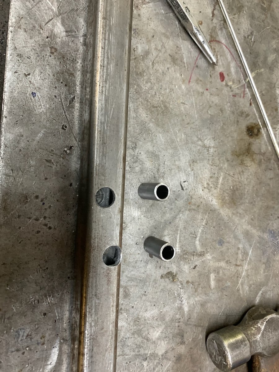

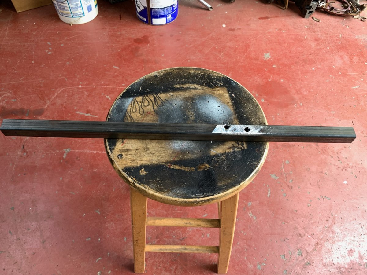

    Quain Stott

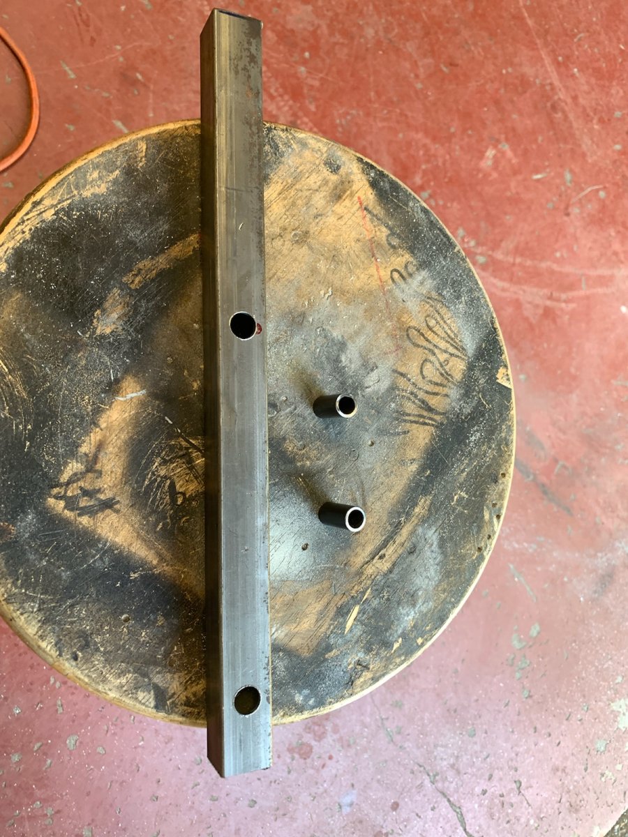

    Needing something to mount the petal to and also needing a brace where the fire wall meets the floor pan. I used thin wall 1" square tubing for the floor brace and welded in two bushings to keep the tubing from collapsing where the petal will mount to it. ws23.jpg ws22.jpg View attachment 4744869 View attachment 4744870
  19. Quain Stott
    Posts: 2,068
    Quain Stott

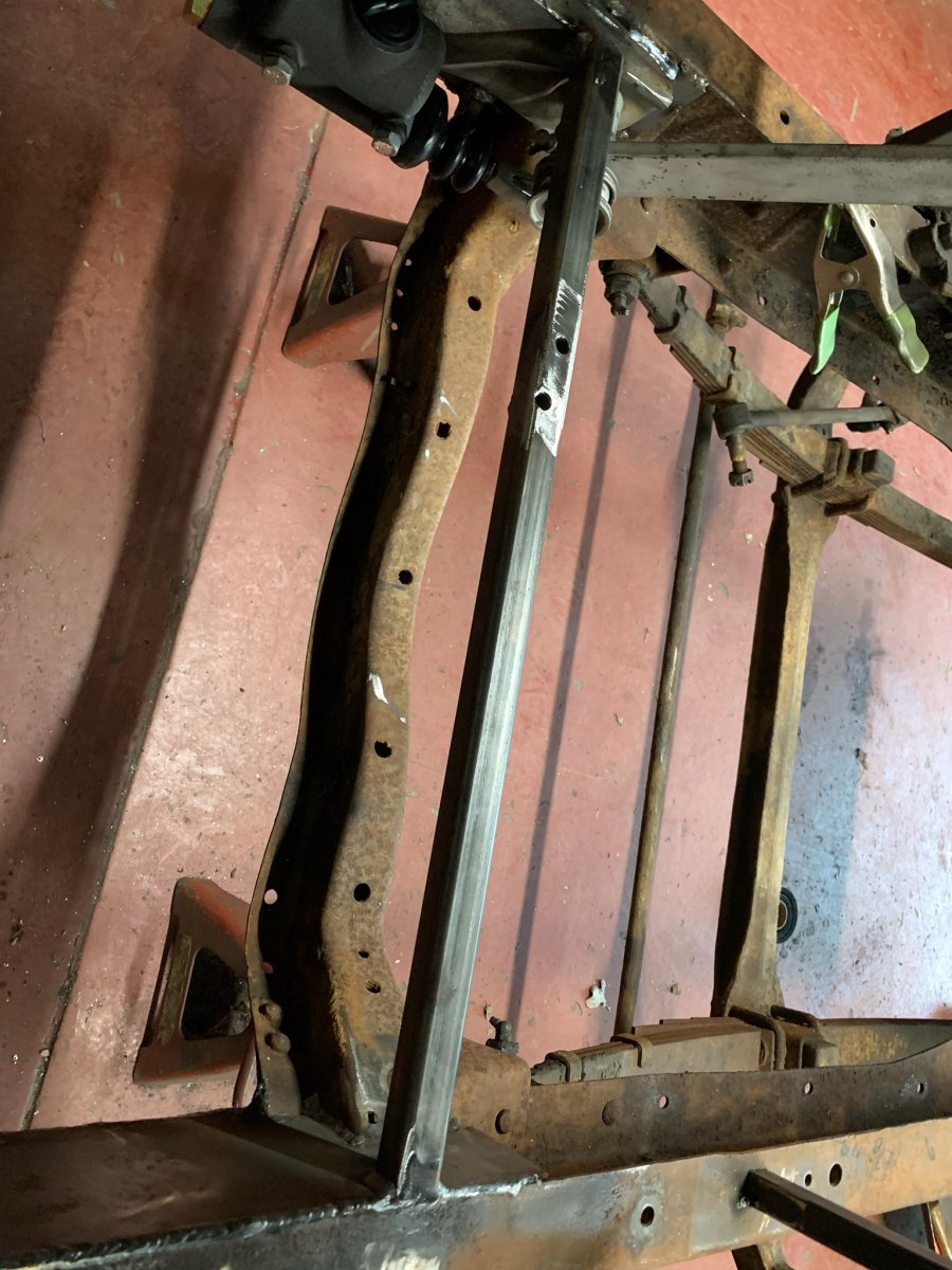

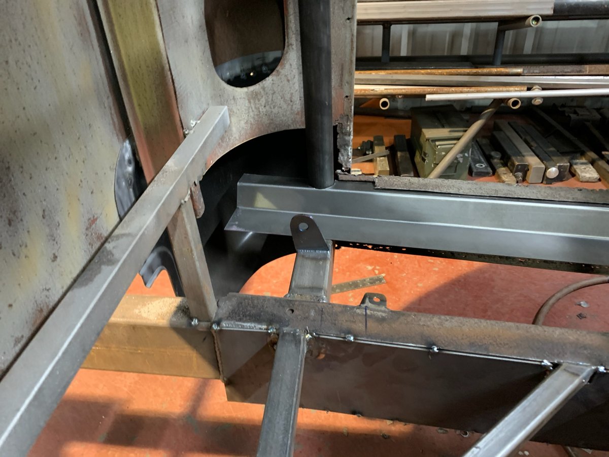

  20. Quain Stott
    Posts: 2,068
    Quain Stott
    The pedal in place with the angle sheet metal where the floor and fire wall will meet mounted under the pedal. This pic will start to give an idea how this mess will work when finished. ws19.jpg

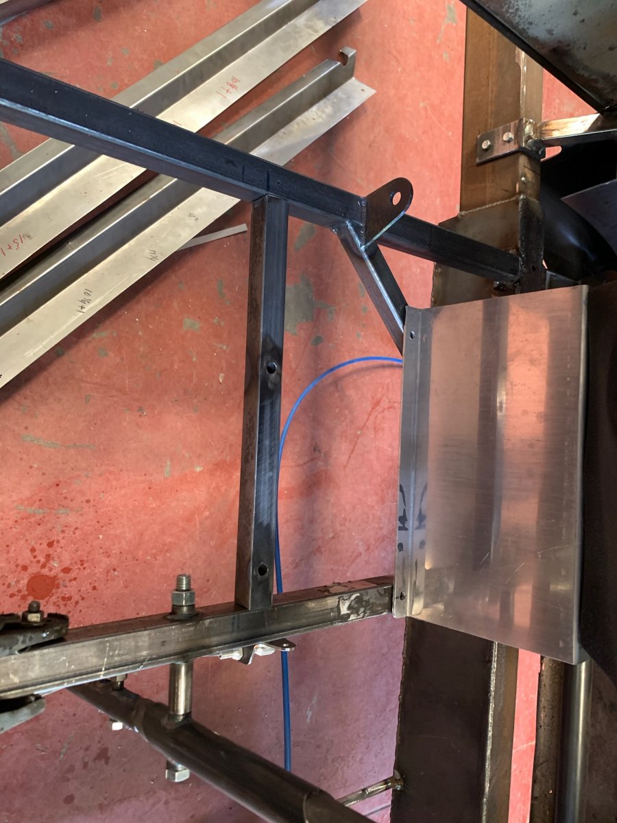

    Quain Stott

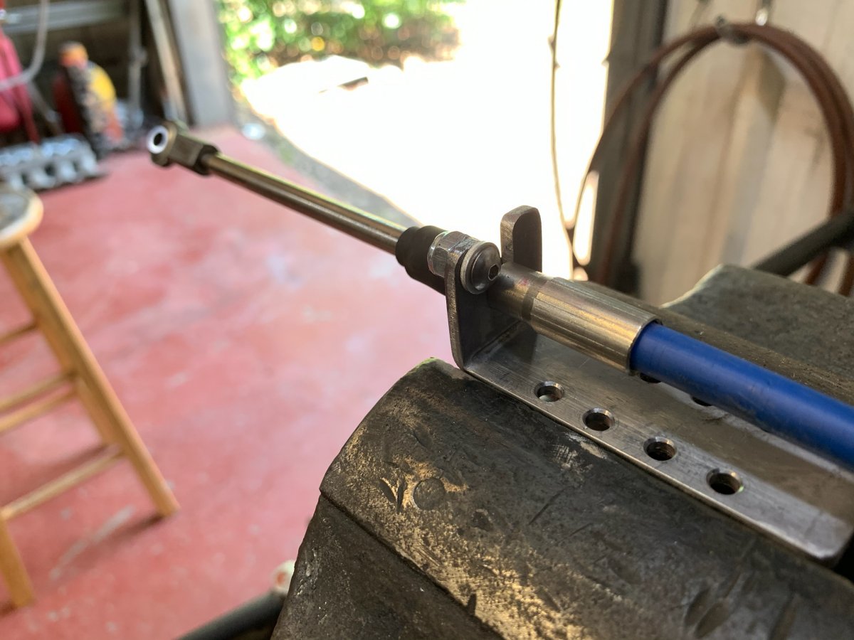

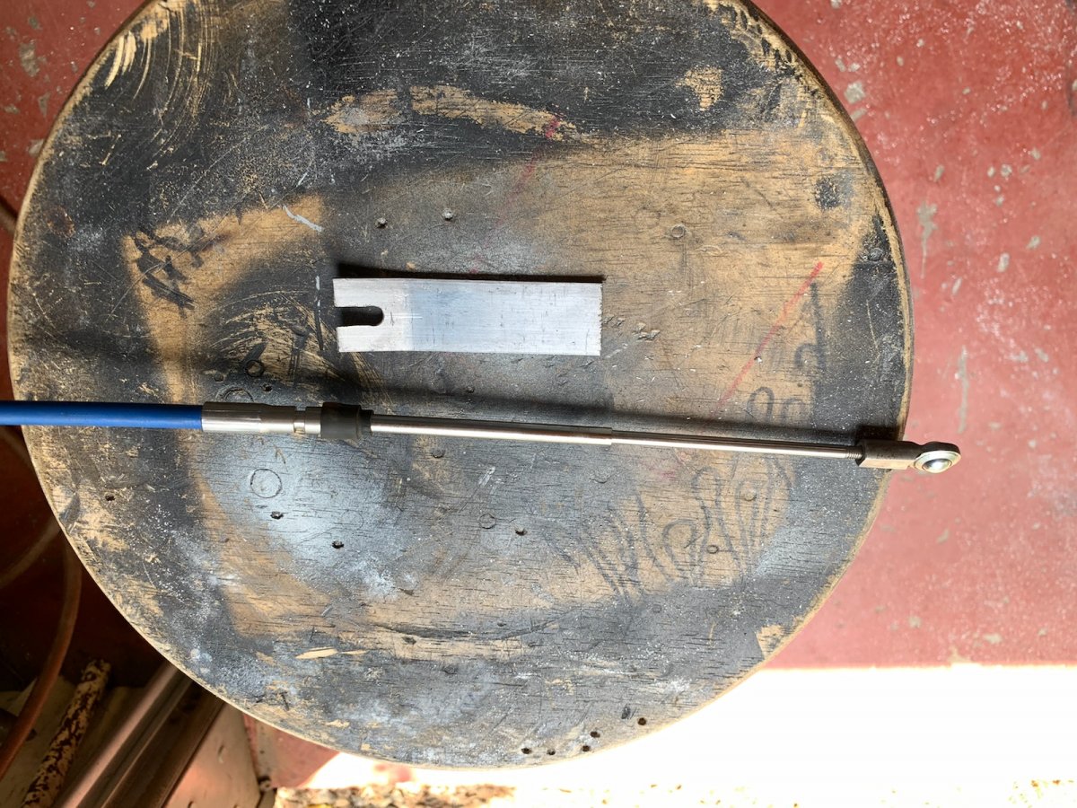

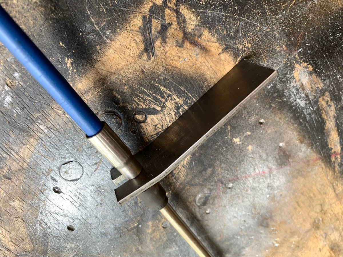

    Next is a mount for the Morse throttle cable. The little mounts cost about $5 but I didn't have one so I had to spend 30 minutes making one because I didn't want to order one and have to wait. ws18.jpg ws17.jpg ws16.jpg

    Quain Stott

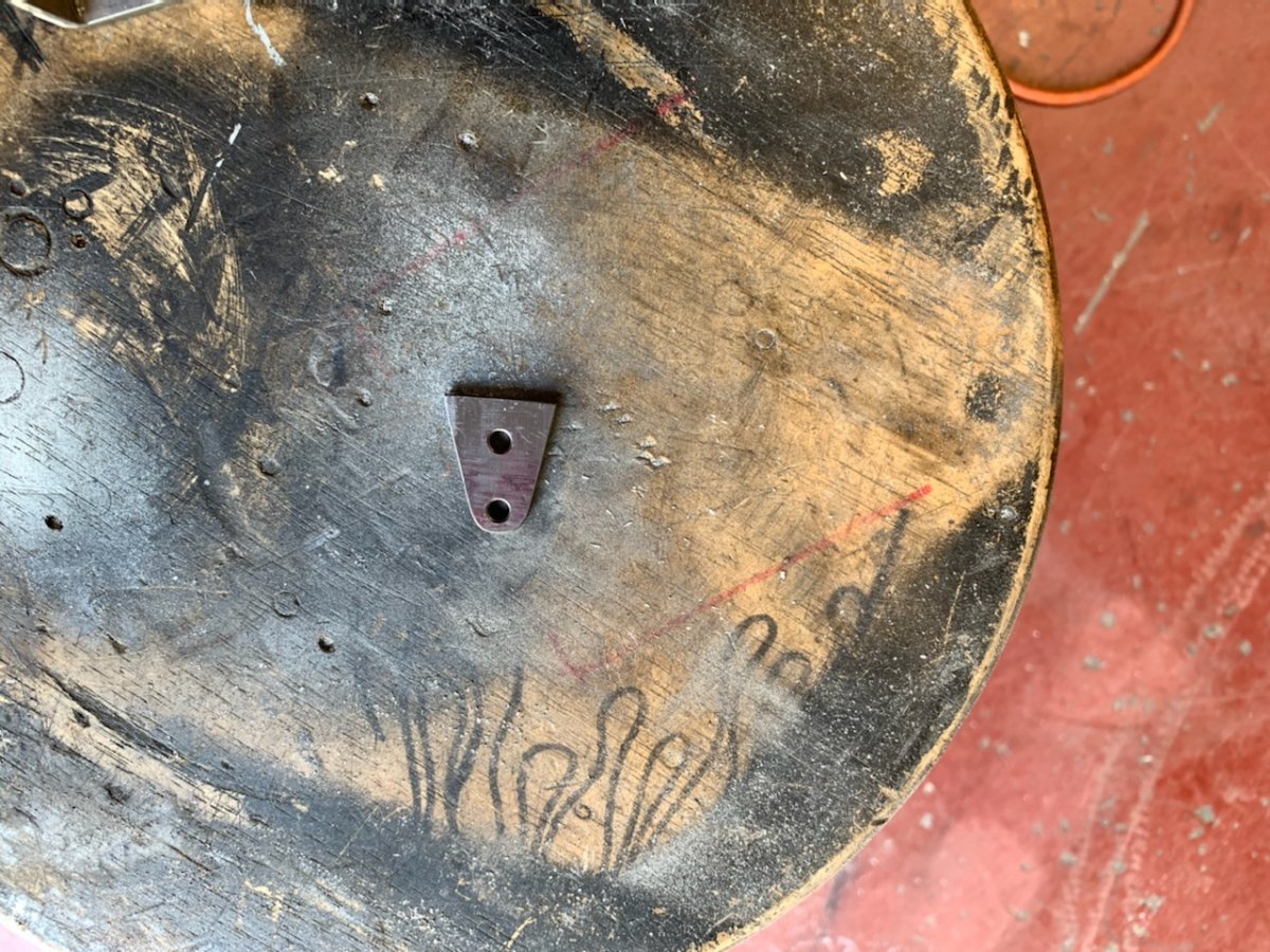

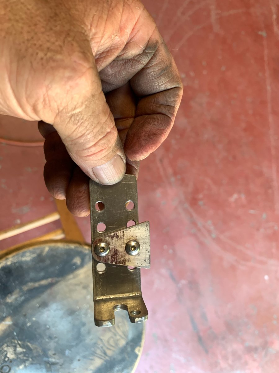

    I made a small bracket to bolt to the home made cable mount so it would be adjustable. ws13.jpg ws15.jpg

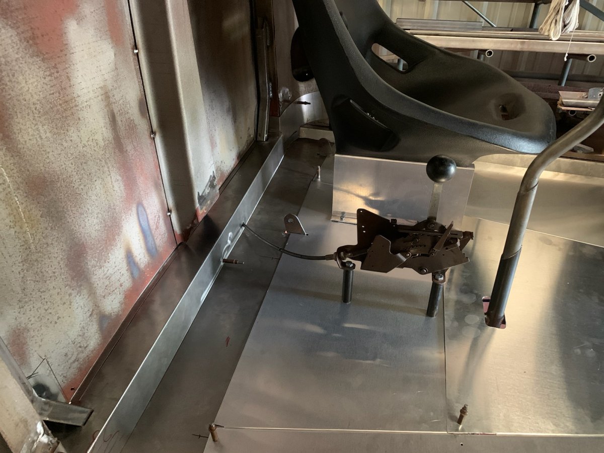

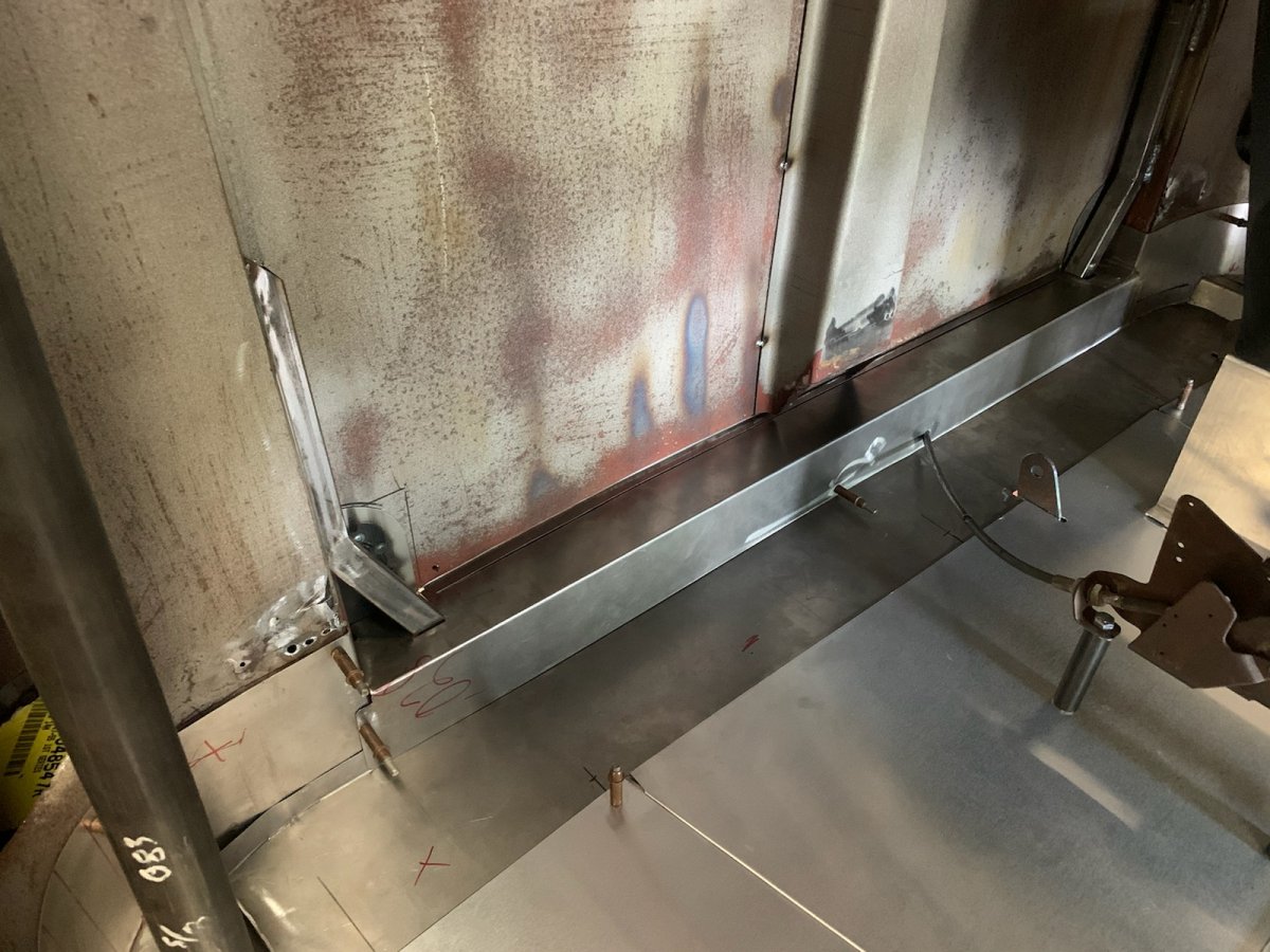

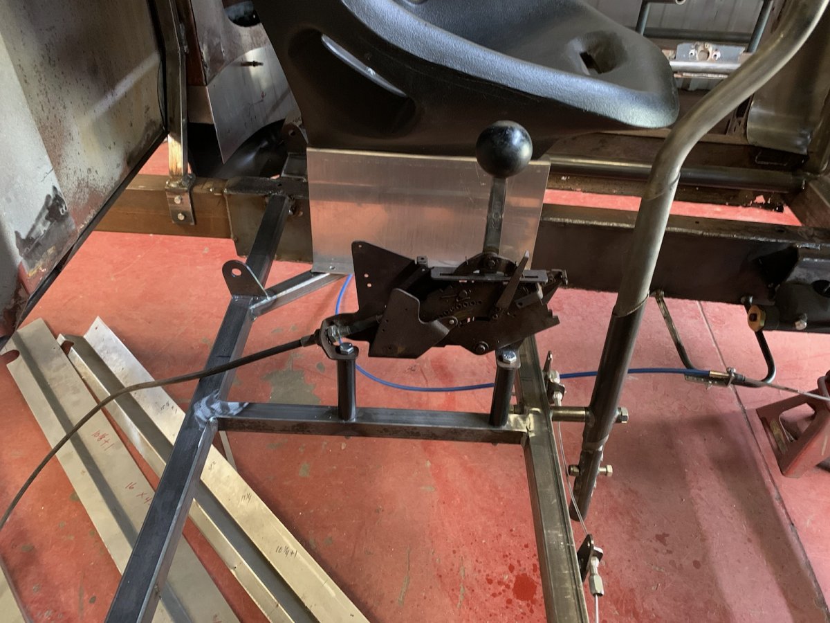

    Next on the list is the shifter mount. It really ****s to have to use an automatic in this project but I would have to have 3 arms to use the turn brake and shift a 4 speed while it's in the air.
    Same deal as the throttle mount, a thin piece of 1" tubing with bushings welded in for a mount. I did find an old school B&M shifter but it will need to be rebuilt. It's in bad shape from being out in the weather but no way was I going to ruin this project with a modern shifter so I will put forth the effort rebuild this one. ws11.jpg ws10.jpg ws9.jpg

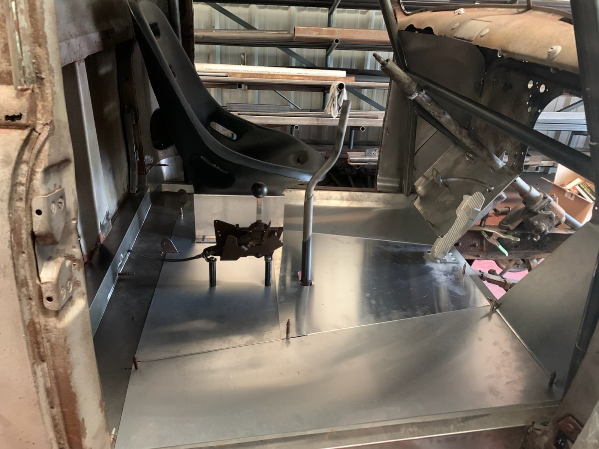

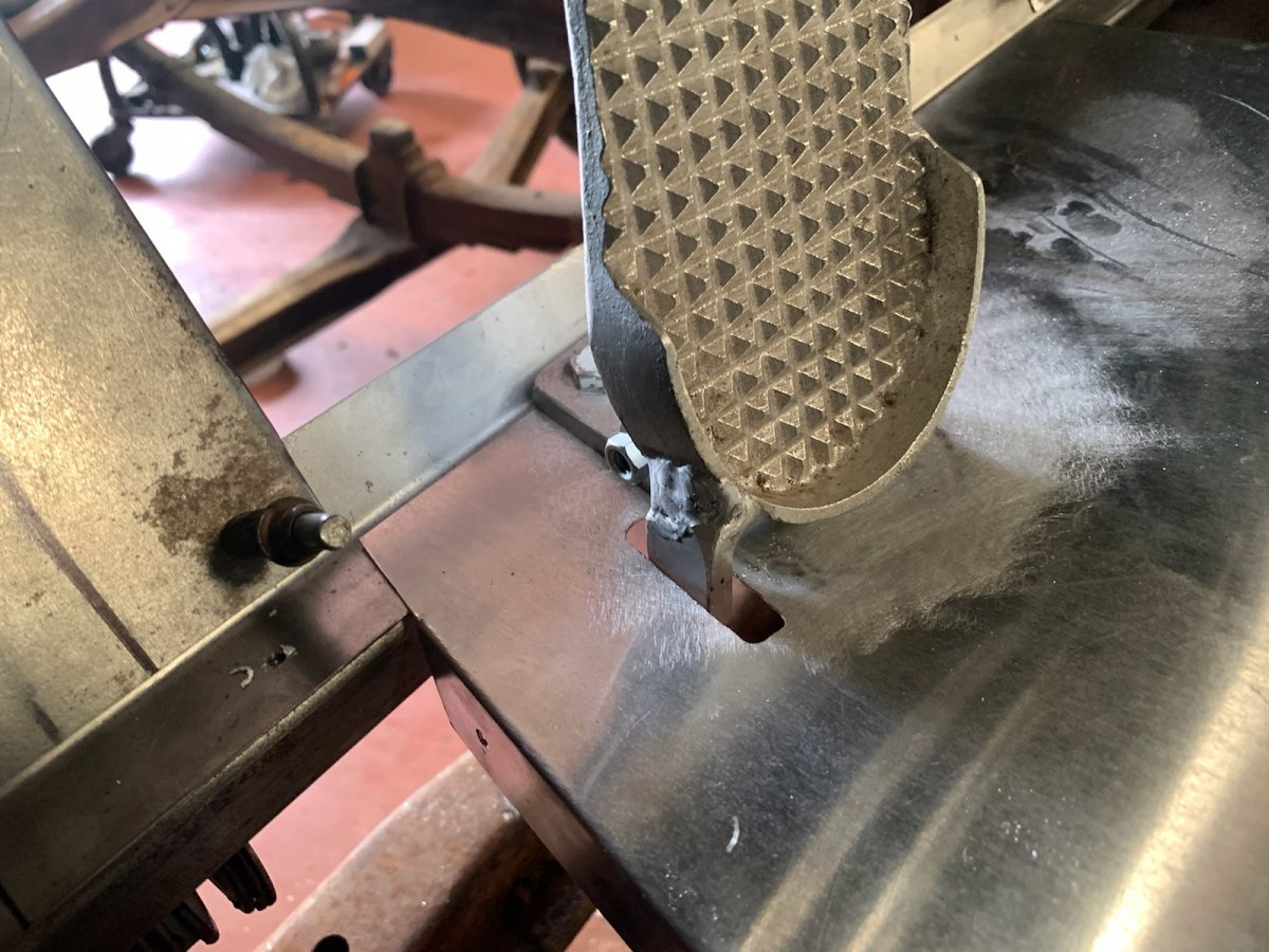

  25. Quain Stott
    Posts: 2,068
    Quain Stott

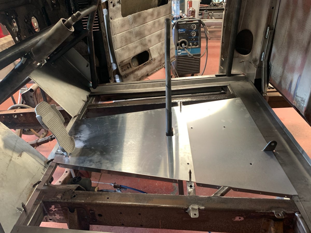

    Now time for the aluminum floor panels. A hole had to be cut in the center piece for the throttle arm to go down through. Also I had to hammer form a little low spot right under the pedal because it was rubbing there and could hang the throttle. ws8.jpg ws7.jpg
  26. Quain Stott
    Posts: 2,068
    Quain Stott

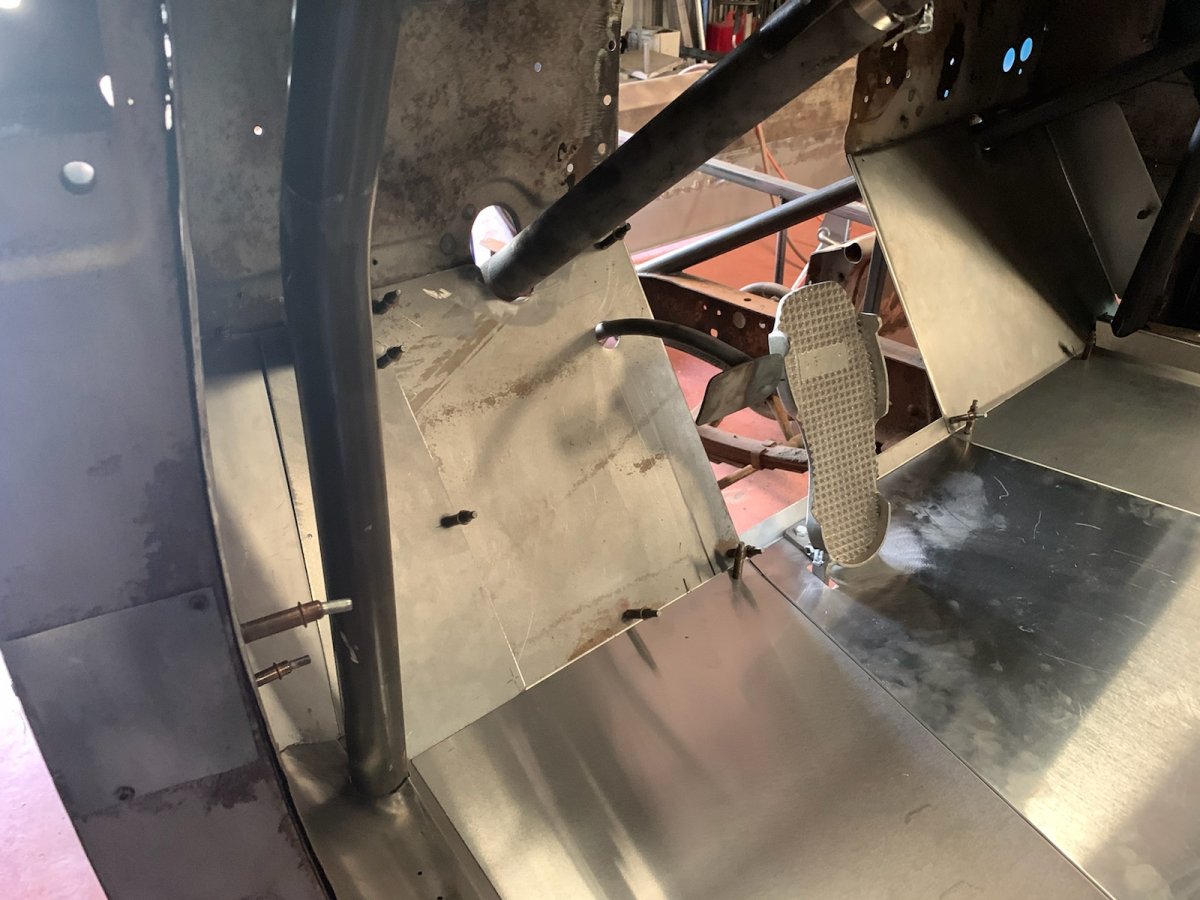

    The aluminum floor pans are pretty much roughed in so y'all can get an idea of how it's going to look on the inside in these last few pics for the night.
    Not sure when I will get time to work on it again but hope it's not long, I want to debut it before the 2020 race season is over. ws6.jpg ws1.jpg ws2.jpg ws3.jpg ws4.jpg ws5.jpg
