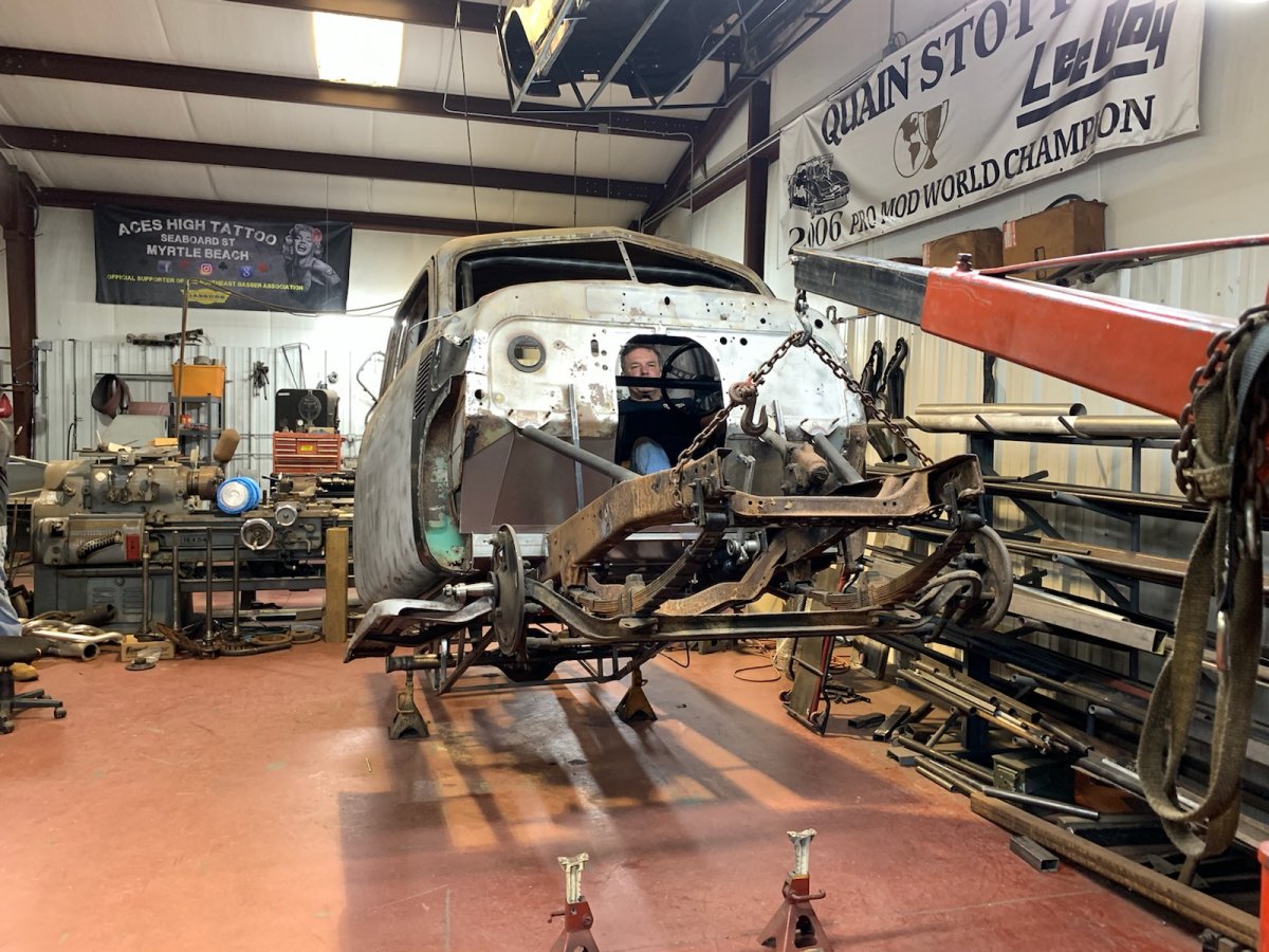

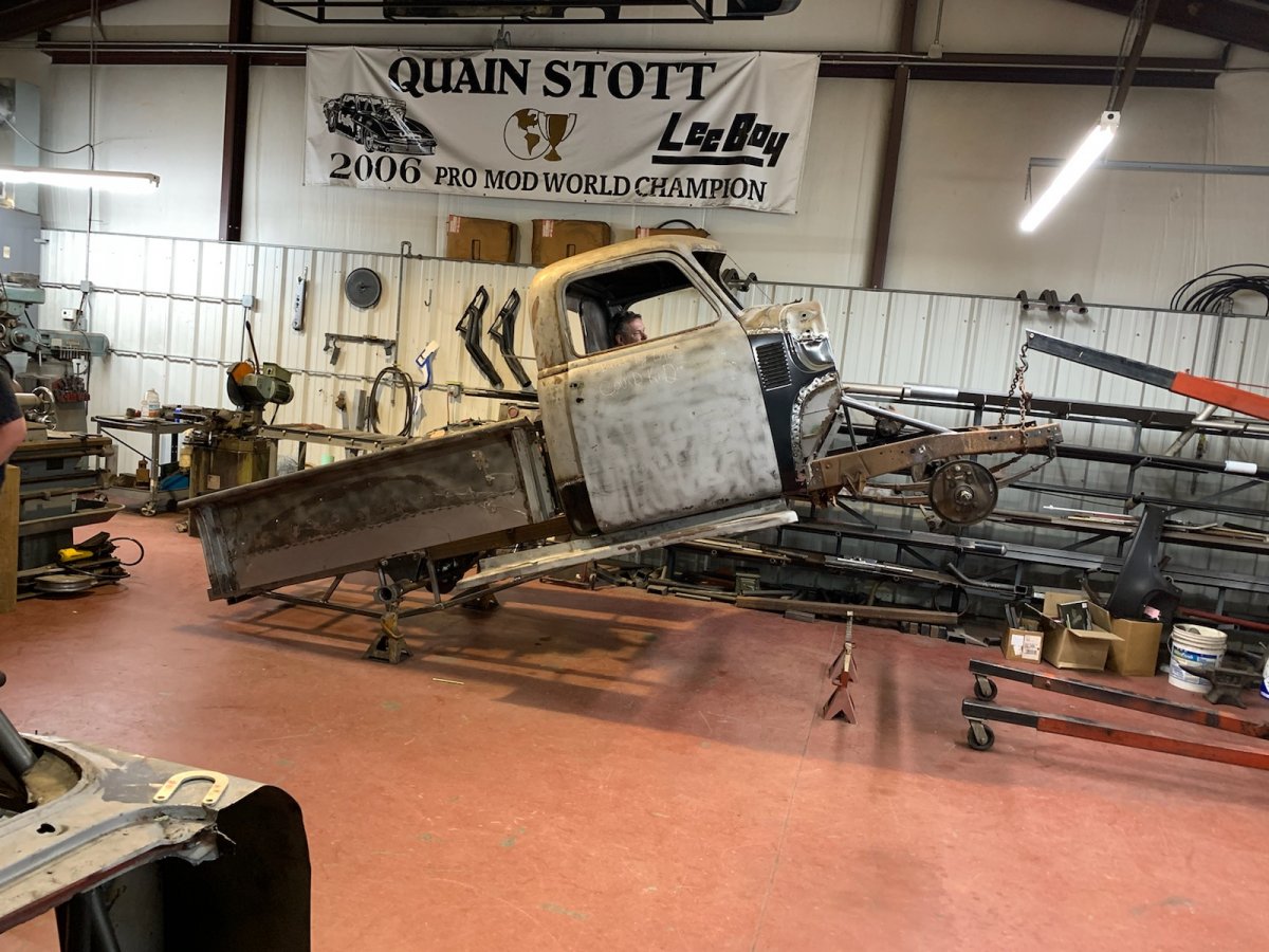

    We decided to have a little fun and pick the front end up to about where it will go the full 1/8 or 1/4 mile. While up it was a good time to see exactly where the window will need to be so the driver can see where he's going. 7-22 8.jpg 7-22 7.jpg 7-22 5.jpg 7-22 4.jpg

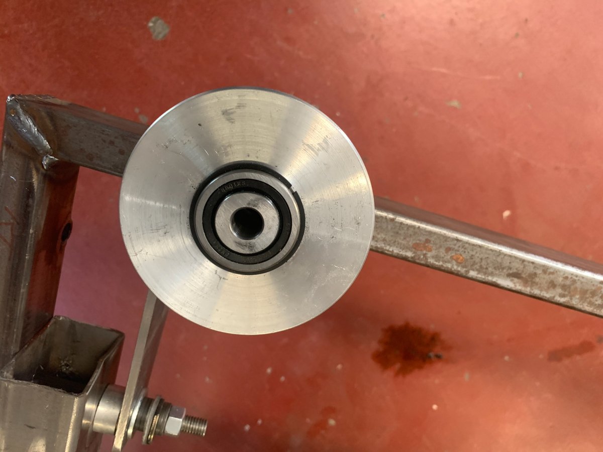

    Next step is to make the wheelie bar. We couldn't find what we wanted for wheels so we just made them. They are fitted with really good sealed bearings because it will be riding on them for a long time. IMG_1449.jpg IMG_1615 (1).jpg IMG_1616.jpg

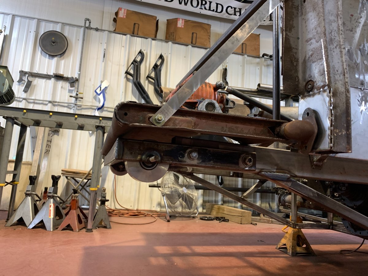

    Welded inserts in the rear of the chassis to bolt 1" X 2" .125 wall tubing for the main support for the wheelie bar. IMG_1431.jpg

    The two tied together with the same size tubing and a 3/16 plate on the inside of the wheel for more strength. Might be an over kill but we figure this needs to be strong. IMG_1618.jpg

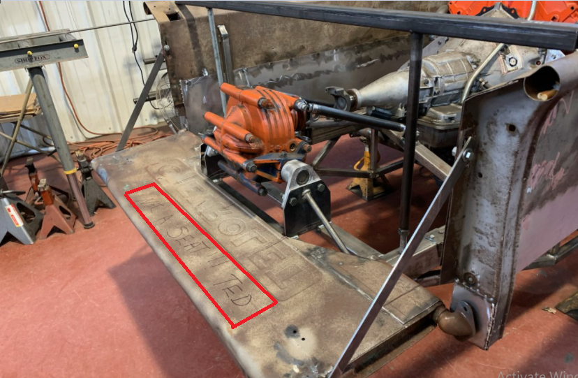

  7. Quain Stott
    Joined: Nov 21, 2006
    Posts: 2,068
    Quain Stott

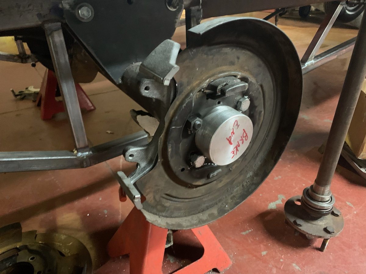

    Made an aluminum jig to center the brake caliper bracket so it could be marked for the new bolt pattern of the old style housing ends. wheelie truck 16.jpg
