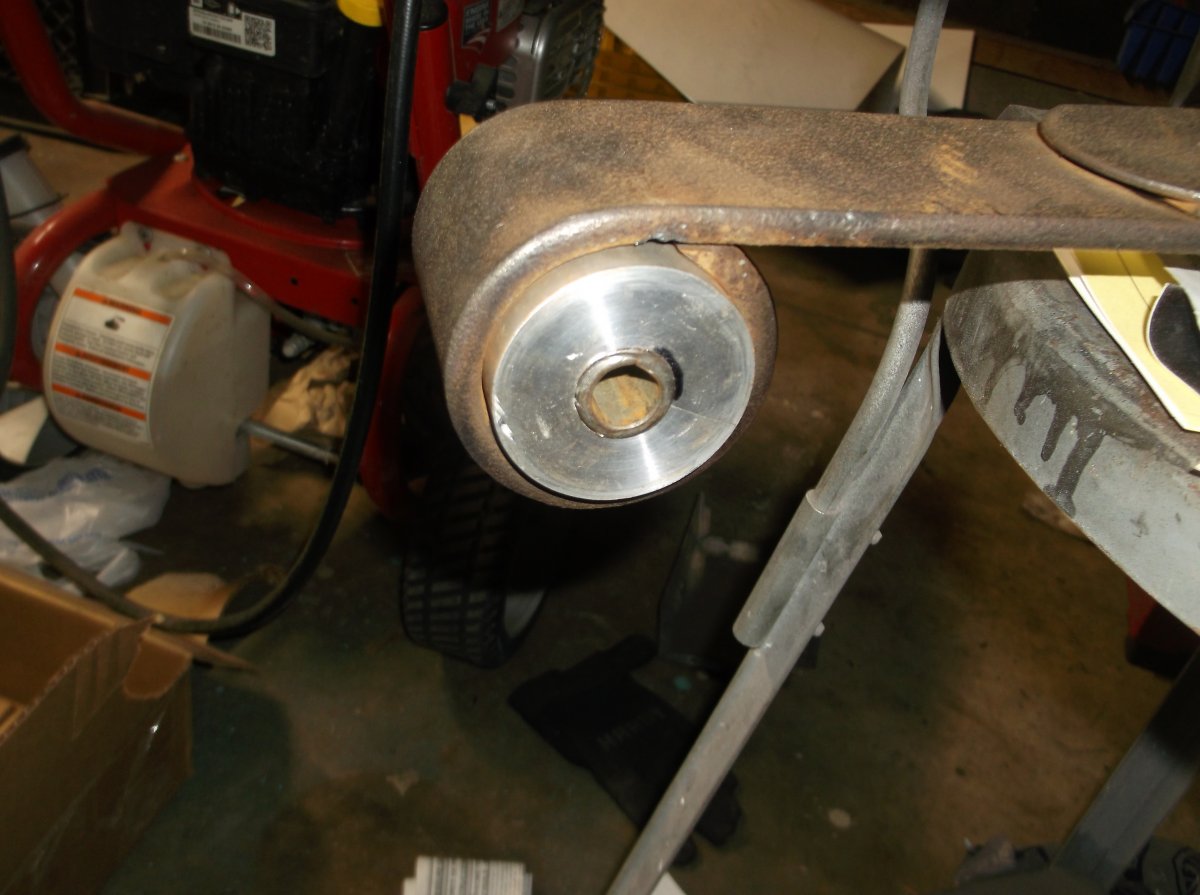

    Got some more done last night . I went to a friends house and he used his lathe to square up and bore out my aluminum bushings for my front spring eyes. He left an interference fit so I could bring them home and heat them up with my propane torch and press them in. It worked out well and for 5 bucks and some time I have my solid bushings. DSCF3703.JPG DSCF3704.JPG

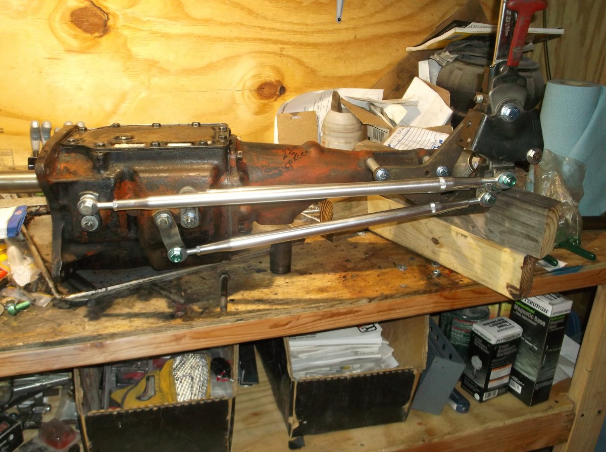

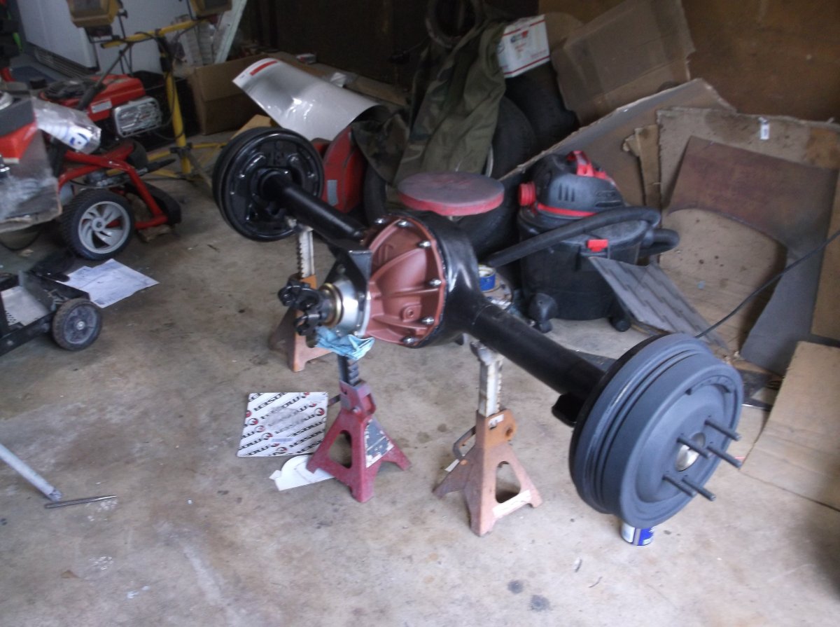

    Got some done today. got my shifter linkage done except to swap out some of the bolts with button head bolts for clearance .
    I have the rear end all assembled and ready to install. Trying to get something done between rain storms .The bracket on the pinion support is for the pinion snubber . As soon as I get the rear end in and the u-bolt bracket made I can make the adjustable pinion snubber. DSCF3707.JPG DSCF3710.JPG

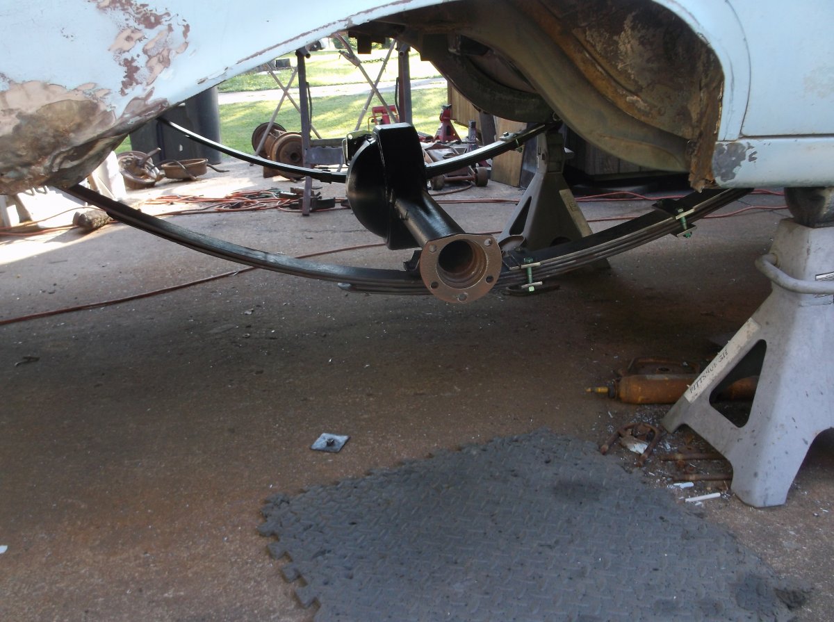

    Rear end look'in good! NO clamps in the back.........just the front of the spring.
    Let that rear half be loose and "work-for-you"!

    DSCF3714.JPG In between rain storms this afternoon my wife and I got the rear end in the car. I got my ubolt spring plates drilled out so tomorrow morning I can tighten it up in the morning before I have to go to work.

    You might need to add another clamp on the spring. Also I don't tighten them until I get the weight on the the spring.
    Will you reinforce the area where the pinion snubber contacts the floor?
