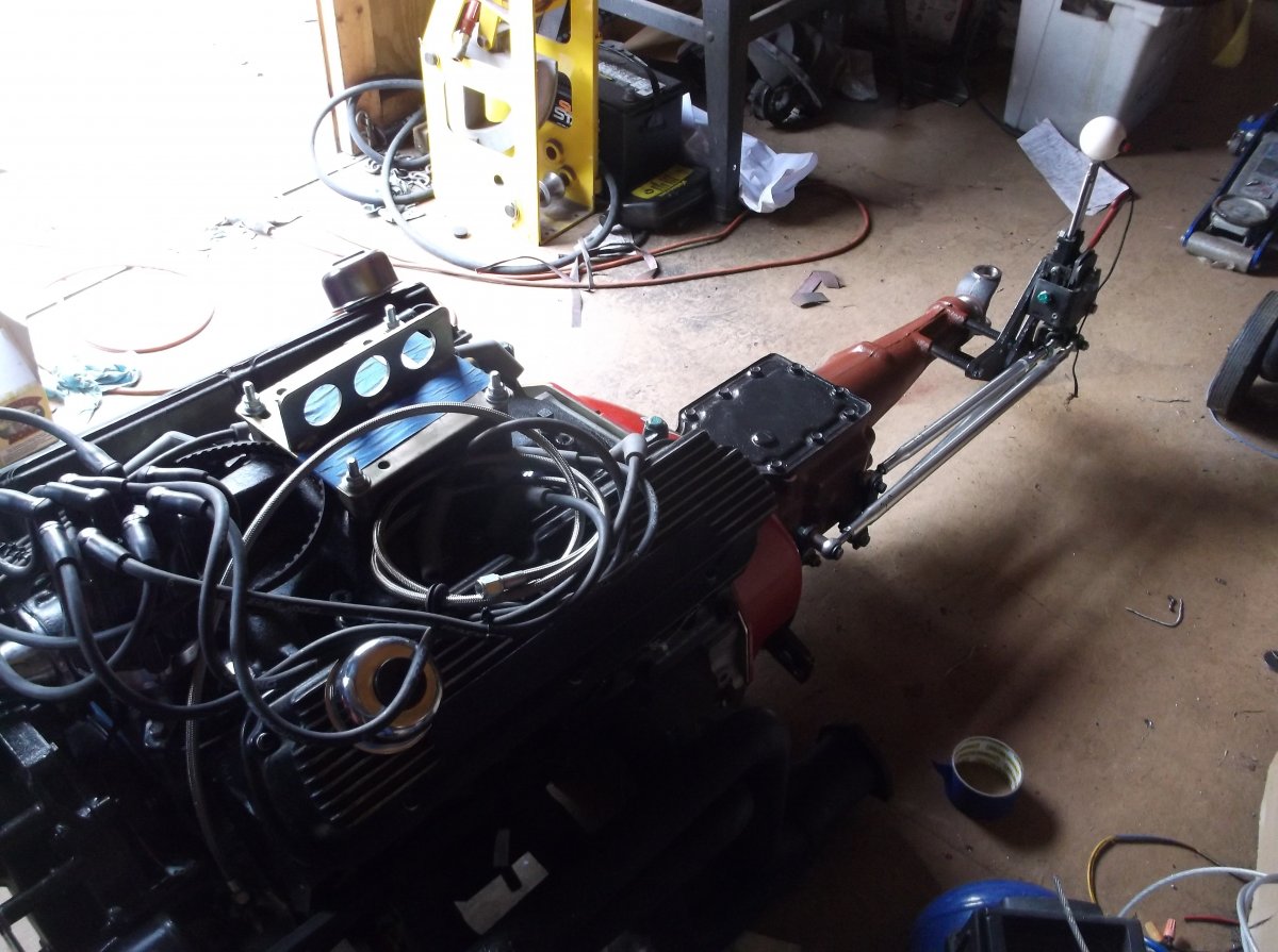

    It works. Thanks . I took it apart and cleaned it apart and cleaned it and sprayed it with dry silicone lube. I made the mistake of putting grease in a shifter once and it became a dirt magnet.
    I have seen some pro racers back in the day take the boot off and pour motor oil on the shifter and then put the boot back on.
    Do you like my Speedway shifter rods ? I shouldn't bend them. They sell them in various length's just order what you need and get some right hand and left hand thread heim joints.

  7. BamaMav
    Joined: Jun 19, 2011
    Posts: 6,969
    BamaMav
    from Berry, AL
    Hard to see, but is the shifter just supported by two bolts? As long as they are, even if there are three, I'd be worried about them flexing when you shift hard.
    loudbang and Thor1 like this.

    No there are three Grade 8 bolts inside of sleeves that are spacers. The same setup that I had with my inline shifter that was on my Morris Minor G***er. They are in a triangle so the strength factor is better.
    The spacers are needed to get the shifter out from the trans enough to line up with the shifter arms.
    It will be part of my between race maintenance to check them for tightness. I installed them with a drop of Loc***e to help.
    It should be in the hole by Monday. I have to wait until I get another golf course check to buy my starter to see how it sounds.

    As long as you're comfortable with it is all that matters. Myself, I'd have to weld some kind of gussets to each spacer, but I'm known to overbuild things!

    I wouldn't consider that "overbuilt" but I agree with you.
    That shifter is really extended out there and regardless of the grade of bolts, I would suggest welding those spacers together with a piece/pieces of flat stock to help each bolt be supported by the others.
    It might be fine on a street car but I predict that will be getting some abuse.

    It will get 2 p***es during qualifying and max 4 p***es during eliminations per race.
    Then it goes home for maintenance. I might consider building a support between the spacers.
    I will look at it some more before I put it in the car. It never loosened up or was a problem for the guy I originally bought the transmission from . He ran it for years with an inline shifter with the same length spacers and bolts.
    It won't get many street miles . Just to a local cruise-in once or twice per year.

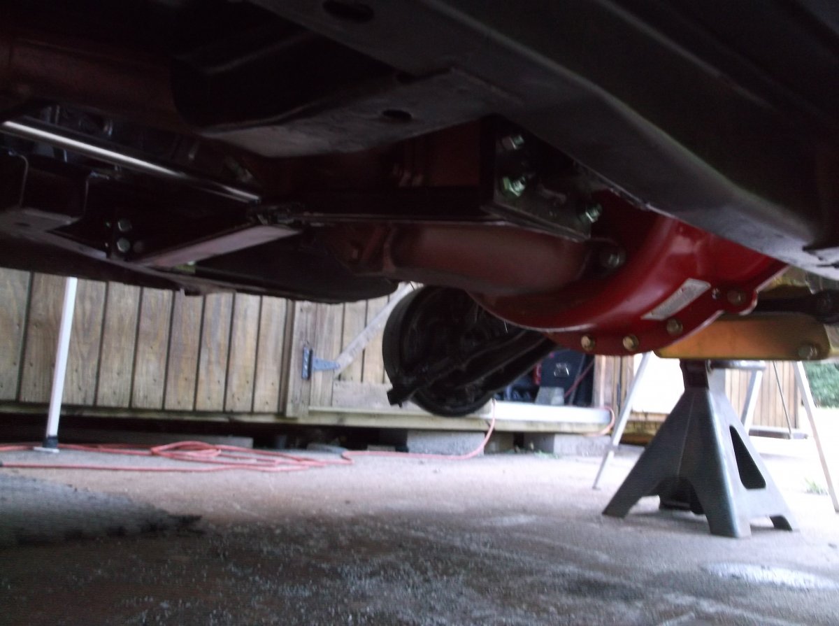

    well I managed to get everything under the car welded up and then I got out my 12 dollar Tool Shed brand paint gun and shot the under side of the car with semi gloss black.
    Waiting for the paint around the core support to dry so I can drop the motor and transmission in the car. It's looking like rain this afternoon so I may have to wait until in the morning.
    I might just put the easy up together and try to get it done anyway. I am getting tired of delays. DSCF3718.JPG

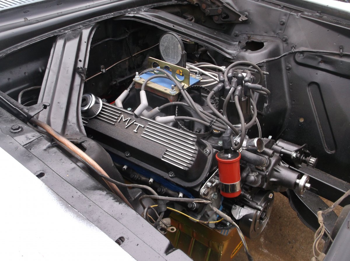

    It's on tires at least the back ones. I bounced it as hard as I could with no shocks and nothing hit so I guess it's good to go. Now I can measure and build my pinion snubber and figure out my rear shocks.
    Loaded the motor into the car this morning . Working by myself as usual. so I wacked the the core support to get the motor to clear. I will make it a bolt in DSCF3721.JPG DSCF3722.JPG piece for easy motor swaps.

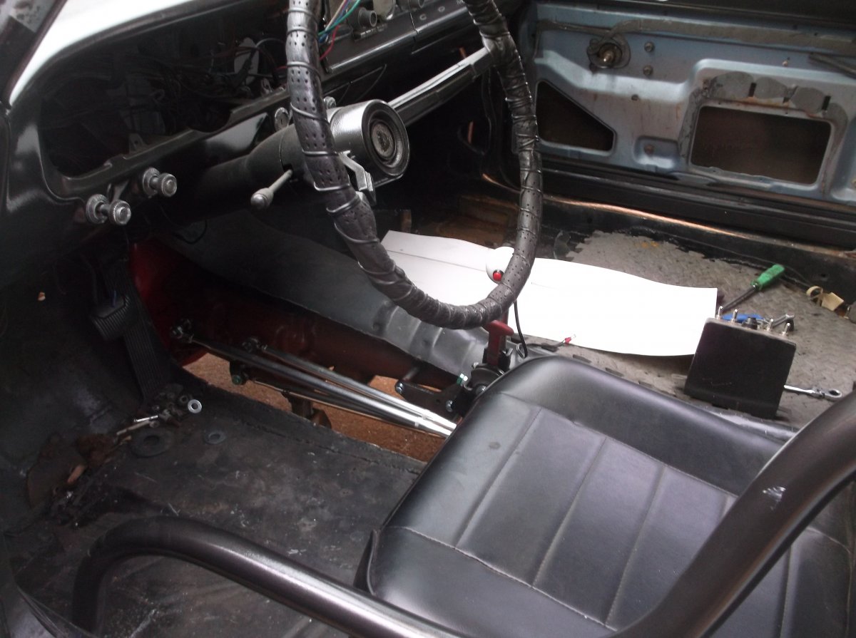

    Working on a new crossmember for the transmission. Since this is a Mustang trans in a Comet everything is in the wrong place.
    So I bolted up the shifter and mocked up the seat location to check out where the crossmember will run . It will probably wait until Thursday because I work tomorrow afternoon at the golf course. I hate to lose a day of working on the car ,but if I don't go work I can't buy parts.
