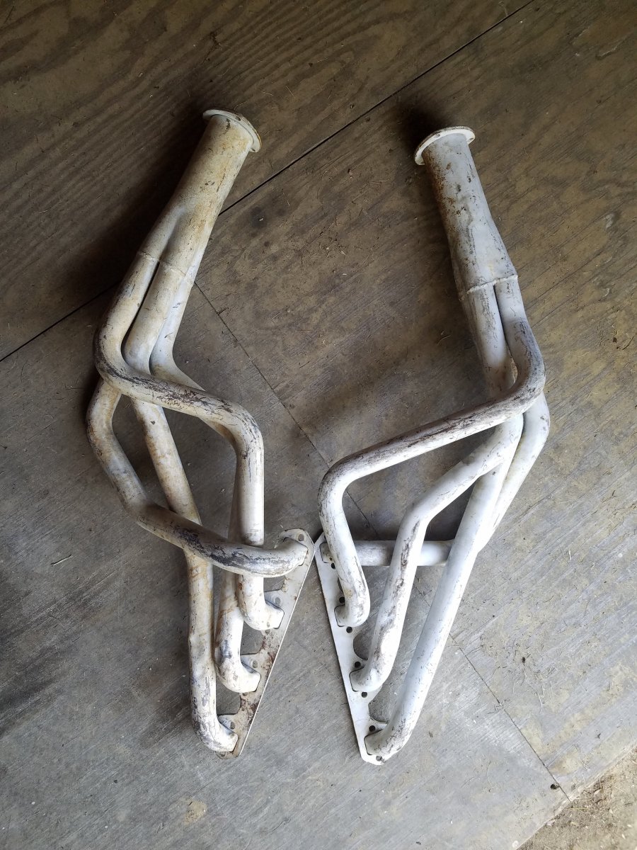

    20200729_222357.jpg ready to ship tomorrow!

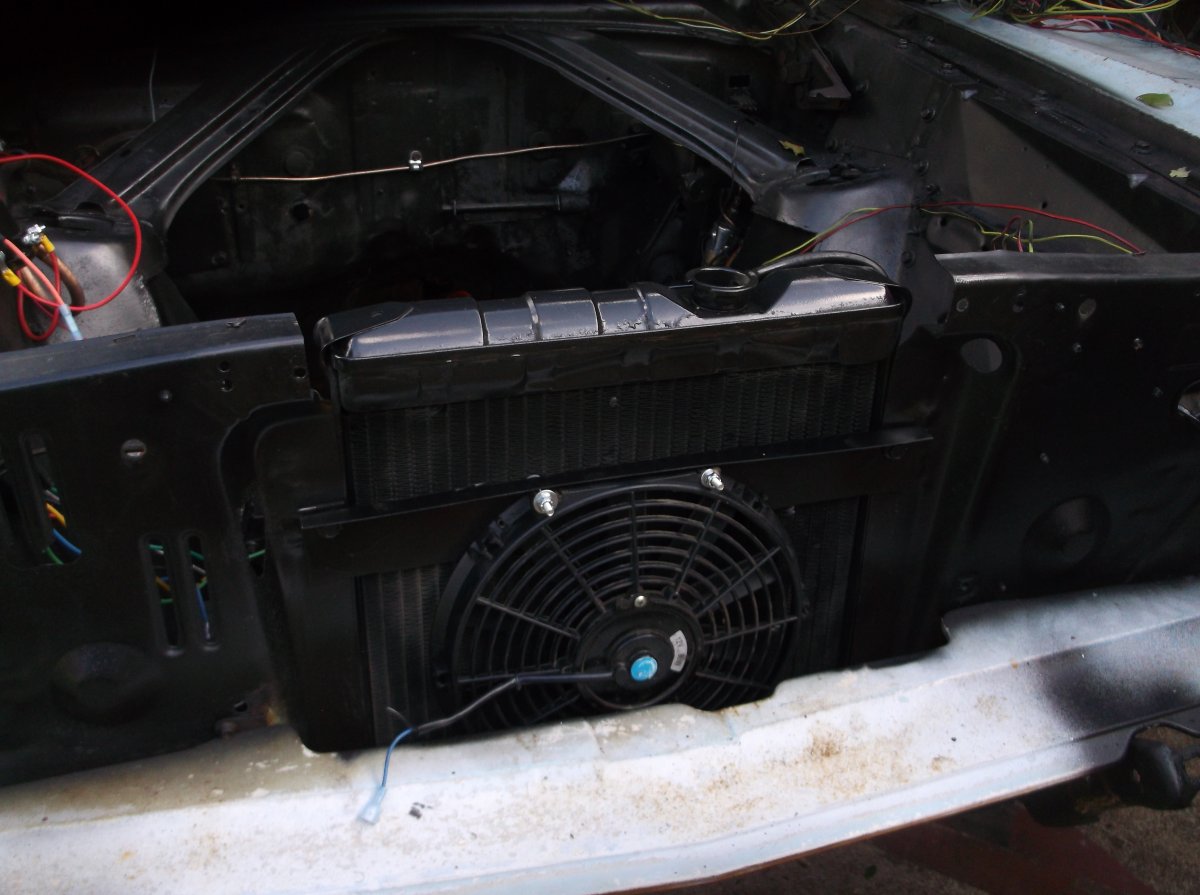

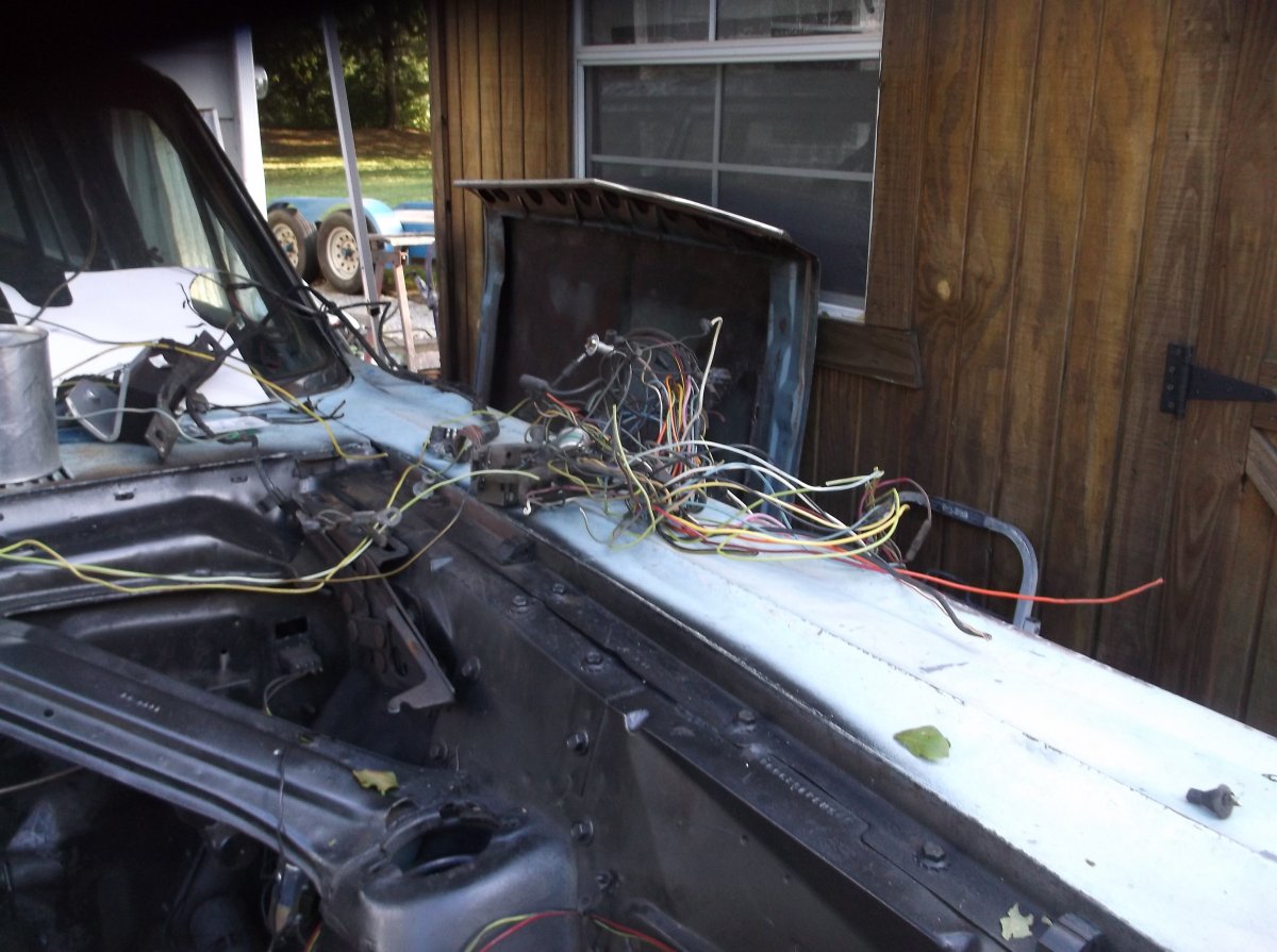

    DSCF3738.JPG DSCF3739.JPG DSCF3740.JPG Worked all day on the Comet and managed to take all of the OEM wiring harness. It had been cut and spliced together . I saved the wiring to the headlights and tail lights.
    Got the radiator mocked up with a pusher fan .
    Fabbed up a cable clutch pull conversion. Hope it works .A store bought kit costs about $ 160 and I have about 10 bucks in mine. Started trying something on my door panels . The plastic that use on dirt late models. A local shop has ends and pieces left over from a job. I get it real cheap. The guys are golfers and they bring me some pieces whenever they have some and then we play golf. DSCF3743.JPG

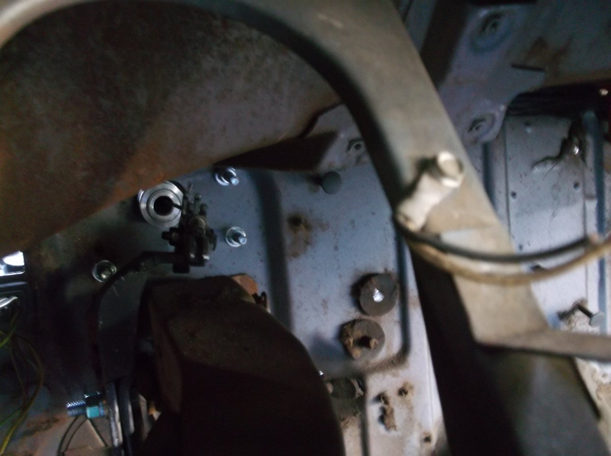

    It fits ! The clutch cable bracket fits just like I hoped DSCF3747.JPG DSCF3746.JPG it would.

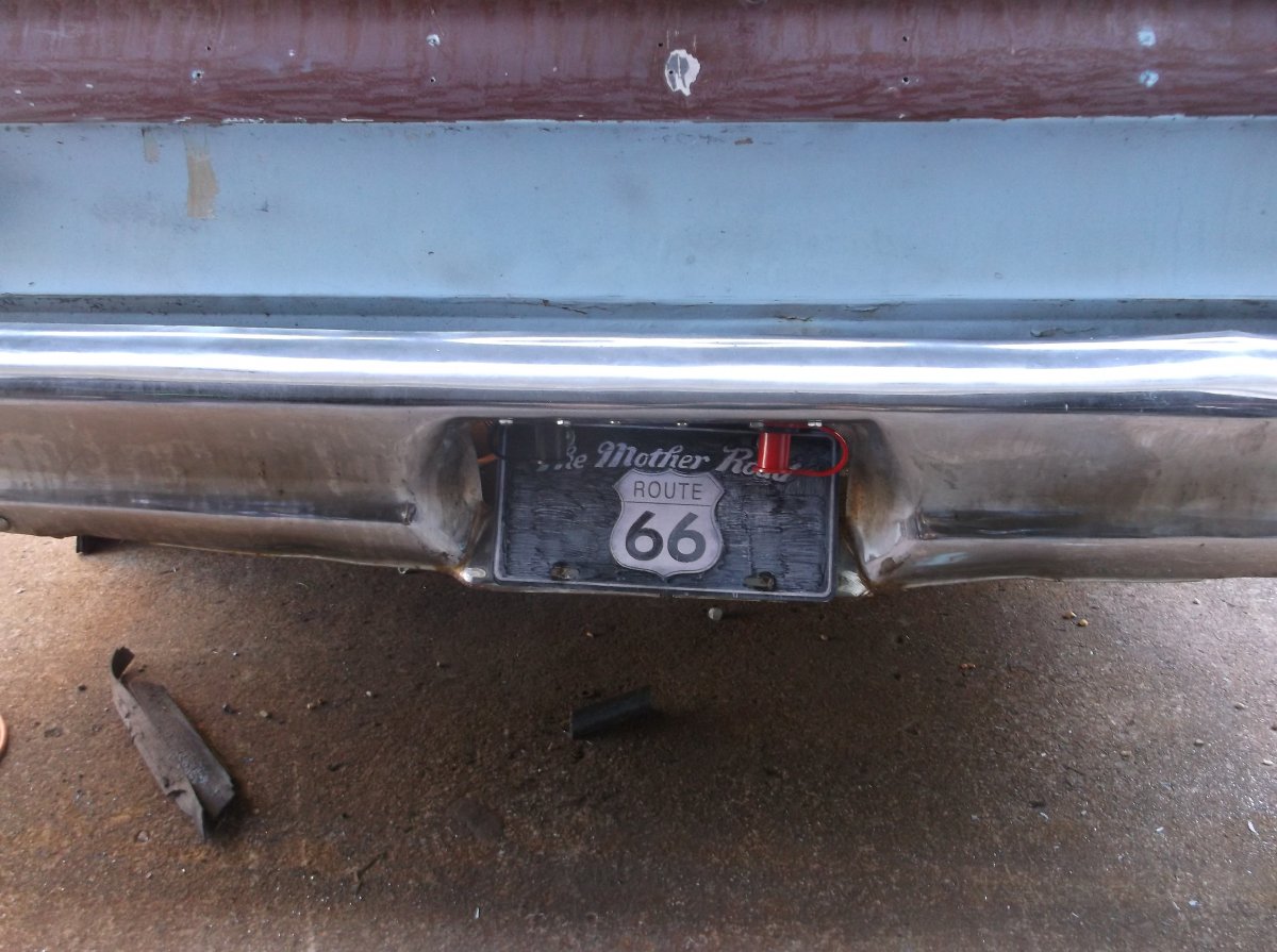

    Mounted my charging lugs. Rules say they should be out of site on the Super Stockers. didn't want to roll the back window down after every p*** and didn't want to crawl up under the car. So they are close to being hidden ,but easy to use. Made 2 brackets and used my license plate screws and drilled the bumper. There is a rubber filler panel that goes across from the body to the bumper that will keep the rain off of the back side of the lugs. DSCF3749.JPG

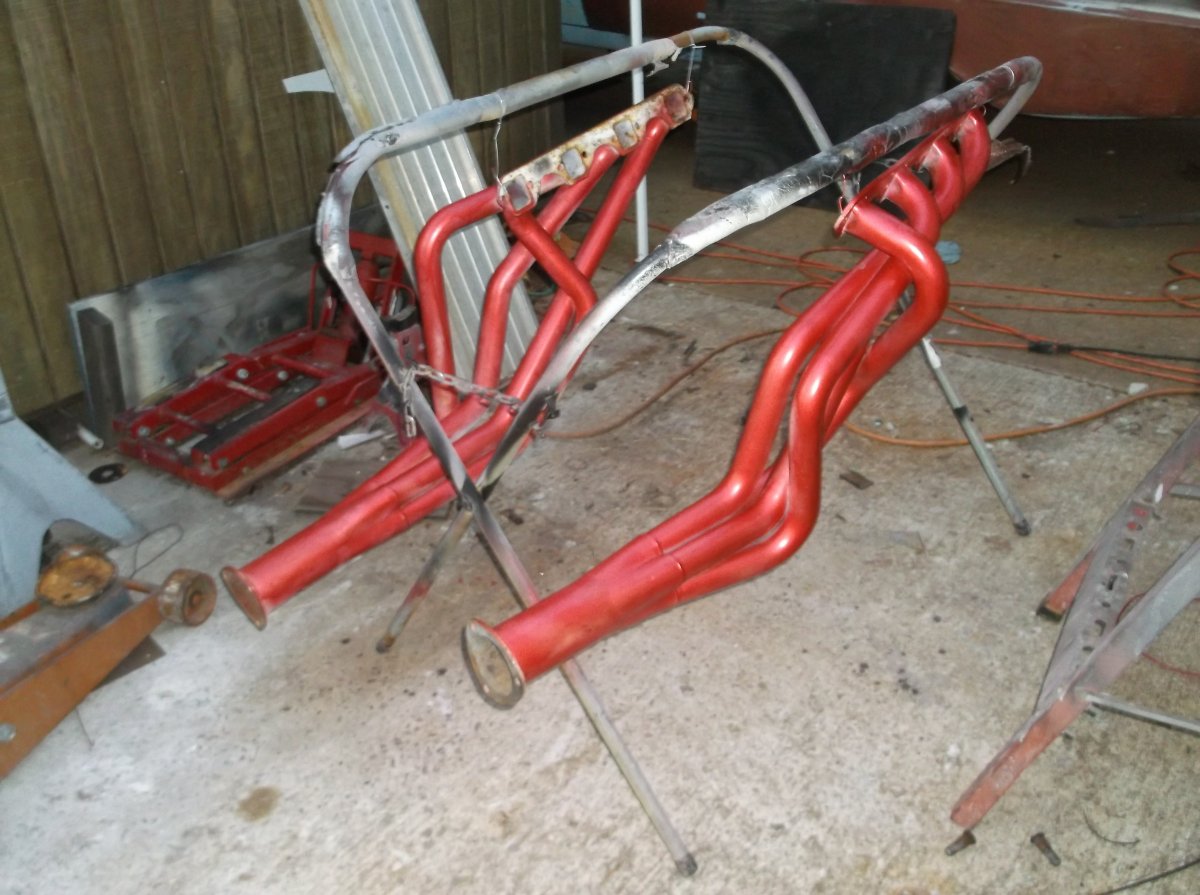

    Well the Fedex guy finally showed up with my headers wrapped in shrink wrap. No wooden box that
    ididntdoit1960 built to ship them in. Just the headers. This time they went through Knoxville.
    Fedex is one screwed up company.
    I test fitted them on the engine and because of the design of the Pro Ma** heads I had to trim a little off the mounting flanges to clear the heads and the head bolts. Not enough to get into the gasket portion ,just along the bottom.
    They are considerably narrower than the Dougs . I should have plenty of clearance as much as I have cut out of the shock towers.
    We will find out tomorrow when I try and install the motor and trans and the headers. Cleaned them up and shot some high temp paint on them today. DSCF3750.JPG

  26. BamaMav
    Joined: Jun 19, 2011
    Posts: 6,969
    BamaMav
    from Berry, AL
    Those look like ****** 6901's, or a copy of them....
    chryslerfan55, loudbang and Thor1 like this.
  27. 51504bat
    Joined: May 22, 2010
    Posts: 5,659
    51504bat
    Its been a long time but they resemble the Cragar headers I put in my '65 Falcon 2 dr. wagon but in 1970. Super tight fit and I got greasy hand prints all over the nice white VHT paint on the headers during the install. As soon as I fired it up to break in the Sig Erson solid lifter cam all the paint burned off.

    I found a number stamped on the inside of the flange . It is B 6101. Tried looking it up with no success.
    Has anybody seen headers with that number ?

    Got the motor and trans back in the car and the headers will not fit. I took the motor mounts back off and the frame mounts off. The driver side slams into the steering box and the p***. side will not clear the ****ter shield or the floor toe board.
    colbyw has a set of ****** headers from his Falcon Ranchero when it had a Windsor . So I know that they will fit. I will get them from him at the Alabama race.
    In the mean time I will get the wiring done all the plumbing done . I can start sanding and priming the car so Llyod won't have as much to do when I take him the car.

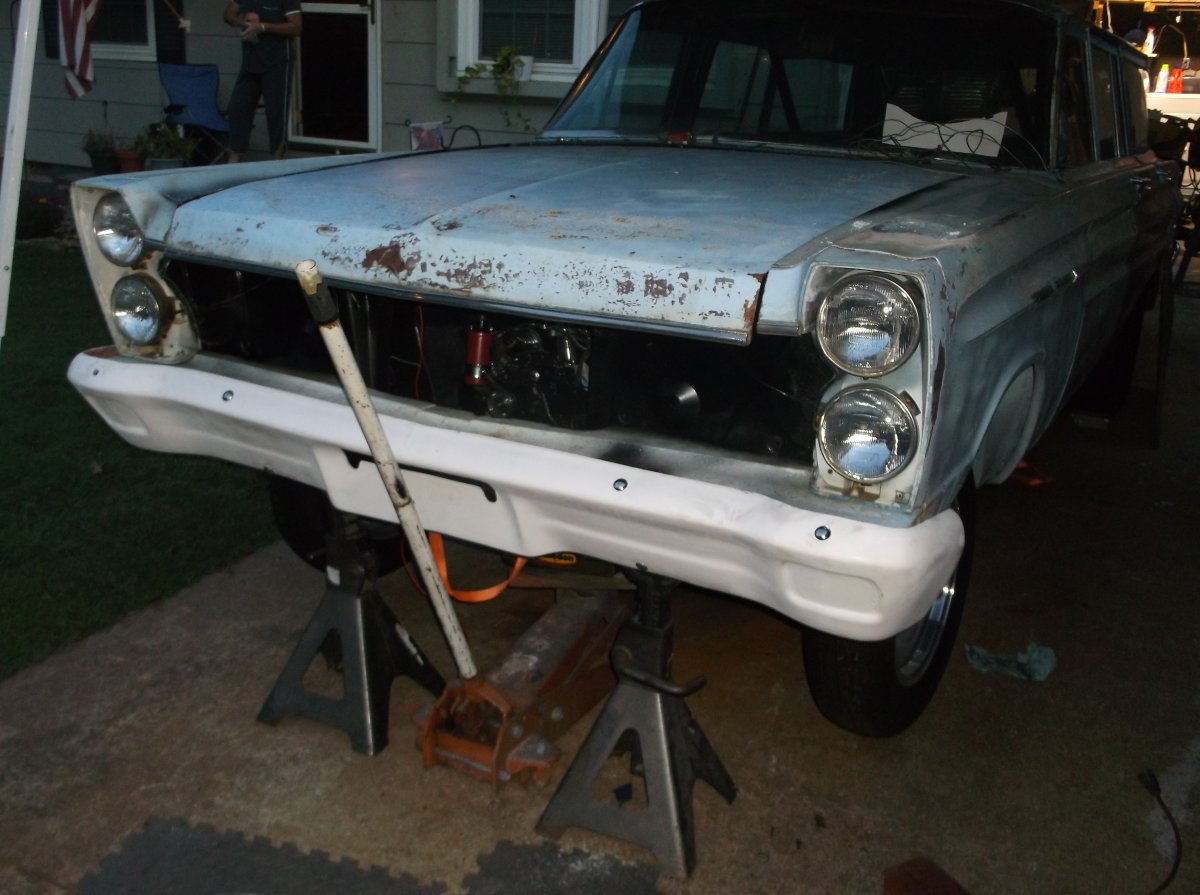

    Started fitting my Crites fibergl*** front bumper today. The inside brackets lined right up.
    The outside brackets have to be moved. I got the driver side shortened and that put it in the right place.
    Tomorrow I will do the other side before work.
    I didn't even know these cars had a bumper bracket on the side of the bumper because the original did not have one. I will have to fab up something. The sides of the bumper needs to be pulled in closer to the fender anyway. DSCF3753.JPG DSCF3754.JPG
