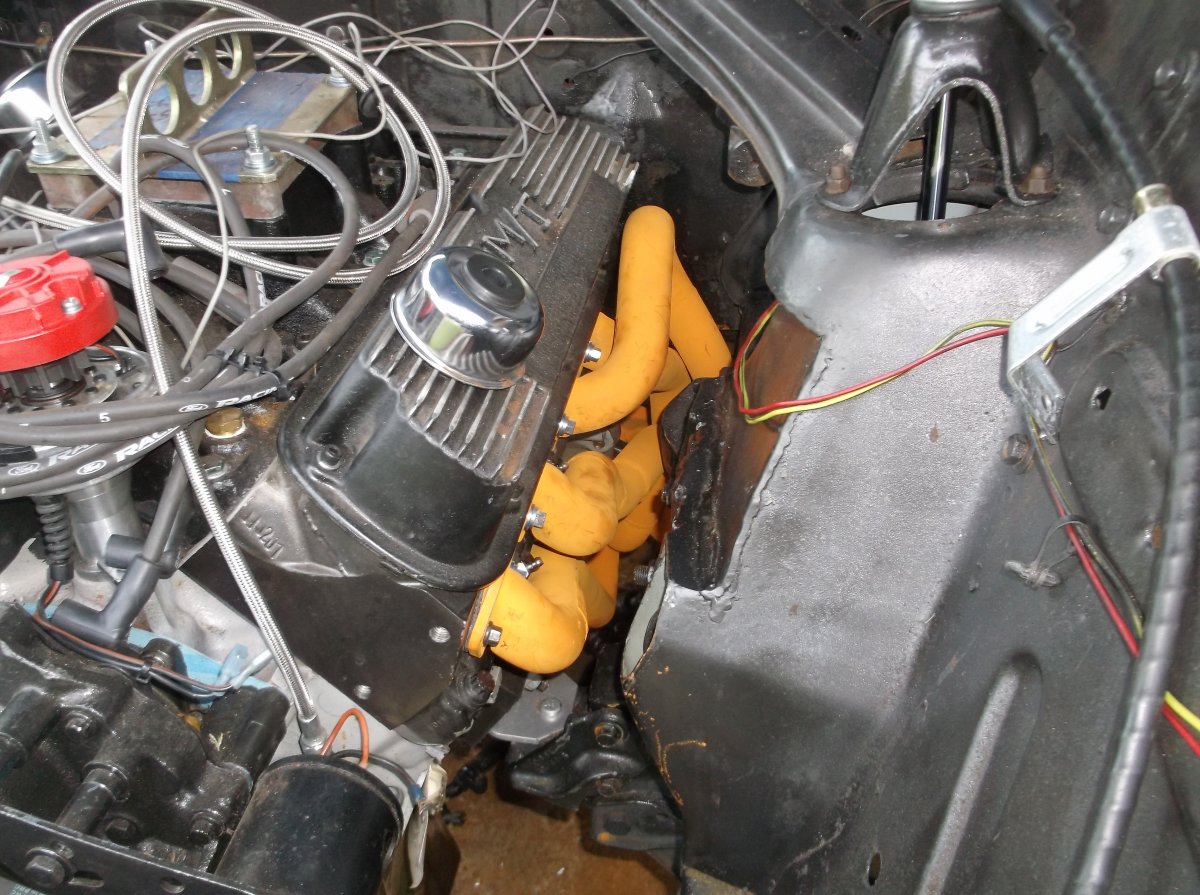

    It inspired me to thrash on the car. I got the headers from colbyw,thank you very much.
    They were actually Hedman headers for a 351 swap and I had to cut two of the pipes and reroute them on the driver side. No issues at least they are in great shape.

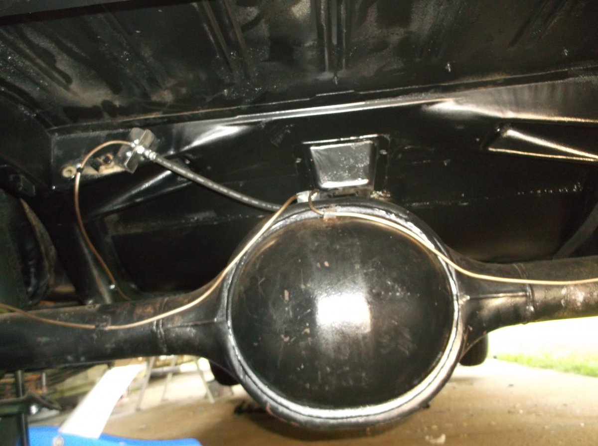

    Finishing the brake lines today but needed 2 more steel nuts. Will get them tomorrow.

    Got my brake lines made up and installed today. Hope to have them bled and have brakes by tomorrow. a good rear brake hose to use is for a 75 F100. It has a bracket to bolt it to the 9 inch Ford rear. It uses the top 2 chunk bolts.

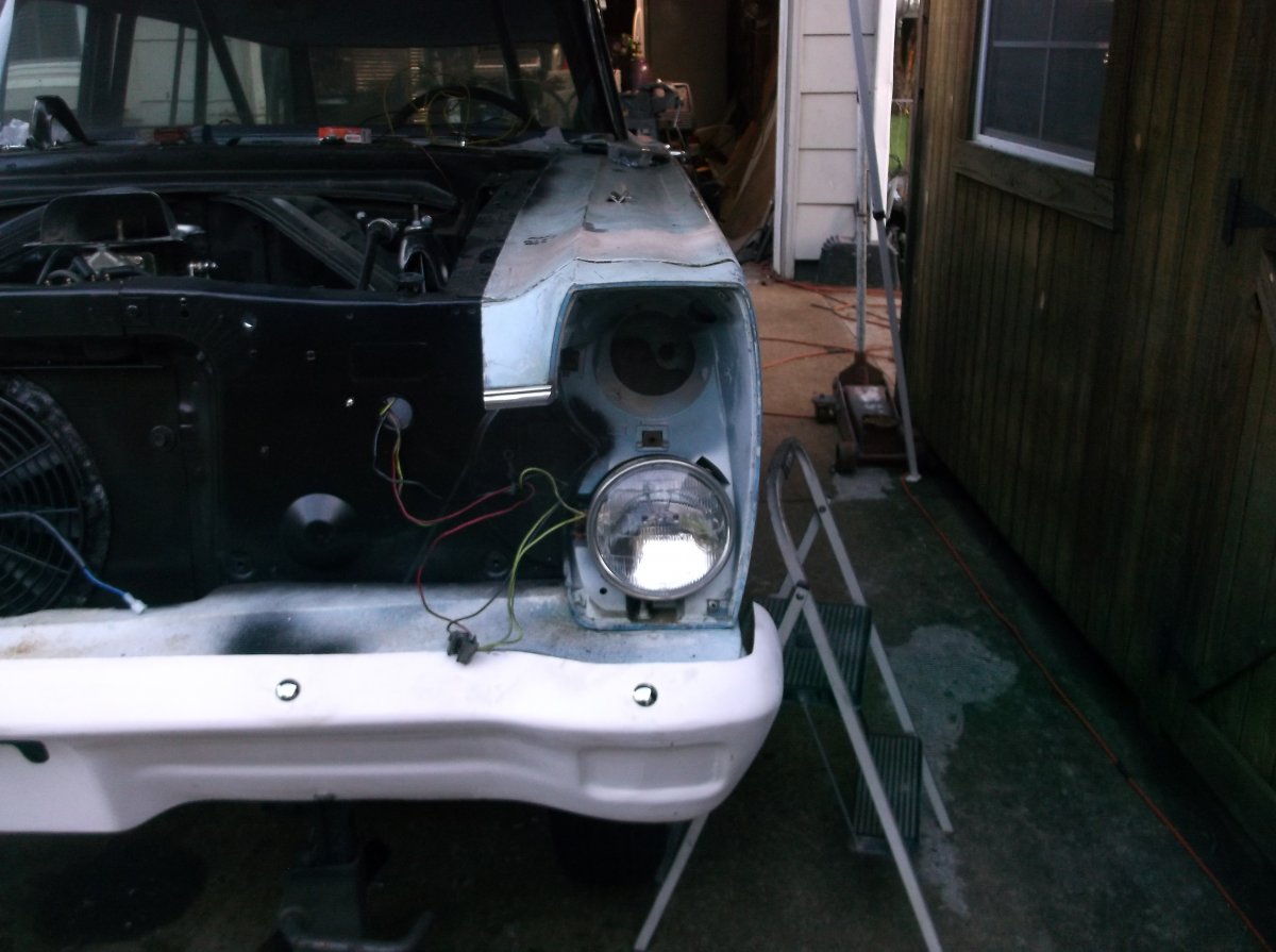

    got the o.k. to remove 2 of my headlights to use for ram air. So I need to get to work on the plumbing.
    Just need to use the upper or lower head lights.

    I meant to say I need to decide which lights use . I know the lower ones would look better , but the uppers might be more effective.

    Finally got the stupid headers to fit around everything. I had the left side on and off at least a half dozen times. the p***enger side was not too bad.
    I had to account for the pitman arm the steering box ,the frame and firewall. Plus leaving a path for the clutch cable so it wouldn't get roasted.
    Got the motor back on the mounts and the trans. crossmember bolted up. Got the shifter back in.

    Got my radiator and fan and hoses installed. Decided to use the top headlights for the ram air.
