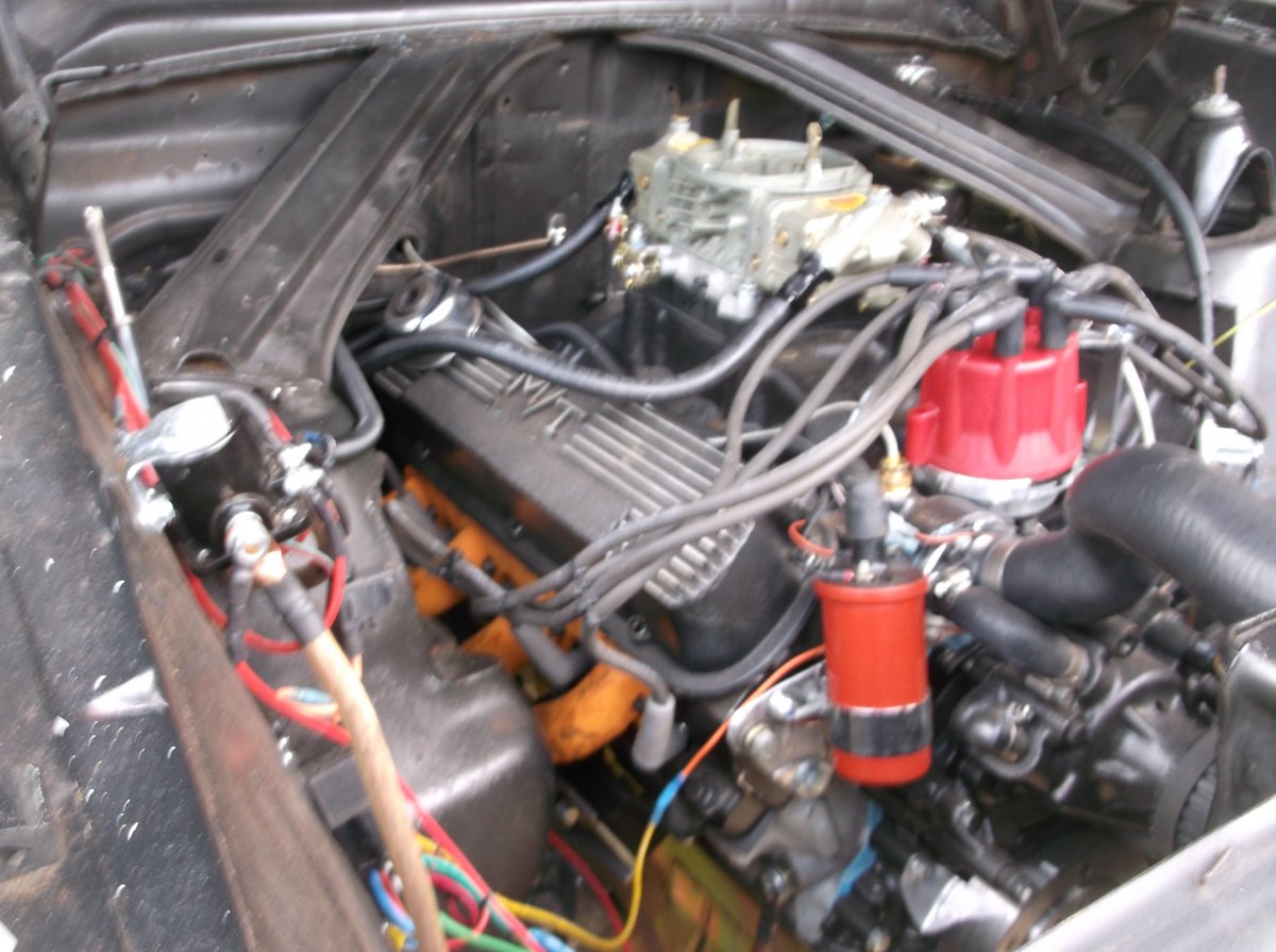

    I think I am ready to crank the motor. I am going to pull the distributor and re prime the motor. It has been over a month since I primed it the first time.
    All of the systems are working and it should be ready. The only unknown is the used MSD box I got in a trade. The guy said it came from a running vehicle and I have dealt with him before and everything was what he said it was.
    I still need to bolt the seats down. Install the belts. Bleed the brakes. Align the front end. Install travel limiters on the front end. Build a driveshaft loop. Try and get a coat of primer on the car.
    Other than that I am ready to race. I do have to work Sat. and Sun. at the golf course so my weekend is pretty much shot.

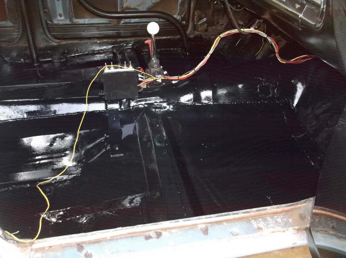

    So I got out some metal and cut it into 2 inch wide strips and put it in my press and bent it into a U with the screw on top of my argon bottle. Then finished bending it in my vise with a long cresent wrench with a piece of pipe on the end. It is my driveshaft loop . Feeling good about making such nice bends I get under the car to see about installing it and the driveshaft tunnel is too small . It originally had a 2 inch driveshaft and my new shaft is 3 inches. My loop is 5 inches wide to allow clearance for the bolt heads.
    So I marked the floor and cut out a 2 inch strip and recessed the top of the loop into the floor.
    the top half of the loop is now welded into the floor and fits perfectly. Added 2 12 inch pieces to the loop on each side to make sure if the shaft breaks and tries to come up it will be contained by the loop and not join me in the driver seat. Those are sandwiched top and bottom and bolted through the floor pan.

    Well just got off work and got the front floor cleaned up and painted . Ready to bolt the seats in.
    Won't get the carpet in until after the first race. No door seals and 500 bucks is out of the question for now. That's for the doors, windshield, 2 rear side windows. Not including the tailgate seals.
    Just make it run and drive for now. The p***. side door bar will have to wait also.

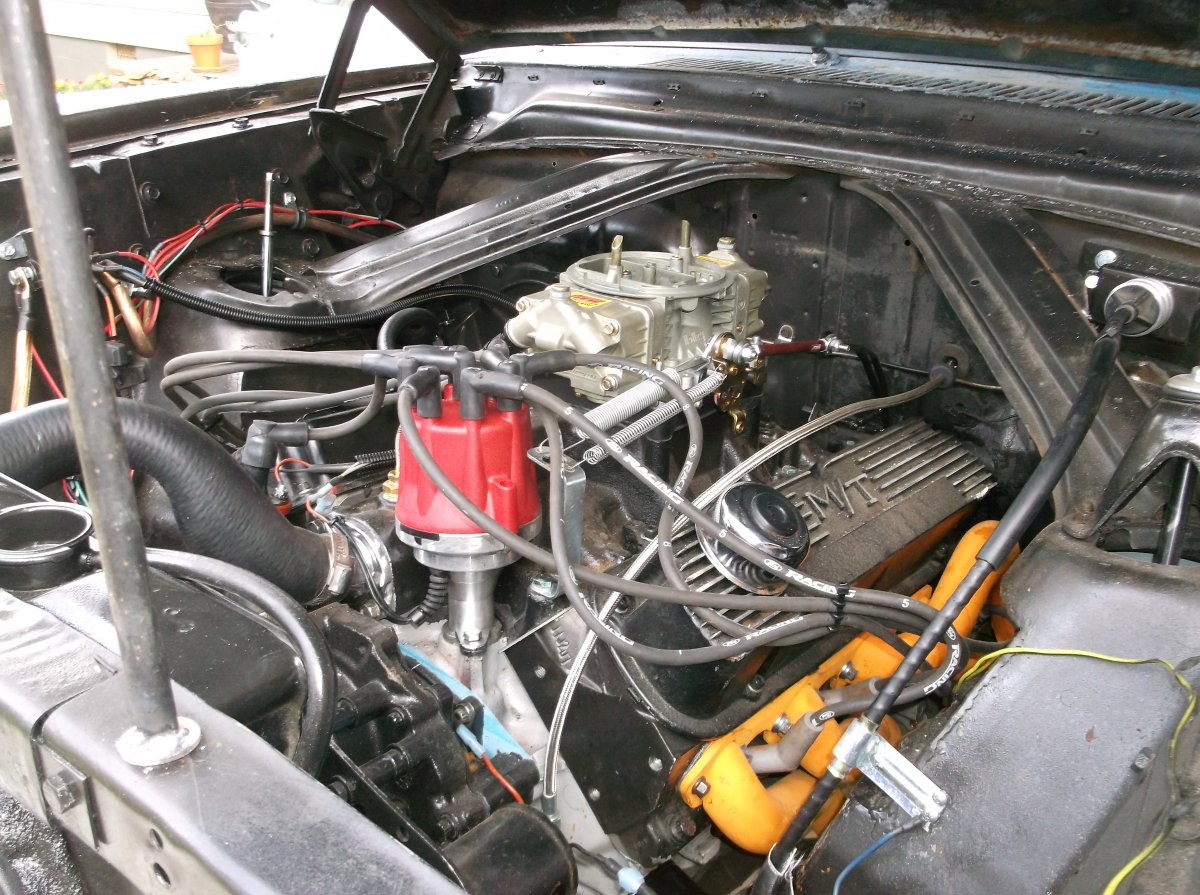

    Well got off work today and came home and pulled the distributor and primed the oiling system and put it back in. hit the switch and turned on the fuel pump to prime the carb. Hit the switch and it kicked back a little so I pulled some timing out and it fired right up. No death rattles or unusual noises just the sounds of a high compression solid roller small block.
    Didn't run it too long without water, but it sounded good and healthy. So that part was good.
    Put the right front shock in so that gets checked off. Tomorrow I will get the diaper on and the front end put back together. Need to put my travel limiters on the front end and get the alignment done.
    then bleed the brakes and put th. car on the ground.

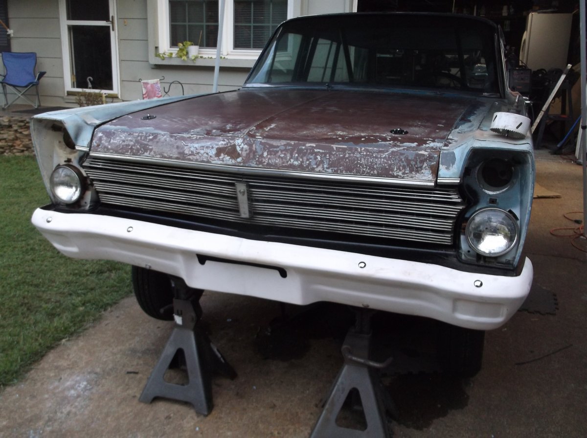

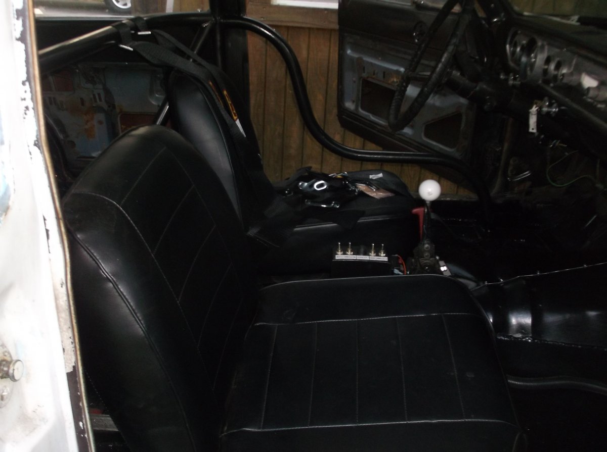

    Yesterday was fairly productive. Got the front suspension done except for setting the toe in. Made my front bumper brackets and got that done.
    My wife painted the rear floors so I can do my seat belts today Got my wiring cleaned up and tucked away. Put my oil pan diaper on which is a real treat on this car. Universal diapers are just that. Meaning they don't fit anything. In order to make it fit the oil pan and clear the steering linkage I had to attach the back 2 straps to the lower ****ter shield bolts instead of the back header bolts .
    Today hopefully I will have the brakes bled and the car on the ground with the seat belts and seats installed. My wife asked what I wanted for my birthday today and I told her I needed her to pump the brakes so I could get them bled and she could buy me 5 gallons of race gas and a 4x8 sheet of black plastic so I could make the door panels and the inner fender aprons in the back to keep the tire smoke out of the car.

    Well We have brakes and seats and seat belts. Thanks to my wife helping me we knocked out quite a bit of the list.
    I really have only 4 things to do before I can load it on the trailer. I need to set the toe-in, build my door panels, install my pinion snubber and hook up a taillight.
    The office is open for business. Starting to look like a car again. An ugly one ,but a car. DSCF3773.JPG DSCF3775.JPG
