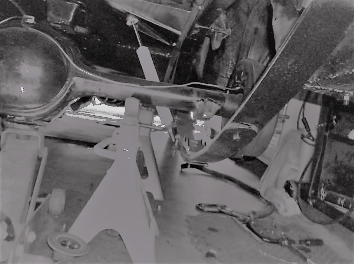

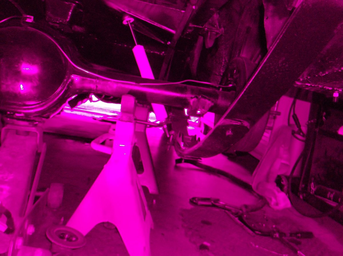

    Yeah, it makes it look like I am using a black light for a flash. I got the saddles welded in place.
    I am making the new spring plates the old ones were bent and so
    I am making ones that won't bend and will have tie down slots in them so I don't have to have axle straps.

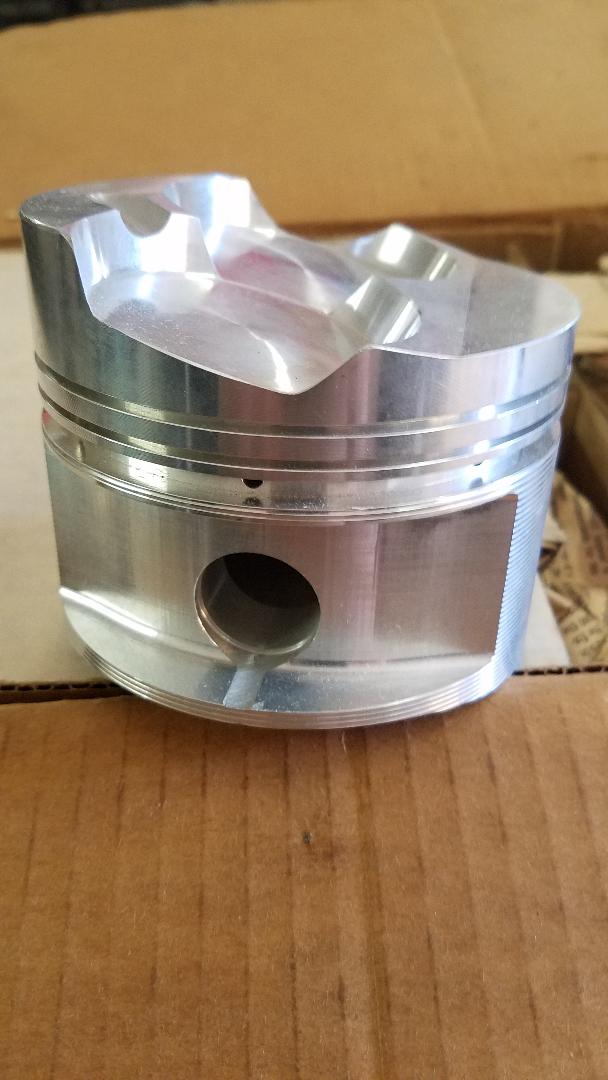

    A little update on mine- I traded into a new 50 F1 style drop axle with disc brakes and two sets of springs, and just last night, bought a factory welded Alston rear subframe complete with 4-link, coilovers, Panhard rod and all the heims- getting interesting. I already have a pair of 48" rearends, one a Mark Williams 40-spline with a spool and 4-link, and a Strange 35 spline with a Detroit Locker and ladder bars- think the 35 spline might go in the 56 Bird.
    I have a set of pistons that might be interesting (and cheap) for your future FE setup- a circa 68 NASCAR destroker deal. 427 with a 361 truck crank, makes a 396 ci screamer. Pistons are NIB Arias, with MAX domes (trim to fit the chambers). I have $400 in them
