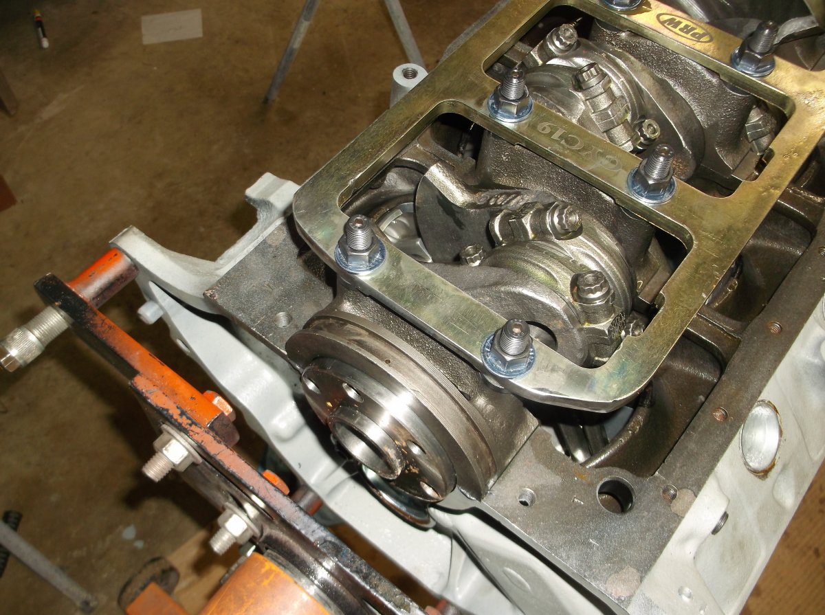

    Well I got this far . I need to pull the crank back out and clearance the thrust bearing. I don't have enough end play . I need between .006 and .008 and I only have .002 so it will have to wait until tomorrow. DSCF3592.JPG

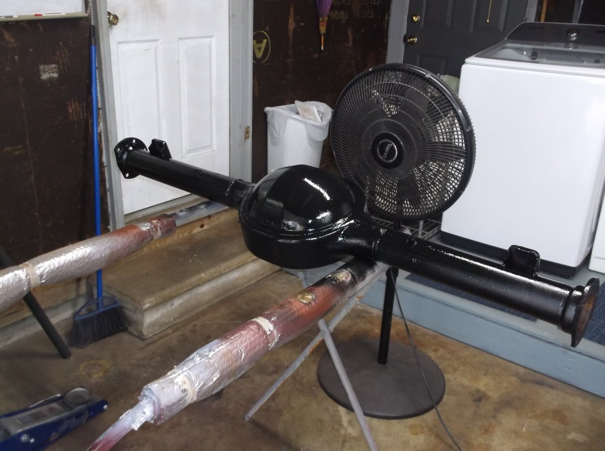

    Got a little side tracked . I started cleaning up the rear end housing. It came out of a car that had been setting on the ground for who knows how long with no axles or chunk. You can imagine how rusty and nasty it was. I pressure washed it to get the mud off. Then I took my angle g DSCF3593.JPG rinder with a wire rope wheel to get the major rust off.
    The got out my little secret sauce to make the metal look like new. My bottle of muriatic acid and a brush. Let it set about 5 minutes and rinsed it with a hose and it looked like new metal both on the outside and in the axle tubes.
    Sprayed it with Rust convertor , then red primer and finally semi gloss black paint. It looks like it's ready for some gears and axles. Going to give Strange a call tomorrow to get stuff coming.

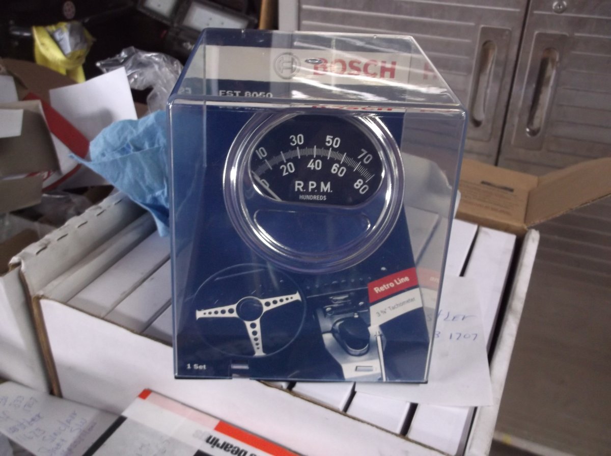

    It was like Christmas today. My hubs and steering stuff came in today. My Bosch DSCF3596.JPG DSCF3594.JPG tach got here.
    My motor mounts also and my frame brackets. Got my rings all gapped and my Thrust bearing adjusted.

    Well got my rotating ***embly put together today after church. Now I can degree the cam and install all of the rest of the parts.

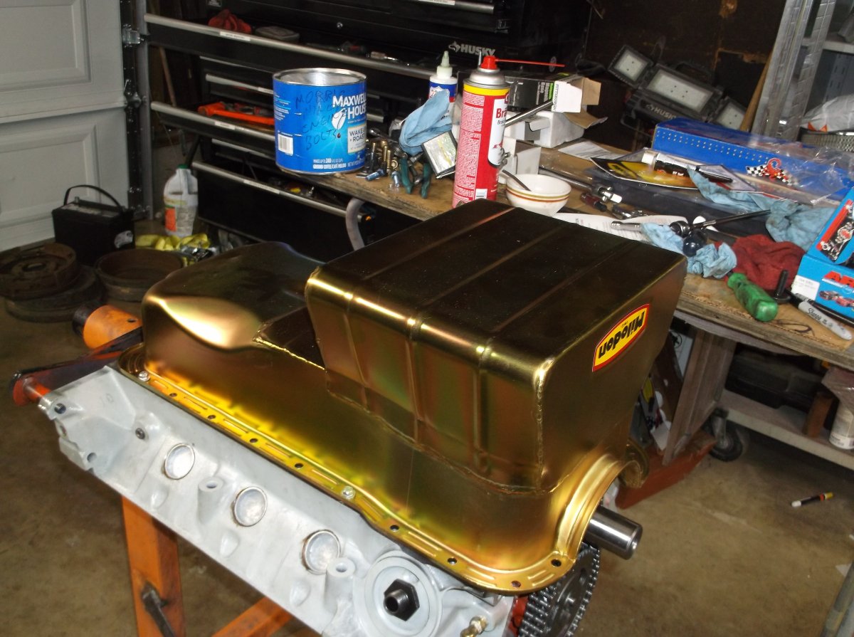

  21. southcross2631
    Joined: Jan 20, 2013
    Posts: 4,412
    southcross2631

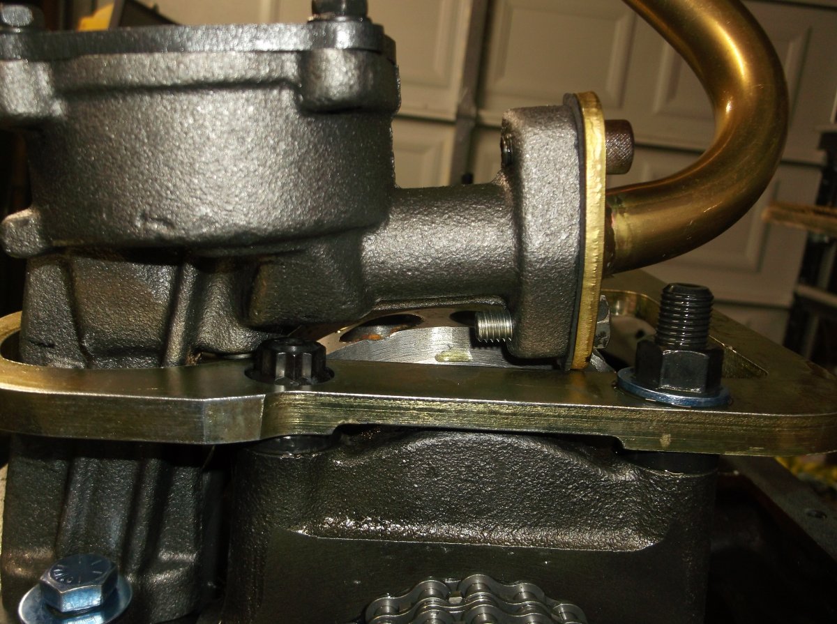

    So simple. Bolt the oil pump to the pickup and bolt it to the block. Wrong ! The pickup tube bracket lays on the stud girdle. The oil pan hits the stud girdle.
    So take the stud girdle off and grind a relief in it so it clears the pan and then grind the pickup tube bracket so it clears the main girdle. Then make sure the clearance with the bottom of the oil pan is correct. The bolts in the picture are NOT the right oil pump bolts before somebody jumps on that.
    Then retorque the main studs after putting the stud girdle back on.
    Easy enough 3 hours to bolt an oil pump on. Good thing I don't have to pay someone else to do my work.
    People wonder why engines cost so much. It is because they have to be put together about 3 times before everything is the way it's supposed to be. Maybe that's why that crate motor deal is so popular . You right a big check and hope it's done right . DSCF3599.JPG DSCF3601.JPG DSCF3600.JPG

    Yea but you know that hoping it is right has always been a problem for me. I had much rather do it myself , no matter the time, and know that I now only have one person to blame if I need to.

    I used an aluminum girdle on the 302 I build year back. Seem that I had to do a little clearance work on it also.

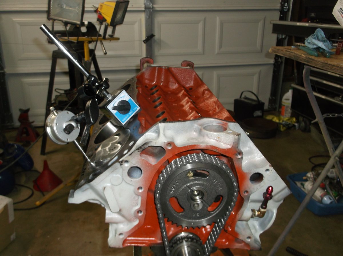

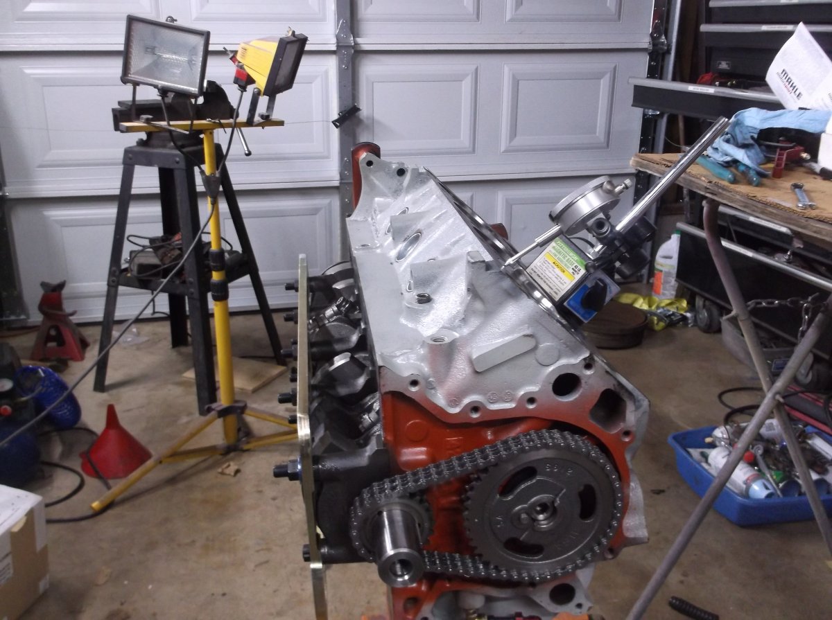

    Spent the day watching it rain, but it wasn't a cold rain so I could work with the door open.
    60 degrees was not bad. I got my timing chain in this morning so I got the cam degreed and got the heads cleaned up . Tomorrow I can check my piston to valve clearance and finish the long block.

  27. southcross2631
    Posts: 4,412
    southcross2631

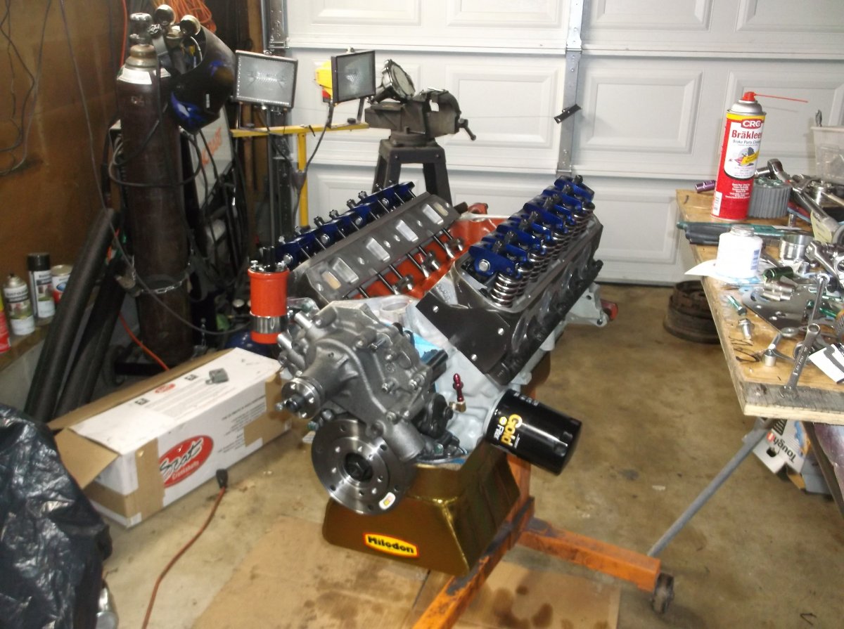

    Well I finally got the long block built. I still need to make a timing pointer because the water pump hose is switched from the p***.side from to the driver side.

  29. southcross2631
    Posts: 4,412
    southcross2631
    Waiting on a long shank egg bur to get here so I can get up further into the intake ports.
