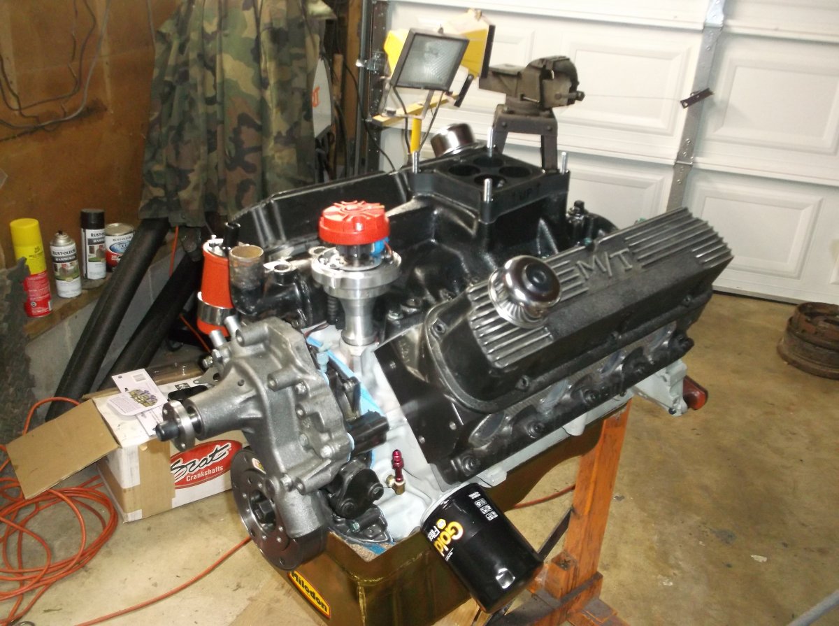

    Did you use glyptol on your lifter valley and timing chain recess? I heard of somebody recently using rustoleum primer. They even used it in the crankcase area.
  2. southcross2631
    Joined: Jan 20, 2013
    Posts: 4,412
    southcross2631
    Yes. It is glyptol. The machine shop I used down in Florida uses it on all of his race engine machine shop prep. It's included in the cost. Kind of a nice touch.

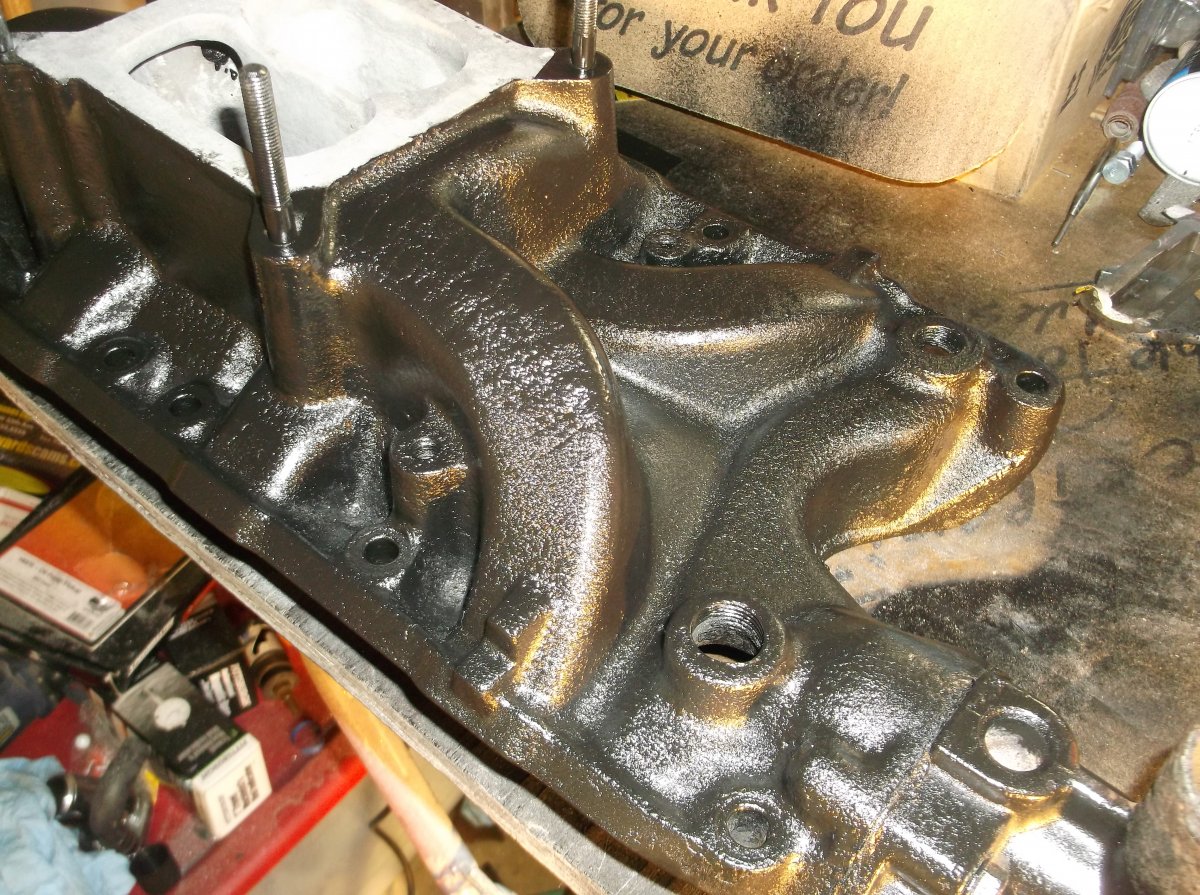

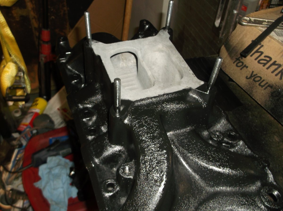

    Just spent all day grinding on my Performer RPM and then another 2 hours acid porting the places I couldn't get to. Will post some pictures tomorrow.
  4. southcross2631
    Posts: 4,412
    southcross2631
    Got a few pics of the intake after grinding and acid porting. That black spot in the bottom photo is from painting the manifold with a plug out of the back. DSCF3609.JPG DSCF3608.JPG

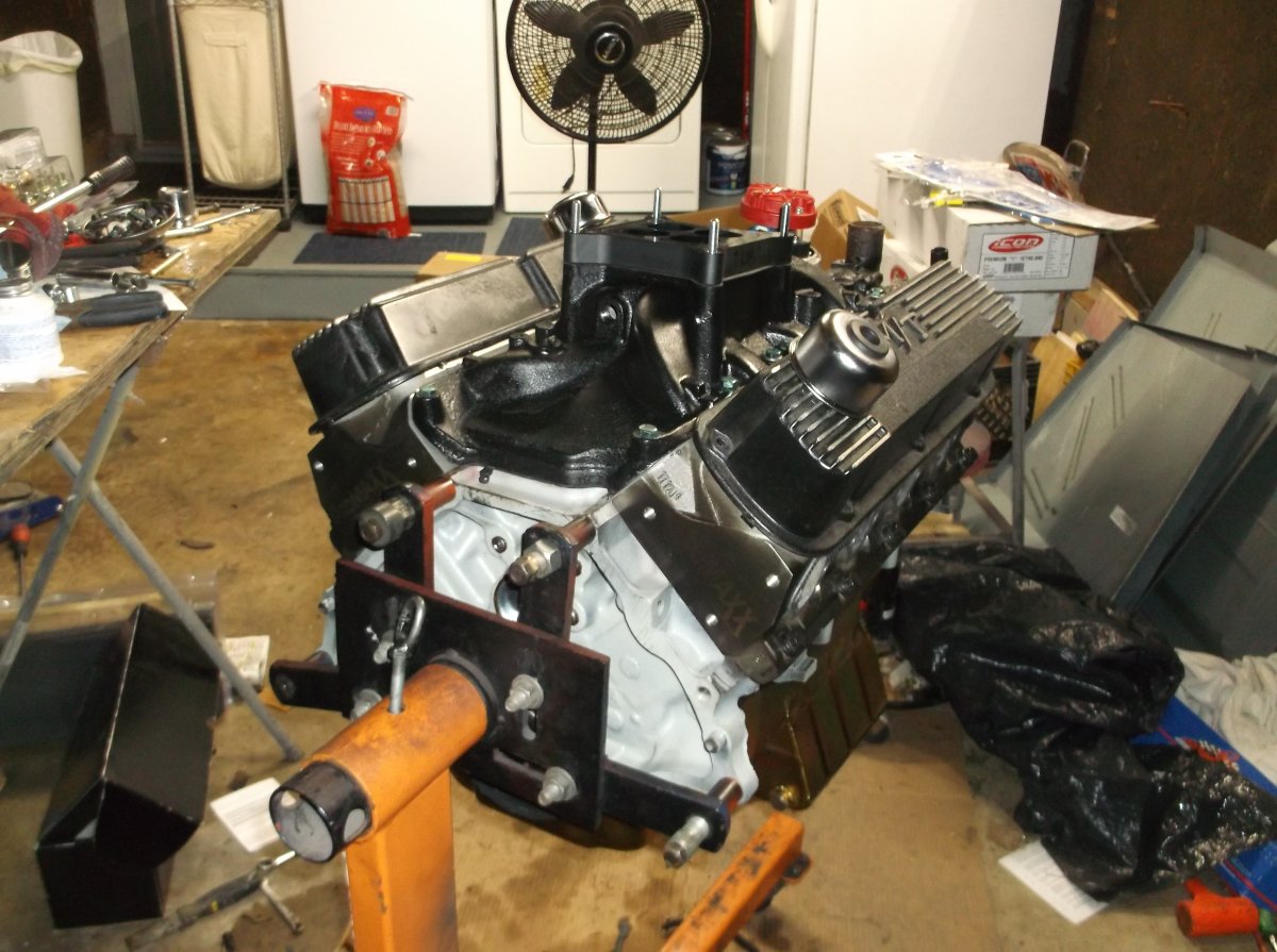

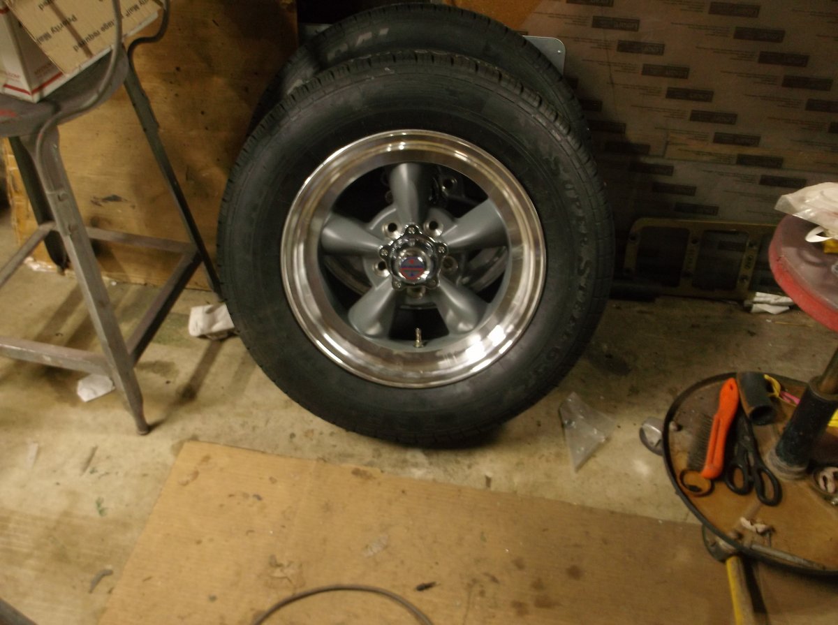

    Well FedEx came today with my front wheels. Got my motor almost ready today.
    Supposed to be rainy next few days so I can start on building the chunk for the rear end. DSCF3610.JPG DSCF3611.JPG DSCF3612.JPG

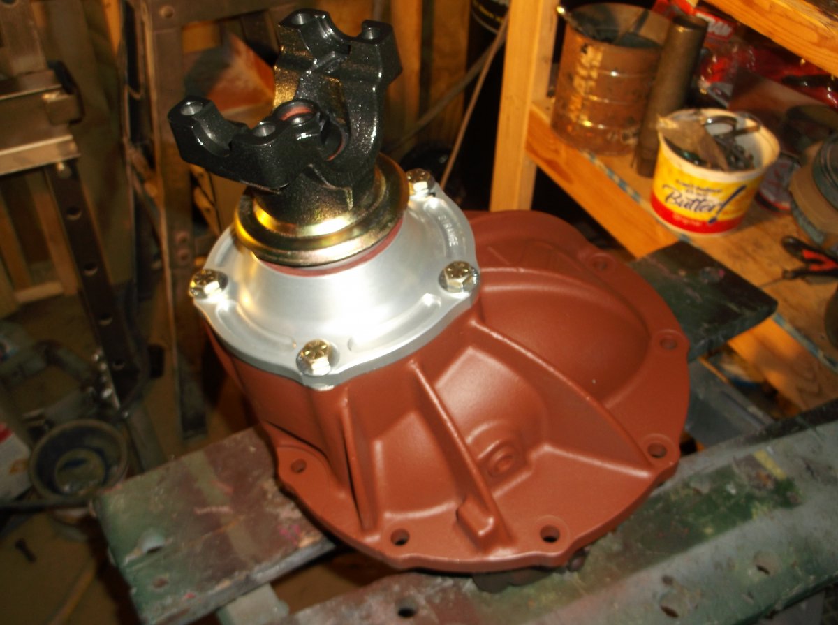

    Good rainy day project. I got my chunk built. Strange carrier, spool , Daytona pinion support. 5.29 gear with 1350 strange yoke. Tomorrow I will paint it. DSCF3614.JPG DSCF3613.JPG

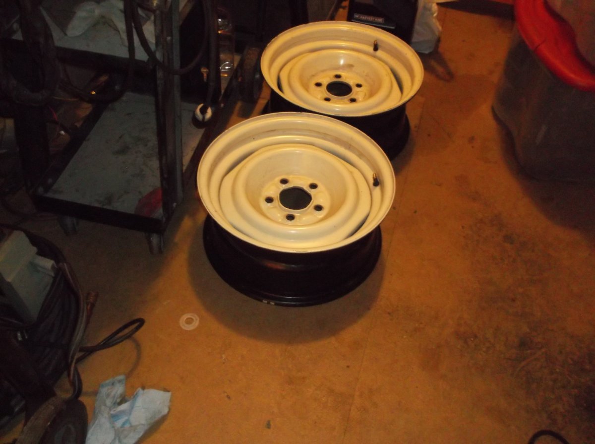

    Well I went up in the hills today and found some parts . Got me some 15x7 small bolt pattern original Ford wheels $ 25.00 each. Also a good deal on a 5 gallon fuel cell. Be surprised how much good stuff is hidden in the hills of Tn. Just got to know where to look. DSCF3617.JPG DSCF3616.JPG DSCF3618.JPG
    Got my chunk painted today.

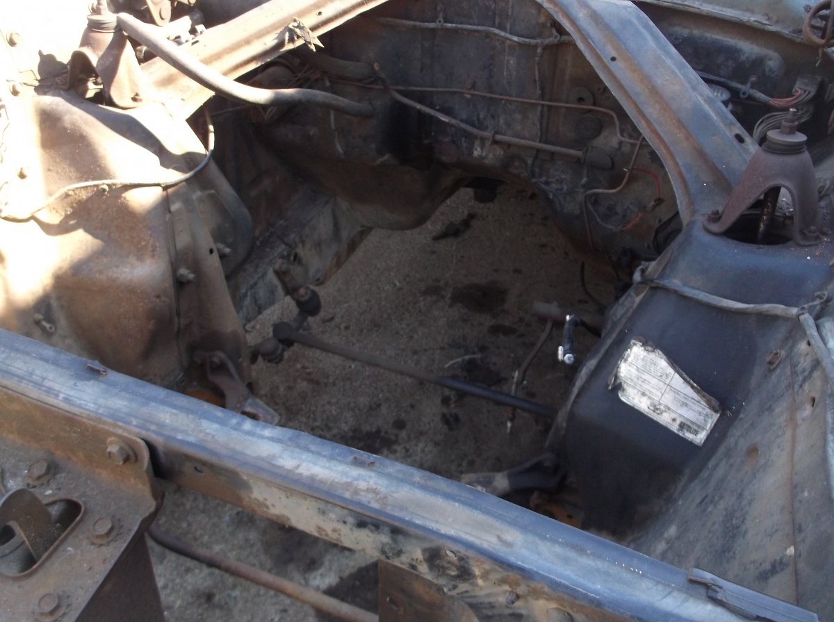

    The snow melted off the car this morning and the sun came out. It warmed into the 40's and I got the 6 cylinder and 3 speed out. Now I can get to work on building the car.
    does anybody need a good running engine and trans ? I gave the guy I bought the car from 2 weeks to come and get it . After that it's gone. Only got a one car garage so a lot of this work will be done outside. DSCF3619.JPG DSCF3620.JPG

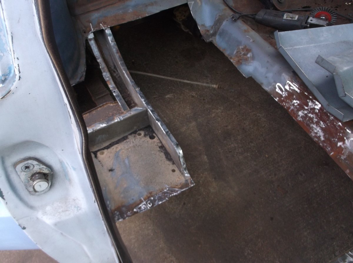

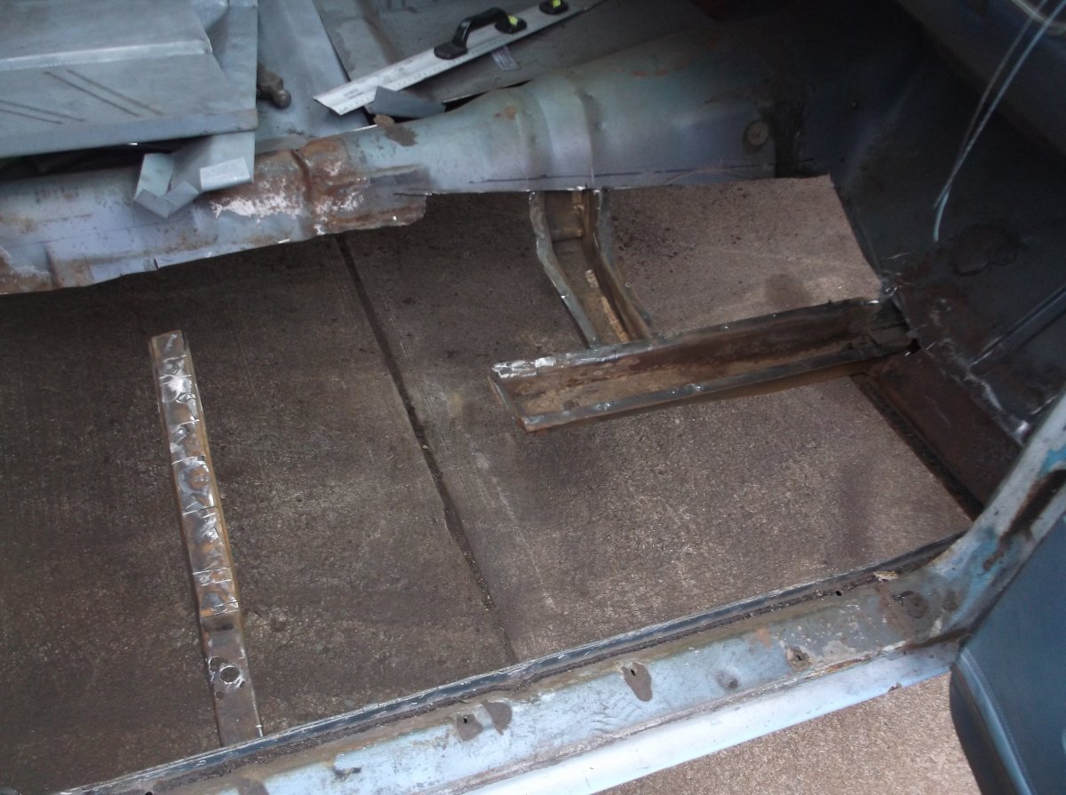

    As usual the day did not go as planned . There was way more rust in the floors than I thought.
    So I spent the day cutting and drilling out spot welds. I could have let some go . It's just a race car , but I just can't stand rust.
    After getting it all cut out I figured it would be a great time to make my subframe connectors That way I can do them standing up or at least sitting on the door sill. Got this far today. It might be a good time to move the rear springs in a few inches. DSCF3621.JPG DSCF3622.JPG

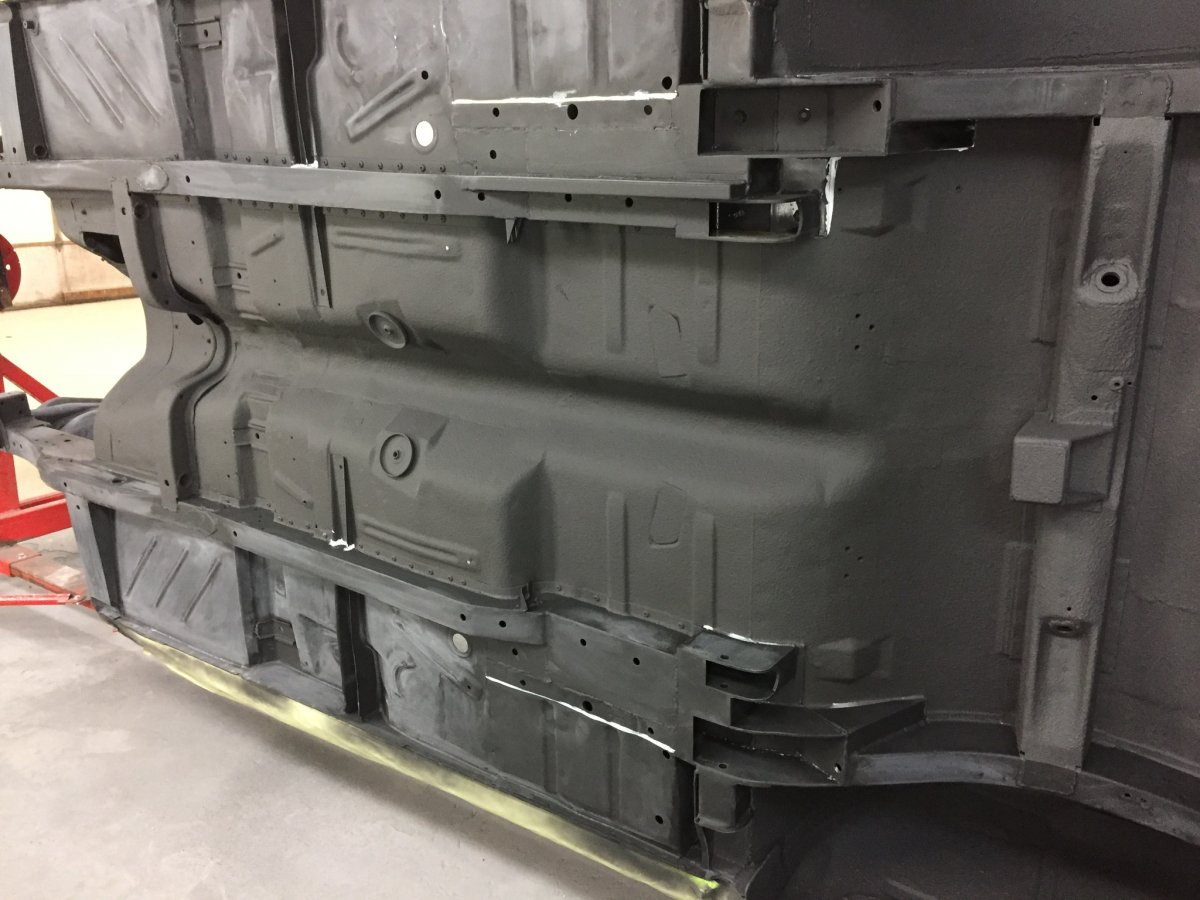

    I have been following your build, keep the updates coming. Attached are a couple of pictures that may give you some ideas on moving the leaf springs in. This is my ‘64 as shown in my avatar, (old photo) I also built tubular traction bars that run parallel to the leafs and swing the same arc so there is no binding though out the suspension travel. The subframe connectors are fabricated not tubing, I wanted them to follow the floor pan and not hang down below the factory subframes.
    Jim
    EE621689-8D70-4F35-9C12-C505DF44A387.jpeg 5E7B237F-3EC0-4302-B7C7-991CFC2A11D4.jpeg

    Thank you very much for those photos. I wish I had the capability to rotate my car like that but it will be on jack stands and on my back.

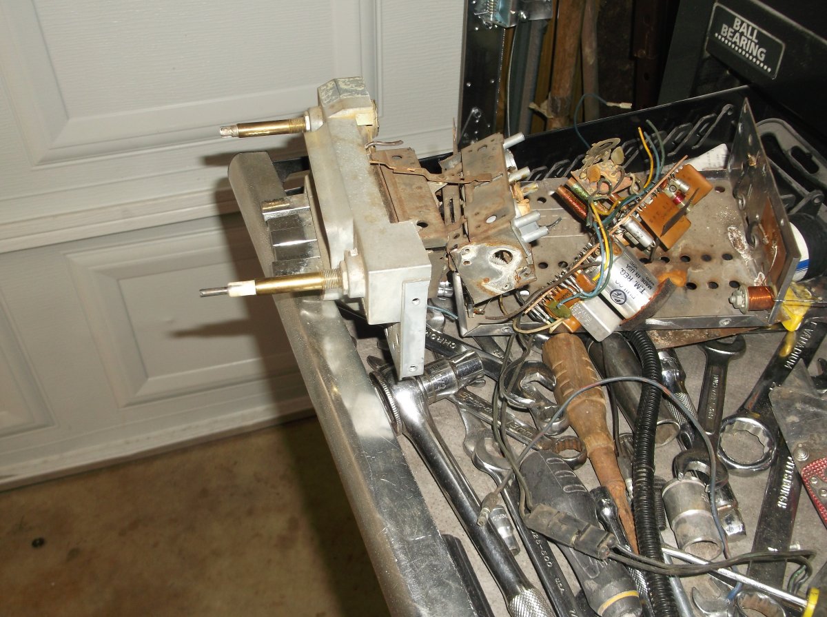

    Not much to report today except I got my front tires mounted up. I am gutting the dash. took the heater out today. Looks like a new heater core Free if you want it. I took the old AM radio out and did an old stock eliminator trick. take 3 lbs out of a steel radio. It didn't work anyway so I am taking out everything but the face preset the dial to 65 and removed everything behind the dial. Not going to buy a block off plate when this is free and takes about a half hour to do. Just have epoxy the ****ons in place. Weight comes off the front part of the car and it's high in the car. DSCF3623.JPG DSCF3625.JPG

    Finally had a day with no rain and got all of the rusty pans on the driver side cut out and found about 2 lbs of wet sand in front torque box and pin holes .So more cutting and welding. Not bad though. I have decided to move the rear springs inside the frame rail. It will give me 3 inches more tire clearance.
    I looked at Crites kit and for $ 230.00 I can buy a lot of steel. I should be able to build my own for around 50 bucks. I have way more time than money.
    I went to the steel yard and they want more for raw DOM tubing than I can buy a pre bent cage kit.
    That's crazy and I don't have to bend it.
