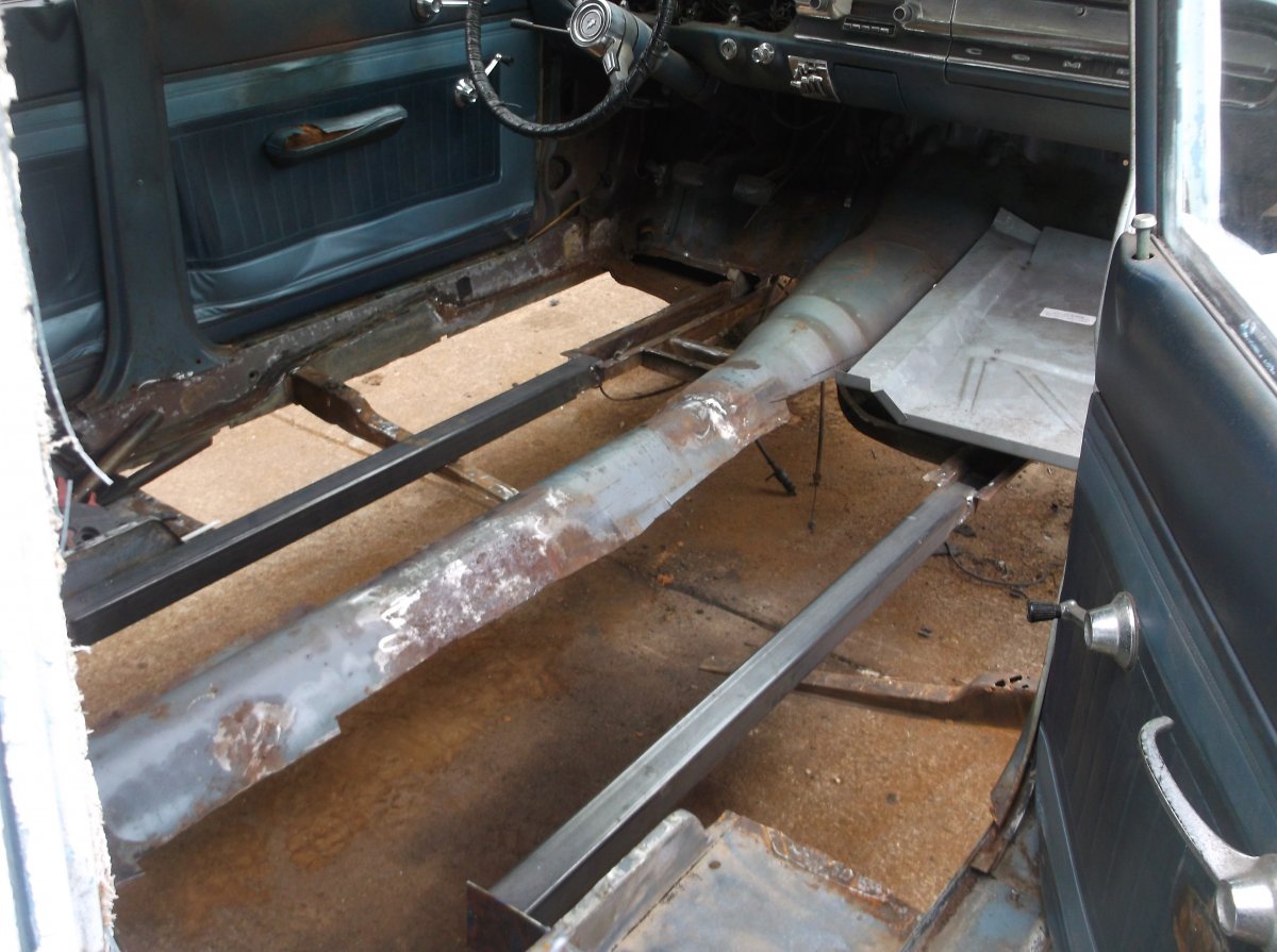

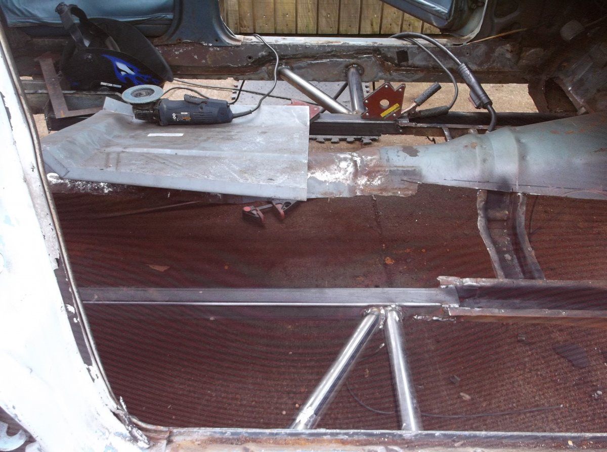

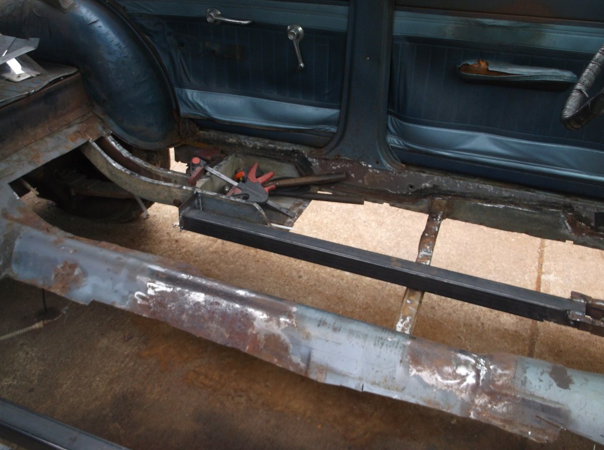

    Tied the subframes together. Still need to run some stringers to the rockers The plates that are welded to in the back are the start of the rear leaf spring mount when I move the leafs inside the frame rail. Still soaking the leaf spring bolts to get them out. DSCF3628.JPG DSCF3629.JPG

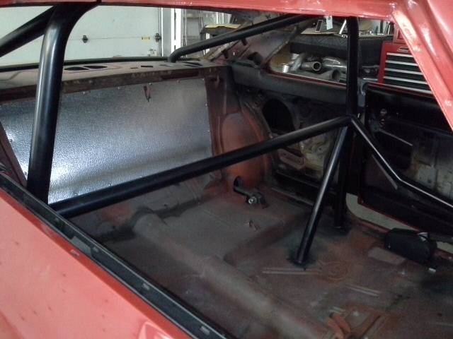

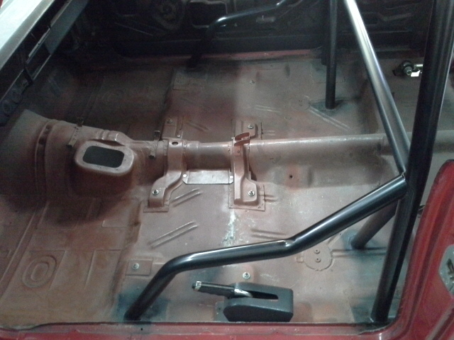

    Well I am using up some of my s**** roll bar tubing to brace up my subframe connectors.
    Something that most people don't do when building these flimsy unibody cars.
    Since I can't put a ch***is under it I need to make it as stiff as I can.
