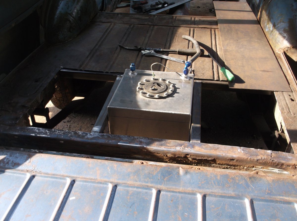

    I got my fuel cell mounts built today. I am looking for a vintage hard shell suitcase that will fit over the fuel cell. I am going to line it with Sheetmetal to be DSCF3632.JPG DSCF3633.JPG a legal firewall.
    Will bolt it to the floor and just snap it open and fill the cell . When done just snap it shut and it looks like I have period correct luggage for my 1/8 th mile trips.
    The back end will have either carpet or a rubber mat. Haven't decided yet.

    Build a sheet metal box over fuel cell with snap open lid & just throw a Amazon or Summit cardboard box overtop for looks. I am sure you have couple those laying around

    Pawn or antique shops may be your best bet to find an old suitcase. I think it's a neat idea! Who would think you'd have a fuel filler under a suitcase? Maybe even get a couple of small travel cases to bolt beside it for a ballast box!

    Being a station wagon how do you separate the fuel cell from the driver compartment? Or if you put the battery in the rear there is supposed to be a bulkhead to isolate the battery from the driver.

    RmK57 didn't you read the post about the Sheetmetal lined suitcase? It's a legal firewall.
    Don't just look at the pictures . Read the context and try and understand the reasoning behind how something is done.
    Actually The battery will be in the spare tire well and the spare tire cover will be Sheetmetal lined on the inside and carpeted to match the rest of the interior on the outside.

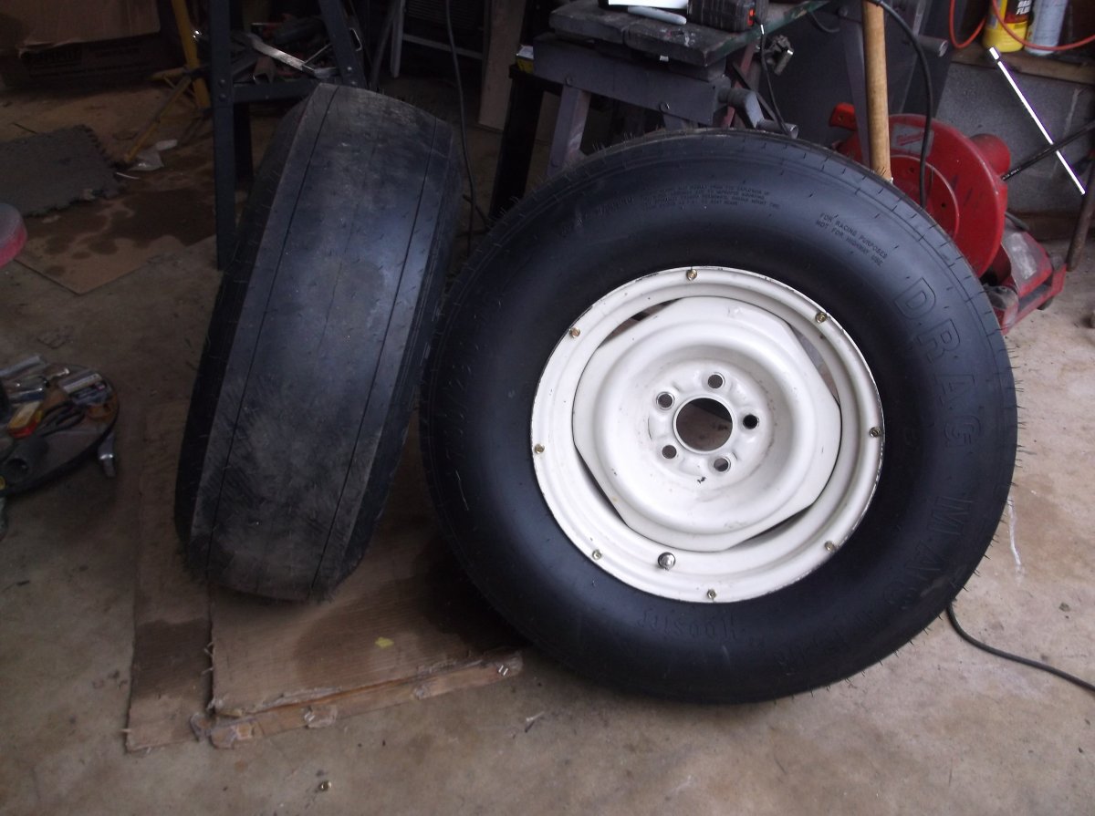

    yeah my slicks came in today so I got to drill 32 holes in my brand new old stock ford station wagon rims . These are the spec tires for the SEGA super stocks. 29x7 Hoosier Drag masters. DSCF3636.JPG

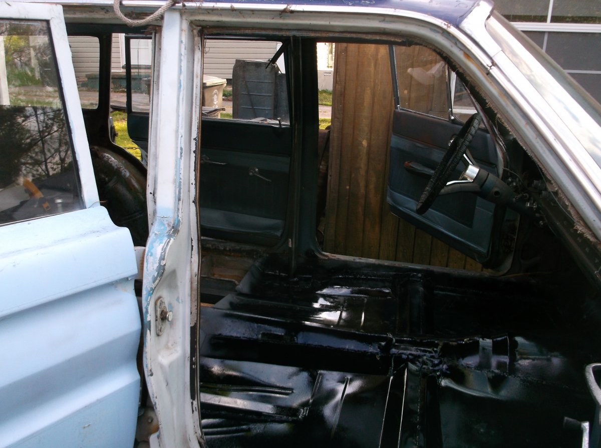

    Got the p***enger side front floor pan welded in. Got the drivers side torque box bottom welded in and was really moving along when a rental furniture company truck ran over my mail box and snapped the post off.

    Got a call from Hudlow axle to come and pick up my new axles. Progress keeps happening yesterday FedEx dropped off my Alston Race Cars 8 point roll bar.

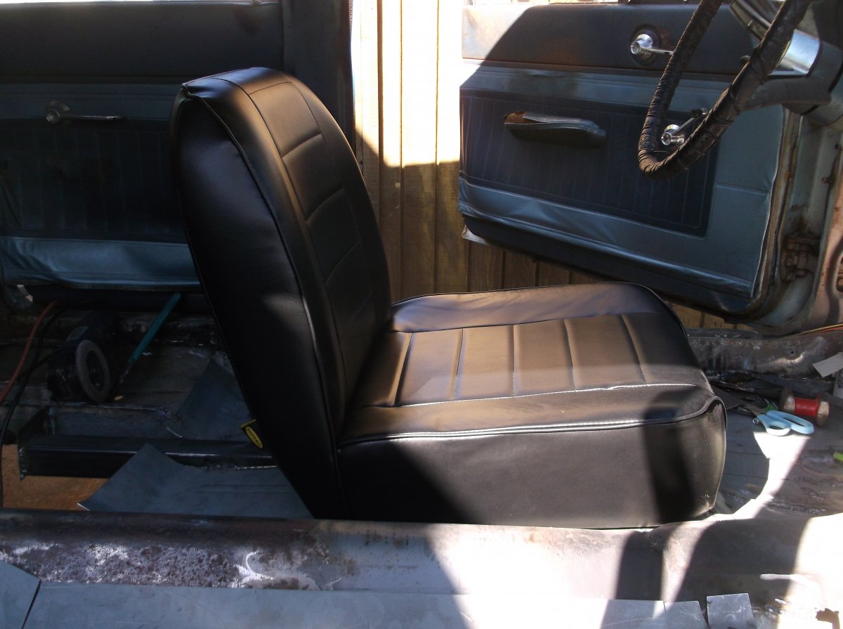

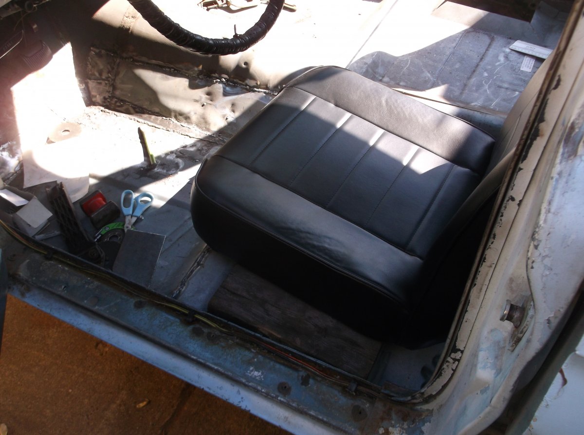

    Started mocking up my Econoline copy seats. Very comfy for race car seats. still some grinding on the welds. Hard to mig weld in the wind when it blows the shielding gas away. If it's not raining it's windy. DSCF3640.JPG DSCF3641.JPG

    Going to probably cut out a lot of the driver side tunnel to clear the Super Shifter. That's why I was not too particular with it. I will be making a cover that will be Dzused in after I get the trans in and the shifter mounted.

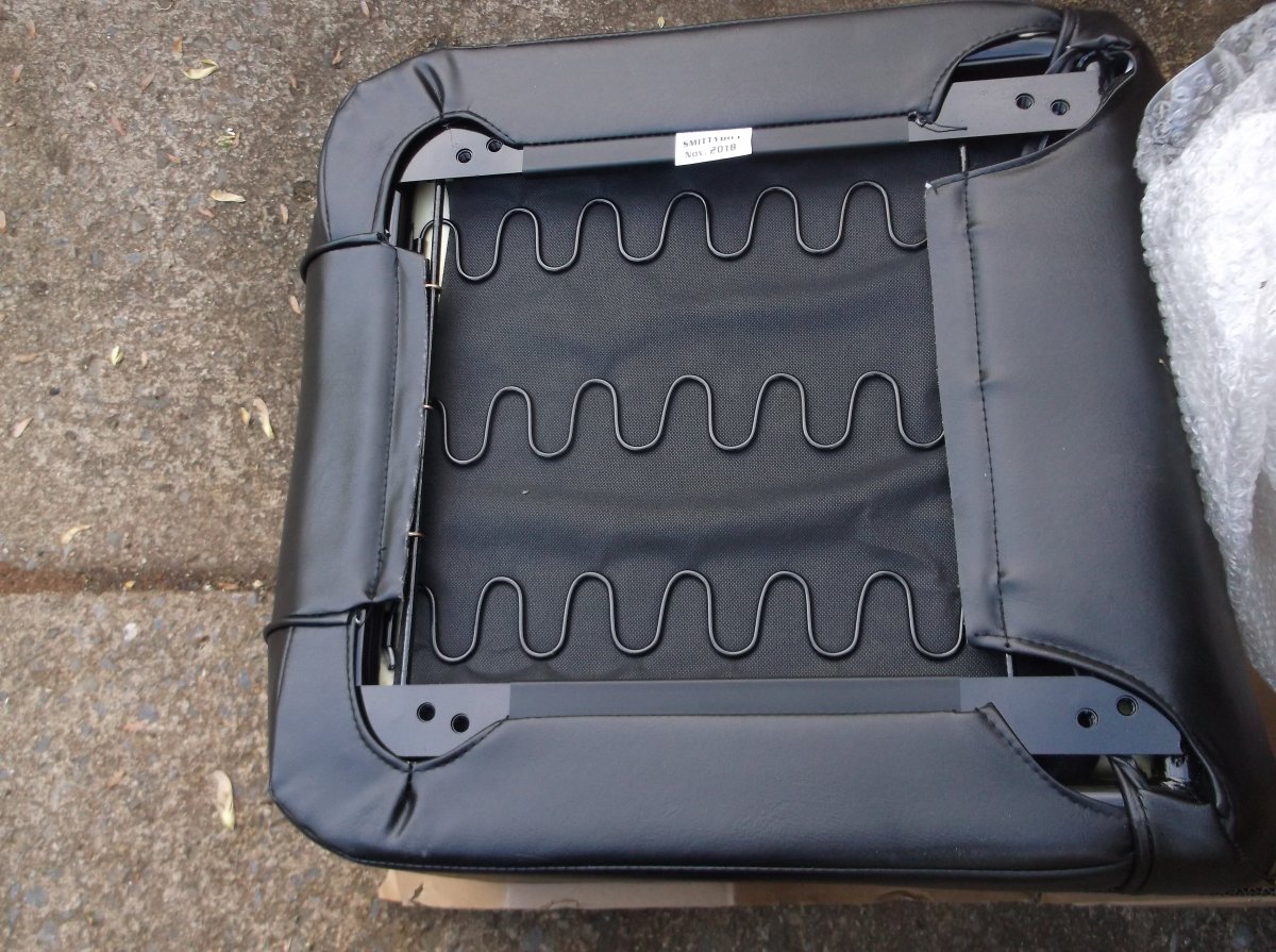

    Hey SC, any chance you could take a picture of the underneath of the seat and show what the mounting hole bolt spacing is? Wondering if They use the same mounts as the beat up Econoline seats I've got in my 48 Dodge.

    Racing Snake . I sure can. I have to work tomorrow morning, but when I get off work I need to measure the seats for the mounts I need to make.
    I will take a picture and give you the measurements. I think you can go on the Smitty Bilt website and get those, but I will post them anyway. the seats are for a 68-72 jeep.

    Racing Snake here are the measurements and a photo of the bottom of the seat.
    Inside holes front to back 14". Outside holes front to back 12 1/2 ".
    Inside holes side to side 13 3/8 " Outside holes side to side 13 3/4 "

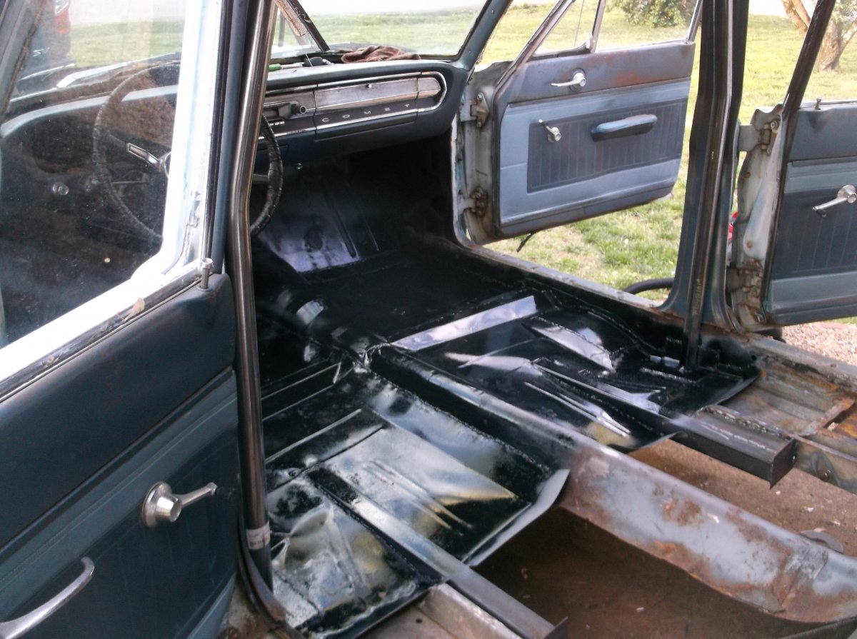

    After work today I got a little done . I got my main hoop for my roll bar in. The floors have been getting
    surface rust from all the rain and no door seals. So I shot some Rustoleum primer down and then some black spray paint that came with the car. there was a box with about 20 cans of spray paint. It's Fred's brand and says compared to rustoleum. they probably just put a different label on them.
    Doesn't really matter as it will get carpet DSCF3646.JPG DSCF3645.JPG per the rules. That or rubber mat. Now I need to trim up the back of the tunnel to match the front and finish the rest of the floor pans and start on the seat mounts.
