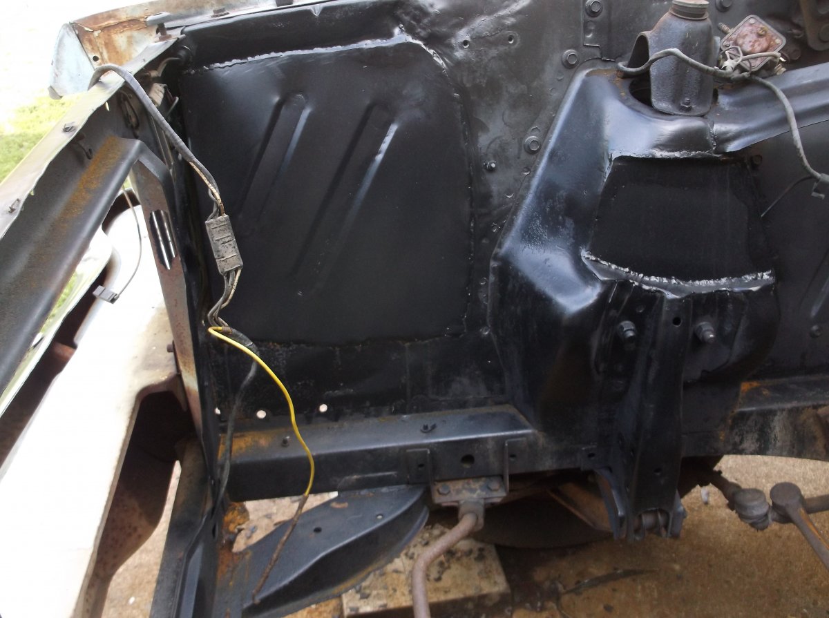

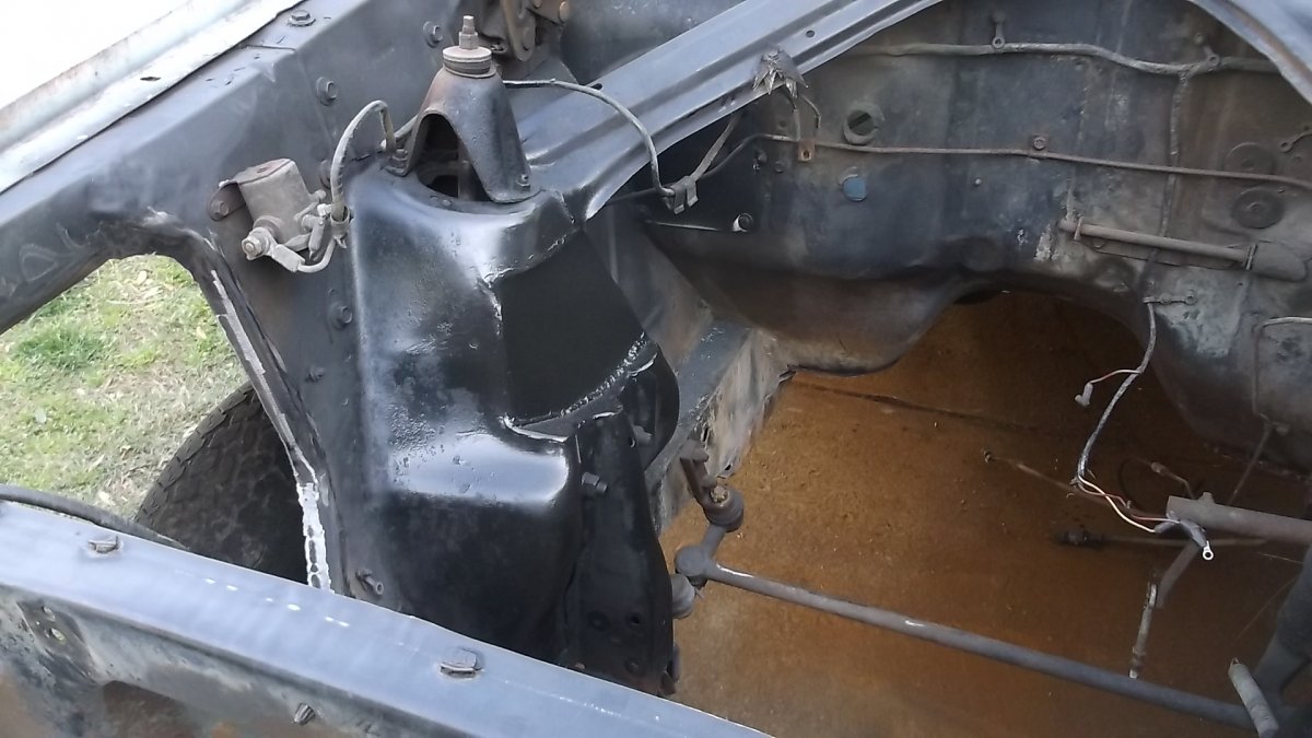

    This social distancing and people staying home paid off today big time. My neighbor saw me drag out my stick welder so I could tack my shock tower plates in. Should give me more header room and hand room to change the plugs. Might even be enough room for my FE swap next winter. A guy gave me a complete 410 the other day.
    He said what are you doing do I told him and he says I got an almost full bottle at the house. he left and in 5 minutes came back with the bottle on his shoulder. He told me to go ahead and use all I need.
    Tomorrow morning I will be able to exchange my bottle. I was able to get my shock towers done today thanks to my neighbor. DSCF3649.JPG
    Next is replacing the panel that used to be the battery tray that is now a big hole. Going to make a panel that will be bead rolled to match the panel on the other side.

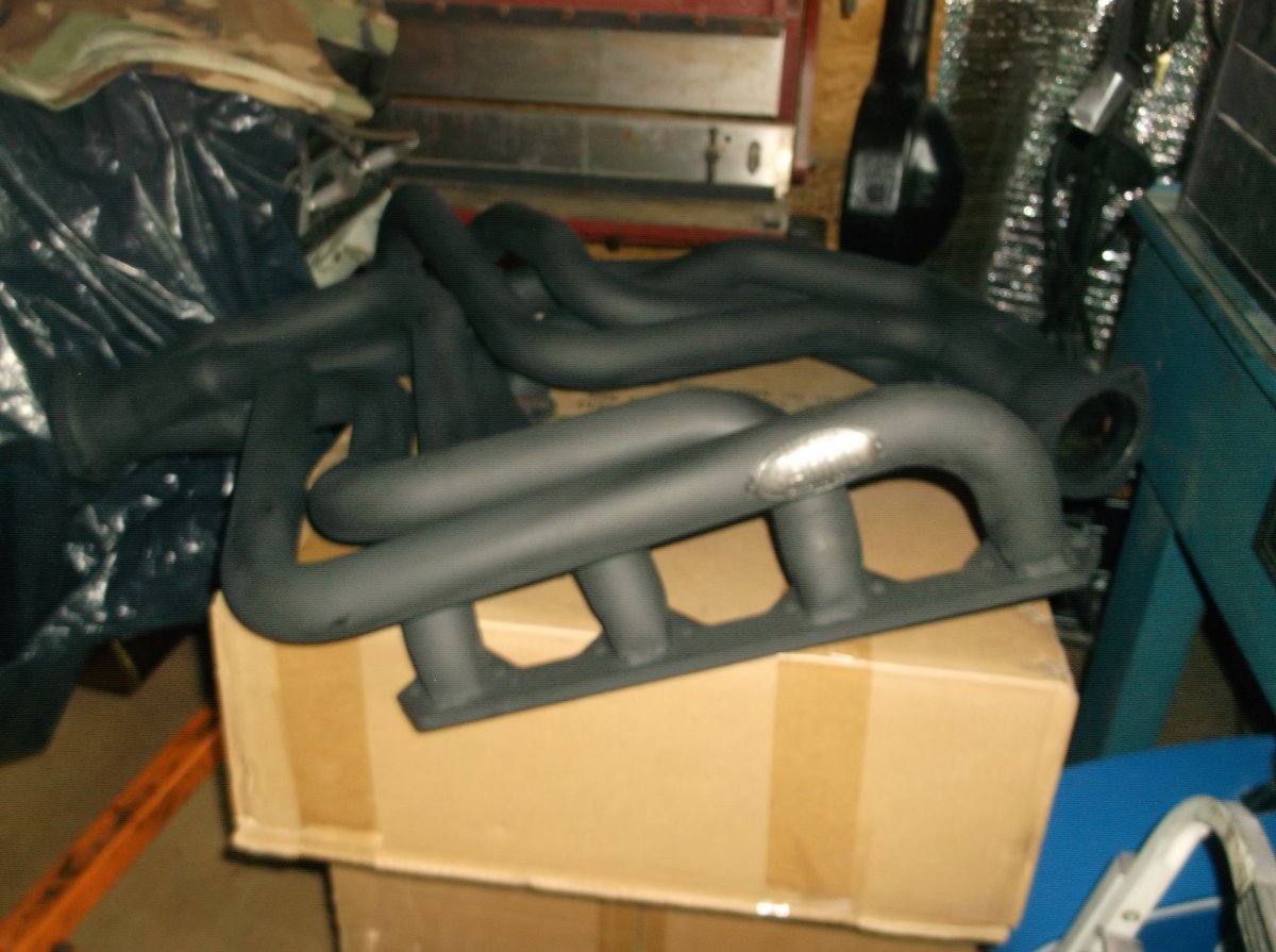

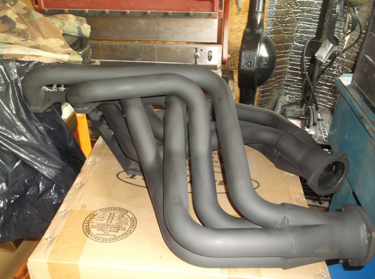

    Got my Dougs headers in yesterday. My line lock came today. Should finish the engine compartment by tomorrow. need to get my pressure washer out and blast all of the gunk off.
    got my battery tray replacement panel in today. Had to dig my bead roller out of storage. when you have a one car garage and a storage building and the car won't really fit in the garage you have to use a tool and then store it away until the next time you need it.

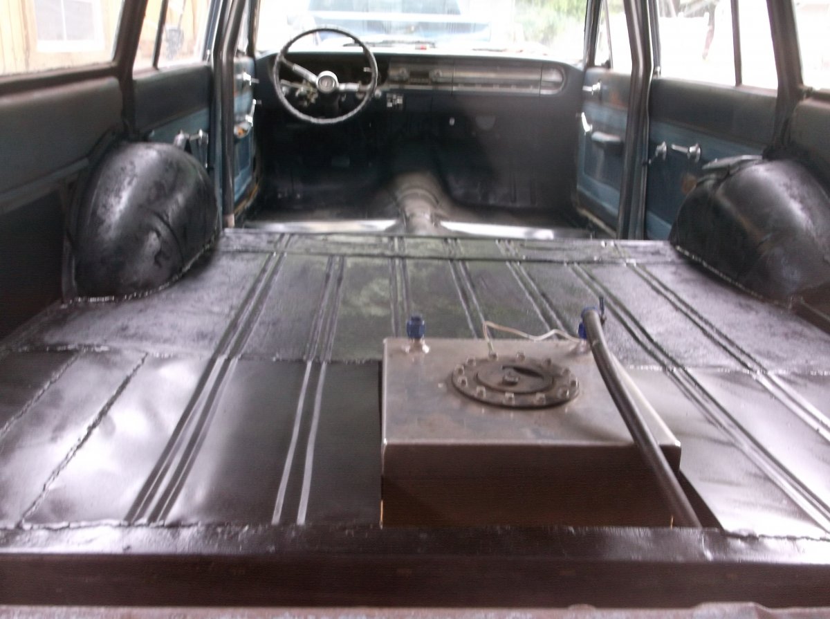

    Finally !I have chased the rust from the front to the back . Finally got the complete floor in. the section between the fuel cell and tail gate will be removable in case the fuel cell needs to come out.
    Now I can actually start to build the car. Next will be the seat mounts so I can figure out where my seat belt bar will go .
    50 degrees and rain and wind today. The driveway build is a little tougher today. DSCF3656.JPG DSCF3658.JPG

    About those shock tower plates........is that the max you can cut out and not interfere with the springs/shocks? Too bad you can't run coil overs or MustangII front! When FE timw rolls around....you gonna need all the room you can get!!

    You’ll be glad you trimmed those shock towers...I’ve got Dougs in my Falcon..that’s a tight engine compartment..and from what I could gather Dougs are the best...which is why ya pay more..but I couldn’t imagine trying to deal with cheap headers...
    I found mine on FB marketplace..brand new ceramic coated never mounted for $300.00 bucks..I couldn’t make the 2 hour drive quick enough

    I intend to sneak up on the shock towers . you know get hem used to seeing it now and then a little more later and then a lot more when the FE goes in. :D
    It was the only big tube ch***is headers I could find. Even the ****** super comps are 1 5/8 " primaries. I have been told they have interference with a Lakewood shield.
    The Dougs require a cable or hydraulic clutch which is no problem since I was intending on running a cable anyway. That's why I was going to build a set off fenderwell headers. Still might.
