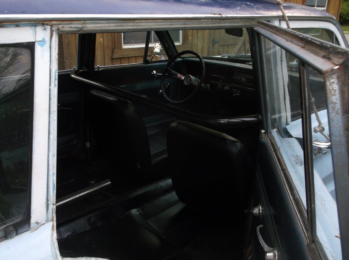

    Got the seats and my seat belt bar in today. I left enough room for a taller driver in case I decide to sell the car or I find a driver who can bring in some sponsor money.
    Dollars drive race cars not race car drivers.

  3. southcross2631
    Joined: Jan 20, 2013
    Posts: 4,412
    southcross2631
    catdad49, Dog_Patch, brianf31 and 9 others like this.

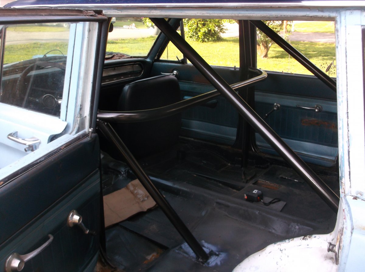

    Mike,
    Are your roll bar plates welded to the floor? Don't they typically p*** through the floor and get welded to the frame?
  8. southcross2631
    Posts: 4,412
    southcross2631
    The plates are welded to the frame channels and then to the fender wells in the back and the main hoop plates are welded to the floors and the rockers that are welded to roll bar tubing that run from the subframe connectors to the rockers .
    The short bars go to the subframe connectors. See the hole in the floor where the bar will go to the subframe connector when I get that side done.
    Remember this is a unibody car with no frame in the middle. It has one now though.

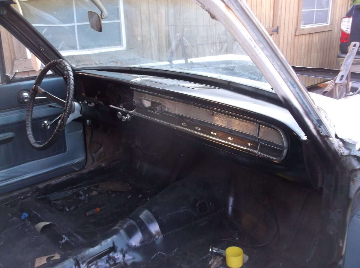

    Got everything that wasn't needed out from under the dash. the wiper motor , heater controls , emergency brake handle. Mounted my MSD box out of sight just like the rules say.
    Started the transformation from blue to black by painting the dash. Eventually it will be all black with gray carpet and an off white headliner. DSCF3663.JPG

    Got most of the interior metal painted black. Got sick of doing that today so I loaded up all of the old Comet parts and took it to the land fill. I tried to give them away and nobody wanted them so they had to go.
    Got my engine frame mounts painted and installed.
    Got one of my door bars made and tacked in . I put a bend in them because I am old and didn't feel like climbing over a door bar. A roll bar is not required so I am actually going way past what is required anyway. I got out my handy dandy Harbor freight bender and even showed my wife how to figure the bends.
    I also started on the remote shut off bracket mount combo battery box that will go in the spare tire well. DSCF3667.JPG DSCF3664.JPG

    Curious why you didn't use a swing out bar. The way their curved, in a forward impact the side bars would fold up like a piece of spaghetti. Anyway the cars coming along nicely.
