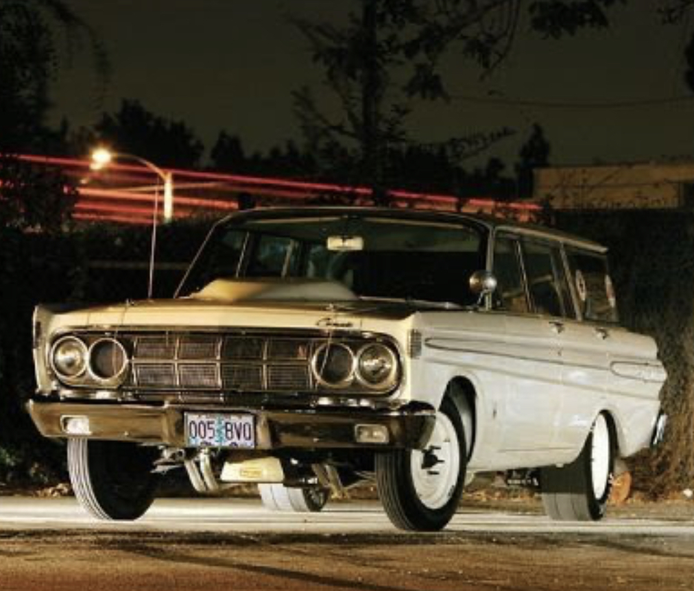

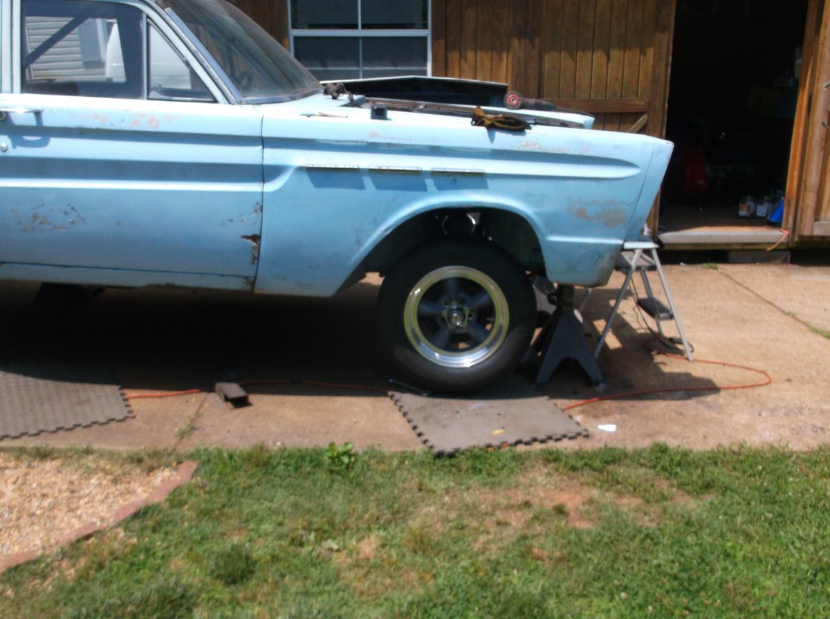

    That sure is. I got a little something done today. Got my rebuilt control arms back on and my 5 lug hubs on. just had to put a wheel on to see what it will look like. DSCF3679.JPG

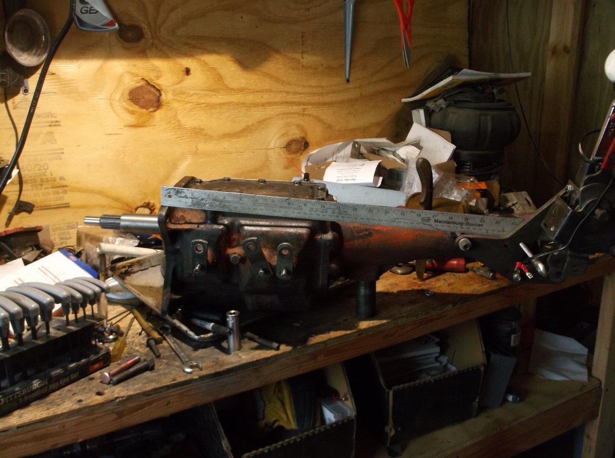

    Got my toploader back together today ! It was a pain after the needle bearings fell out of the cluster gear. I managed to grease them up and get them back in without taking the whole thing back apart.
    Now I need to build spacers for the shifter mount and get some heim joints so I can make shift rods.

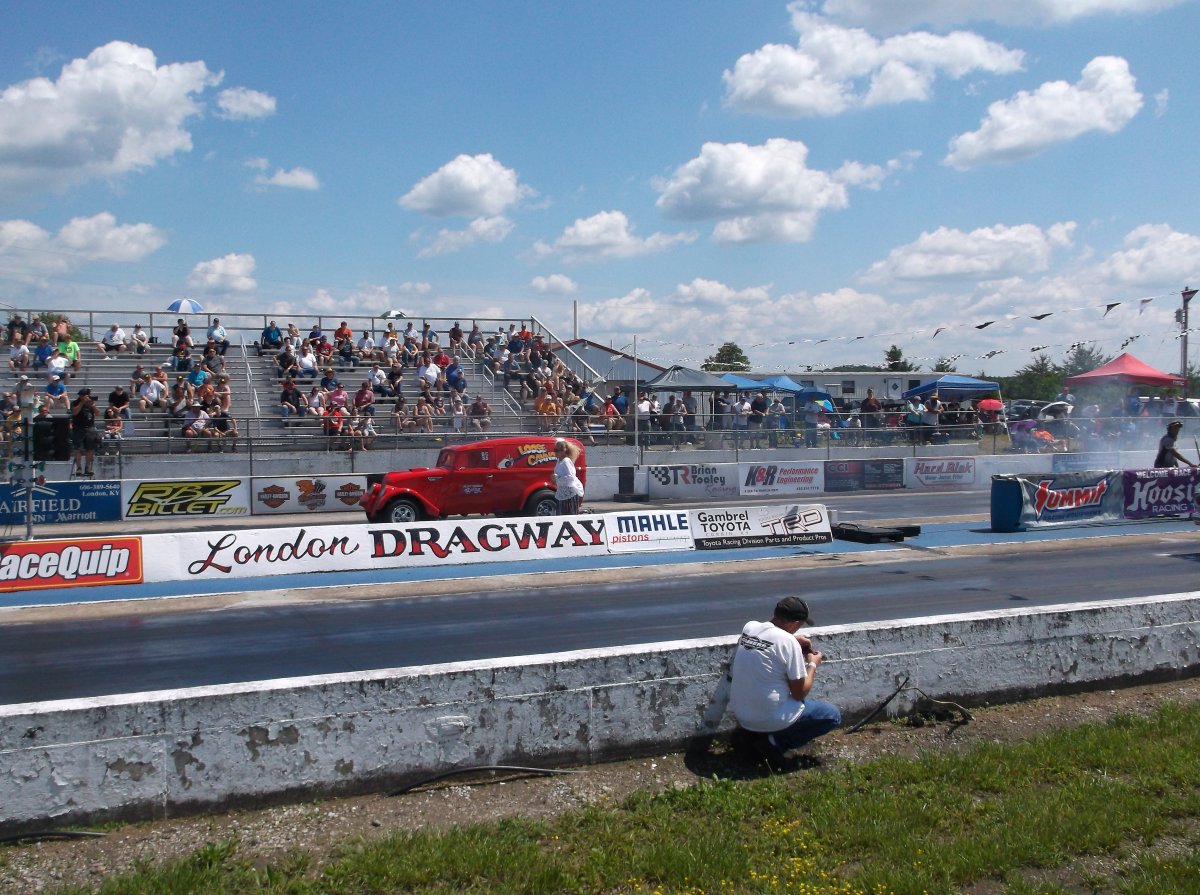

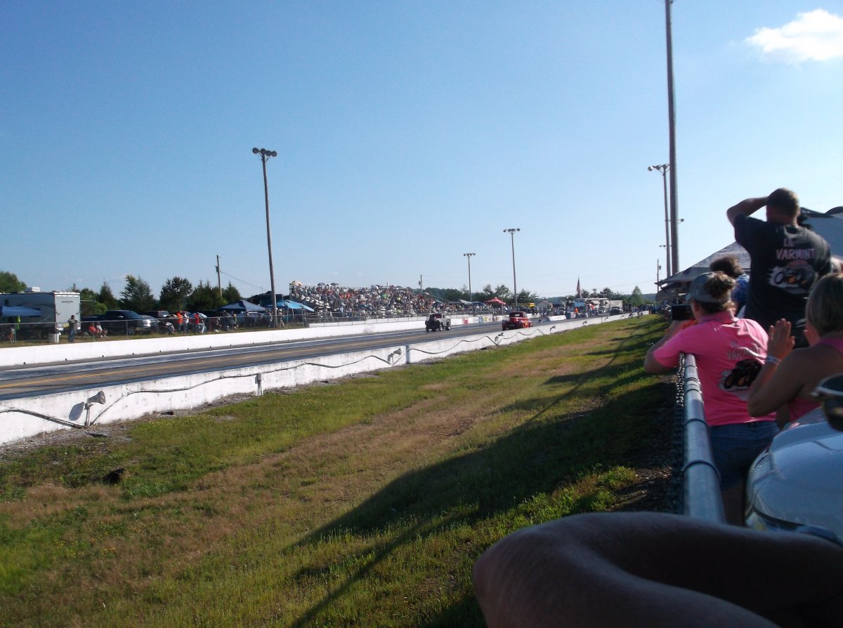

    A few photos from London Ky. How was the race ? I can describe it in one word HOT !! The weather was hot and so was the racing. A lot of new cars a lot of upsets and the future of the SEGA looks great . I talked to at least 5 guys building Super Stock cars and several racers building already for next year.
    They had 86 cars and Quain looks for 50 more by next season. For a lot better photos than I shot watch the SEGA home page and Facebook page for photos and video recap. Saw 2 people wearing masks and actually shook people's hands. It was a great time.
