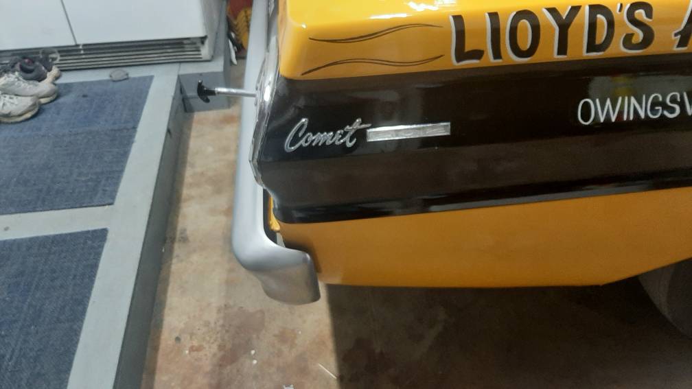

    Well we are back from the frozen tundra that is called Ky.
    We had a good time loading the car . My brand new winch jumped the spool and jammed the cable so Lloyd grabbed his portable winch and pulled it the rest of the way on trailer. I really did not want to to crank the motor in 37 degree weather and try and load it with a cold motor. It's hard on the clutch and the motor.
    We are home and the car already has the back bumper installed and the side trim . I had to make an insulator pad for mirror so I cut one out off some black plastic that I had. I got the grill installed. Should be able to have the front bumper and head light bezels on by noon tomorrow.
    Drained the radiator and need to drain the block to get all of the anti freeze out so I can refill it with water.
    Had to do some welding on my trailer as soon as I got home found a crack and rather than put it off I just dragged the welder out and fixed it.
    Will try and post some pictures tomorrow or Wed. Need to give the car a good once over ,clean it and get ready for this weekend.
    Lloyd is the man! If you have to drag your **** 5 hours one way it is worth it to know that someone sets a date and actually sticks to it.

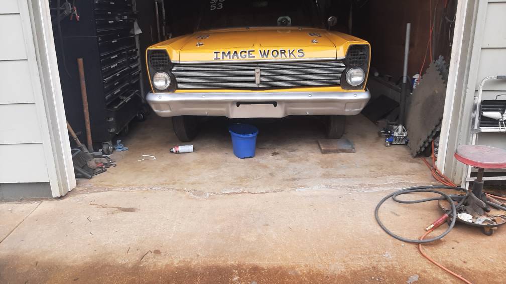

    Well I worked all day today on the car. I got the front end back together. Got the side trim on.
    I got all of the sanding dust out of the interior.
    Had to go harbor freight and exchange my winch for my trailer. Even though it was past the 90 day warranty they swapped it out no problem. I bought the extended warranty this time.
