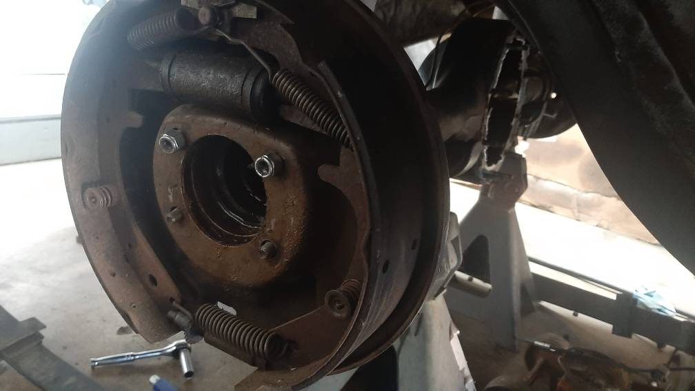

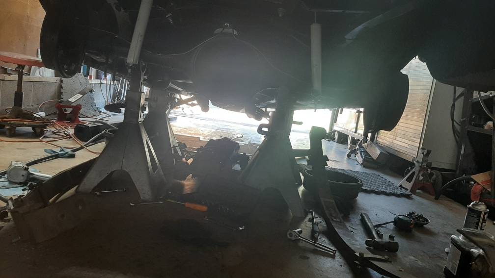

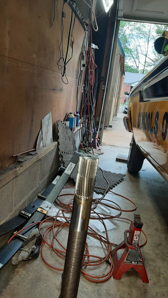

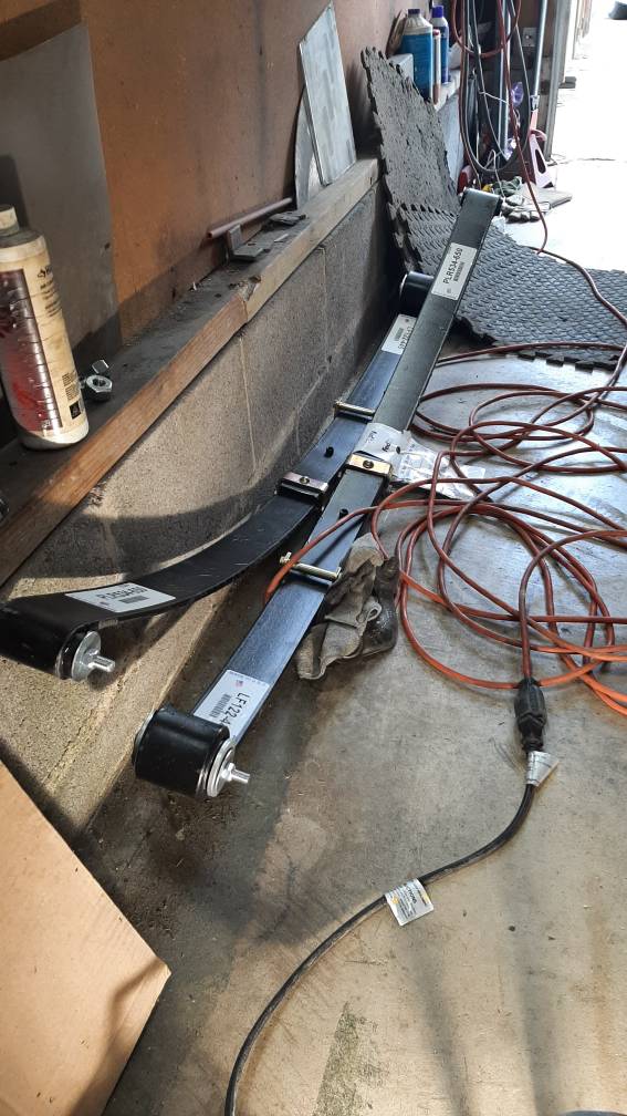

    Got my axles and spool to Hudlow axle in Chattanooga yesterday. They ***ured me that I would have new parts by next week.
    Got the old springs out this morning. Getting started installing the Calvert springs.
    Need to go to Seatons steel for some steel plate to build some new spring pads and shock mounts.
    Will be making a set of sliders to replace the shackles. 20210420_093408.jpeg 20210420_093319.jpeg 20210419_070728.jpeg
    Sent from my SM-A505U using The H.A.M.B. mobile app

    Talked to the tech guy guy at Calvert and we talked about my combo.
    He threw out some suggestions and I am going to try something.
    I will let you know when I get it back together.

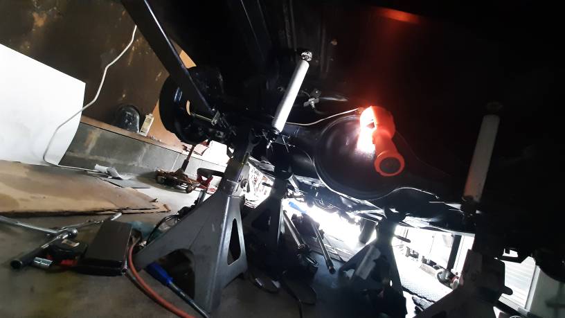

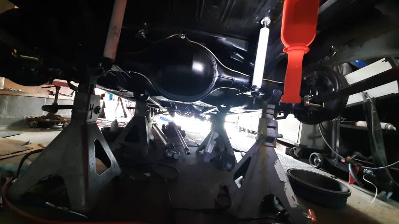

    Well I got my Calvert springs installed yesterday. Today I am going to weld in my new shock mounts.
    I have to wait until I get my axles and spool back before I can install the wheels and tires to set the ride height and figure out how much spacer I am going to need to install the sliders.
    I am thinking 2 inches, but it is very important with our ride height rule.
  26. southcross2631
    Joined: Jan 20, 2013
    Posts: 4,412
    southcross2631

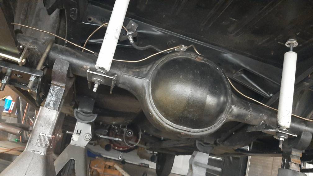

    Got my shock mounts done today.
  27. southcross2631
    Posts: 4,412
    southcross2631
    Forgot to add photos. I know you guys like pictures.
    I have changed my work schedule so we can attend the SNDR race at Crossville on May 29. Let's see if I can run against all of those automatic super stocks on a full tree. 20210424_154408.jpeg 20210424_154348.jpeg 20210424_093151.jpeg
