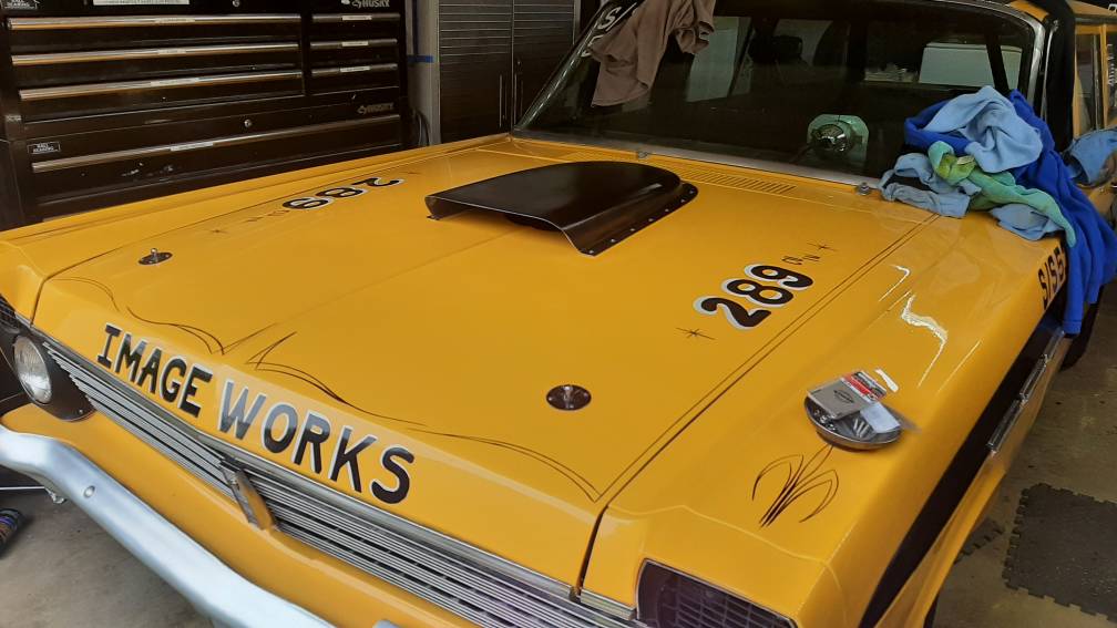

    The hole in my hood. The scoop mocked up. Got to sand it and paint it and bolted on. It came white. 20210514_163930.jpeg 20210514_181353.jpeg

    As soon as I can afford to buy a Crites hood with the Thunderbolt tear drop i will replace the present one.
    There isnt enough room between the carb and the hood to build a big enough air box to run the size hoses I need. The last time with 3 inch hoses were a restriction. Everytime you revved the engine up it sucked the hoses toward the carb. I need minimum 4 inch hoses ,but want 5 inch hoses.
    I hope this explains why I bought a 55 dollar hood scoop instead of a 500 dollar hood. Of course if you would like to help sponsor the car I can give you my address and you could call Crites and have it delivered.

    It's like you guys are in my head. Maybe that's the voices I hear. I just talked to my wife about shimming the back of the hood to get it up so the hot air can escape. Yes there will be an air pan and foam rubber sealing off the hood.

    This is not my first rodeo fella's. I bought a nice air cleaner base that has a rounded pan to help with air flow. I am going to a shop that specializes in foam they have different densities . So I can pick the thickness and density to make the seal . I will buy a block of foam and use my electric knife to form the piece that will go from the base to the hood.

    Hood scoop bolted on used stainless button head bolts and plastic insert lock nuts.
    Now I need to shim the back of the hood and go see the foam cutter shop. 20210518_092530.jpeg 20210518_092521.jpeg

    After bolting it down it made me wonder if it wouldn't have worked better if I had put it on backwards like a cowl induction hood. Of course the rules say no cowl hoods.
