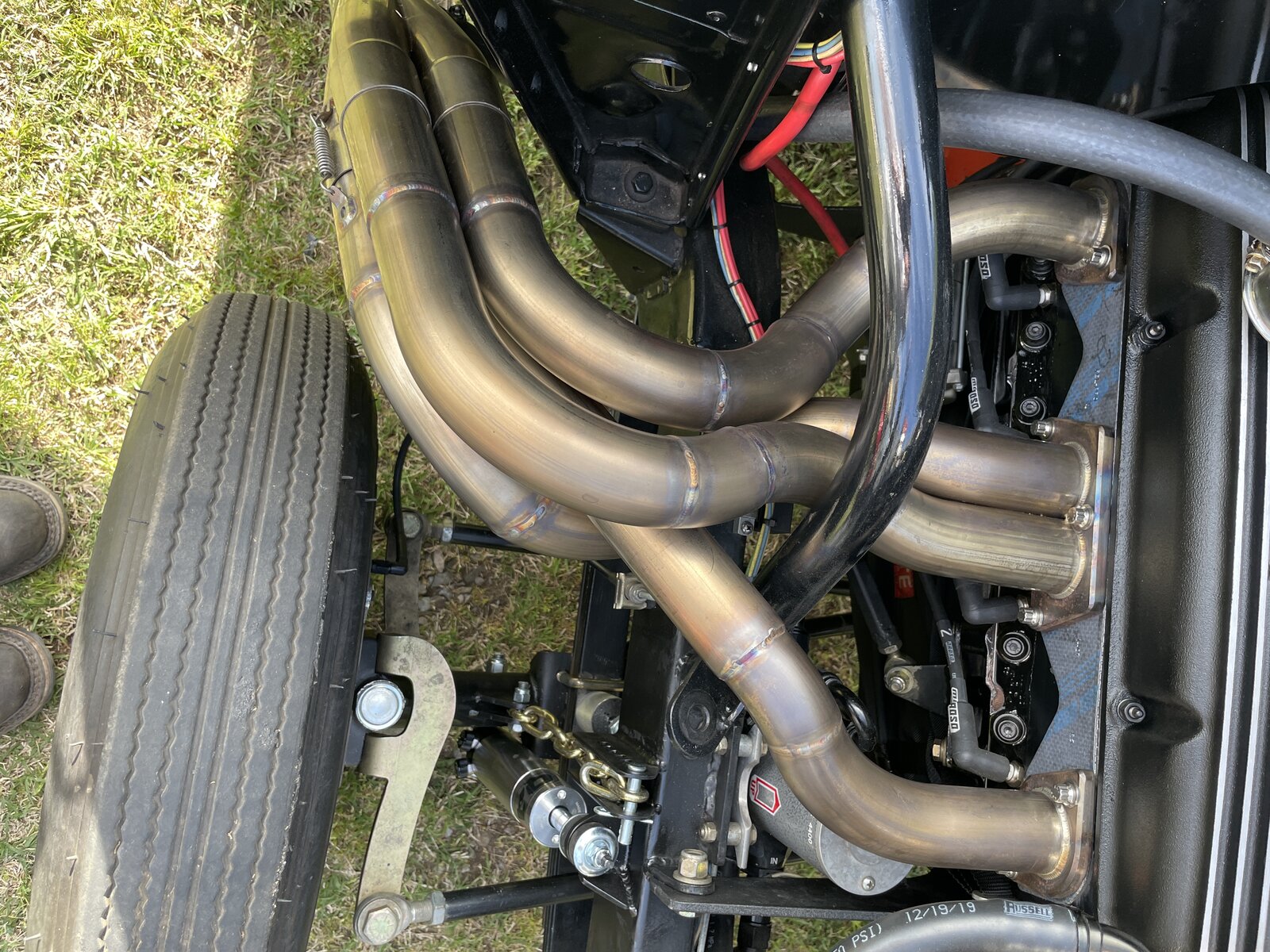

  11. I saw this at Shady Side last May. 3BA9EE03-8C93-4DA1-BAD1-09CE5F75A36A.jpeg Stainless steel, Tig welded, step design, high tech merge collector and CNC flanges. I’m thinking this guy has more loot in these headers than you have in your whole engine! I loved seeing it, wouldn’t look forward to running against it….
    But, then again, beating those guys is the BEST!
    Spoggie, bchctybob, Thor1 and 5 others like this.

    Yes I know exactly the 55 Chevy you saw those headers on. Last years B/Gas world champ and yes he does have more in those headers than I have in my whole motor.
