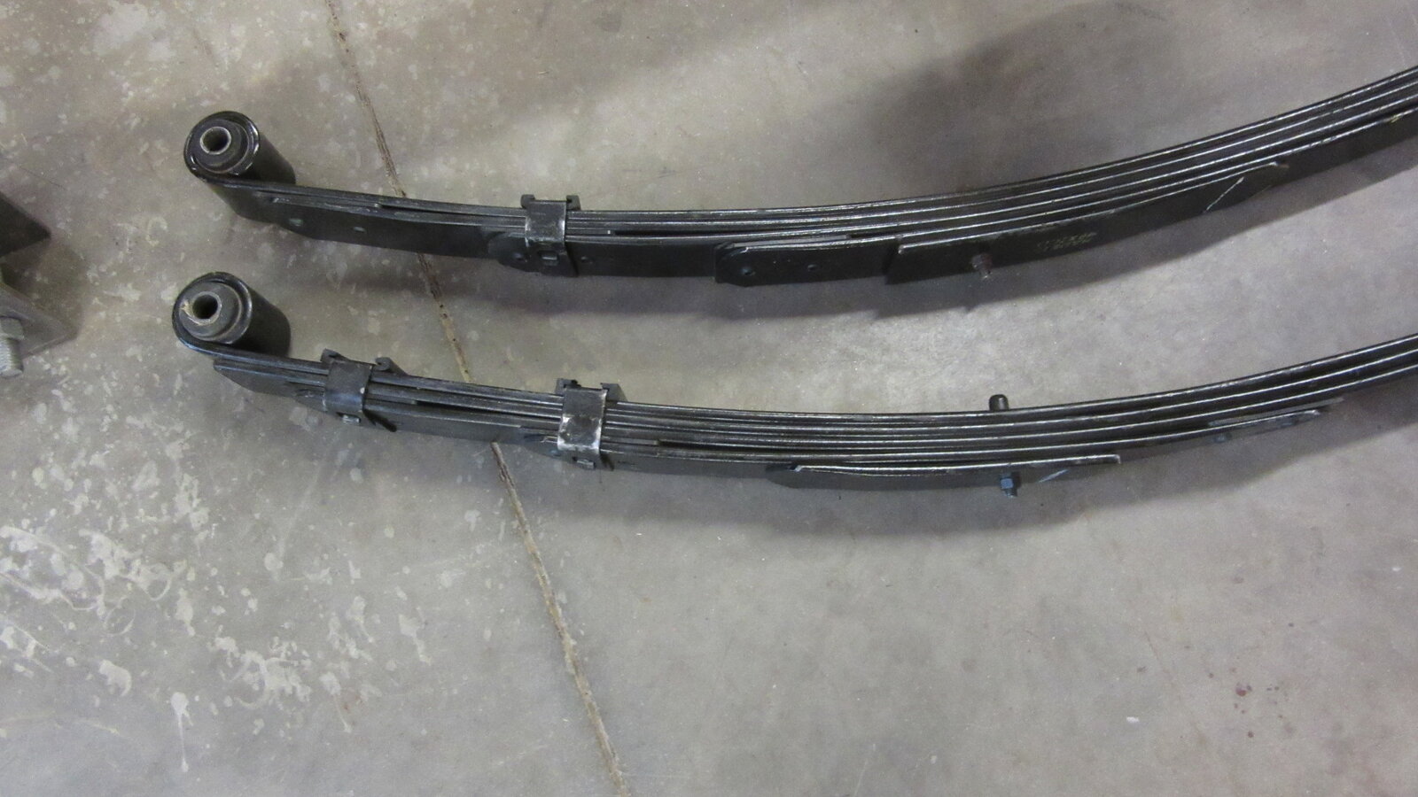

    I have tried the Chrysler spring route and I have a pinion snubber in the car now with zero clearance and a reinforced floor pan.
