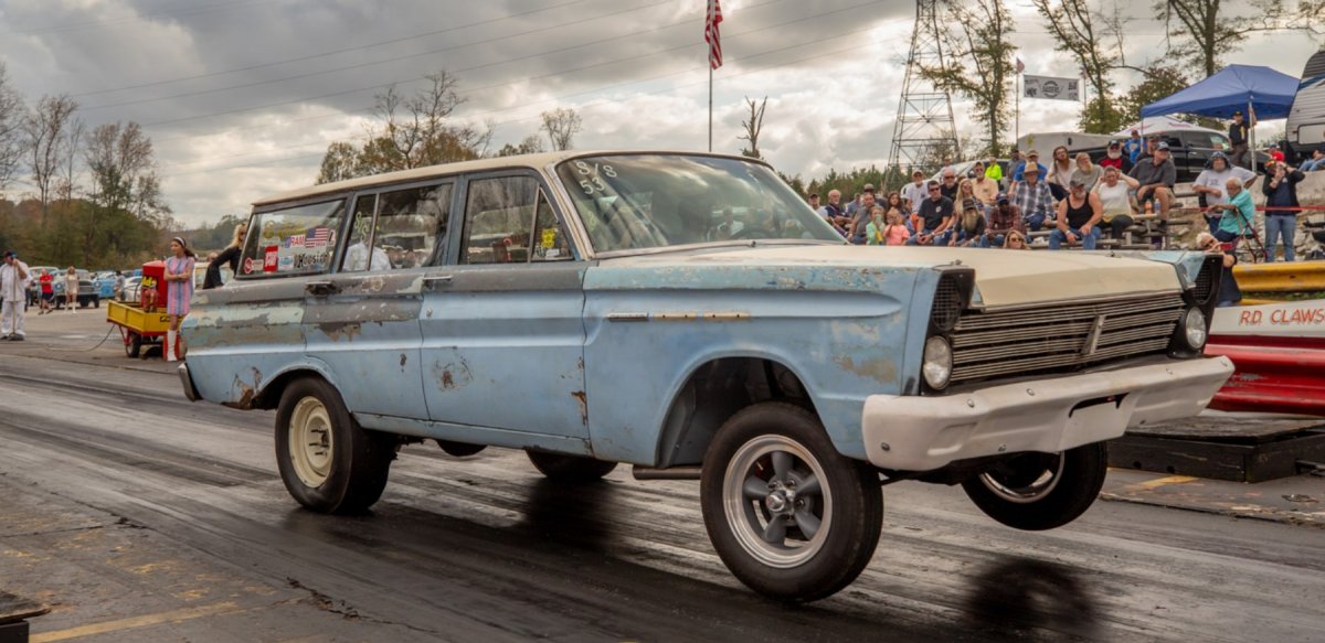

    Love that pic! Looks like it really hooks! Congratulations.

    With the way it's up on the rear tire, it looks like that snubber you made works like it should.

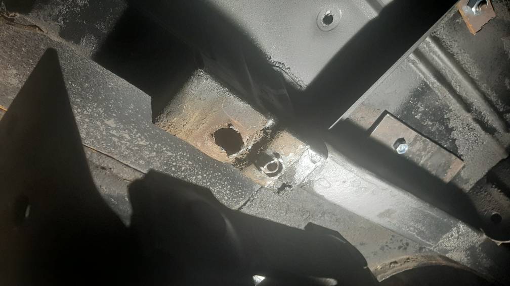

    Has anybody you know ever tore the rear leaf spring mounts out of the frame. Well I have. 20201113_191554.jpeg

    The way i was taught, is it's okay to tear stuff up if you're giving it hell brother!

    I have to work at the golf course this weekend, but I am going to try and build some plates to weld to the frame with some nuts welded to the plate so I can still unbolt the rear of the springs.
    I will probably put sliders on the rear of the springs over the winter. No time for that now I have to work too many days before we leave for Florida next Friday morning.
    If you don't break stuff you aren't trying hard enough. Going to try and attach some travel limiter chains on the front suspension before we go.

    Got my spring plate built yesterday and the leaf springs installed and the car back on the ground.
