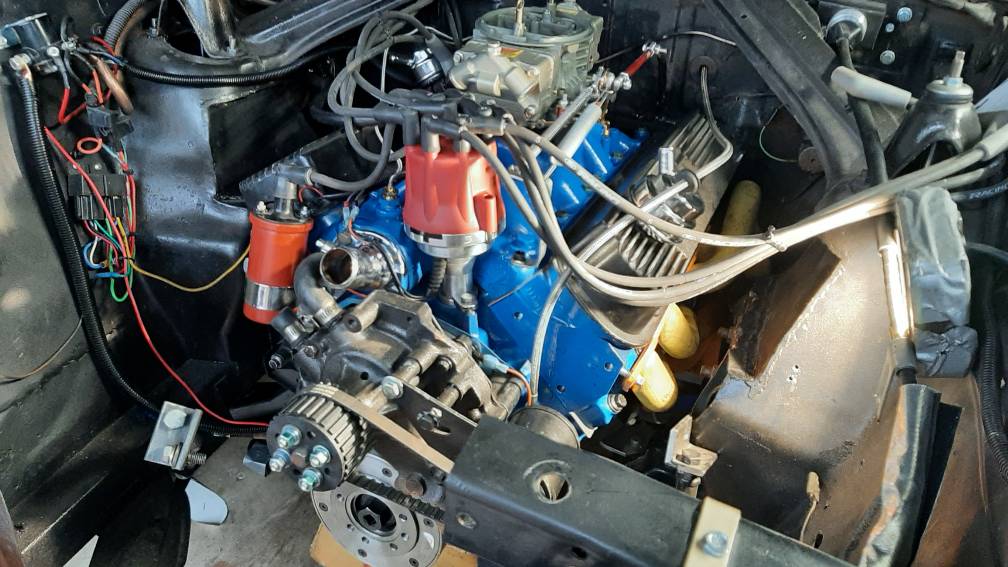

    What is blue and gives an old man a woody? A high compression small block Ford with a nasty solid roller cam and open headers 20210121_171906.jpeg

  25. 51504bat
    Joined: May 22, 2010
    Posts: 5,659
    51504bat
    Since your wife is so involved with this project as well, does a high compression small block Ford with a nasty solid roller cam and open headers give her a woodet? Just kidding. Engine looks good can't wait to hear about its shak down run.

  27. 51504bat
    Posts: 5,659
    51504bat
    Do you have to paint the distributor cap black?
    "SEGA requires red MSD caps get painted black. Go ahead and paint away."
    chryslerfan55, Thor1 and loudbang like this.

  29. southcross2631
    Joined: Jan 20, 2013
    Posts: 4,412
    southcross2631
    It is not an MSD distributor. It is a Jegs brand knock off. It works with a MSD 6al box. The cap is not as red as it appears in the picture. It is actually more of a maroon and so far they haven't said anything about me needing to paint it.
    If they say something then I will it's no big deal. The dist. actually works really good. I'm sure it is a Chinese made dist. Probably from Speedmaster , but it seems well made a has a nice advance curve that is adjustable or can be locked out. I like to have an advance so I don't have to get it spinning over before I turn on the ignition, it also keeps the plugs cleaner idling around the pits and on the return road.
