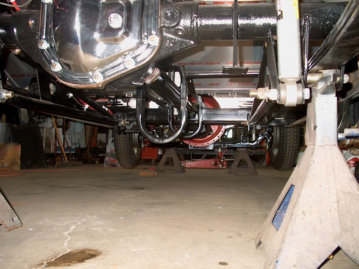

    New axles came in Friday. Got them installed, gear set up, drive shaft shortened and installed and brakes bled.

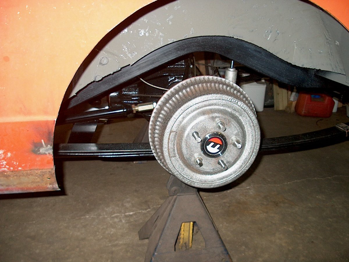

    Found myself needing a windshield, so this weekend I looked around and managed to score not only one but another one for a spare. Same guy had a rear gl*** I bought for a spare also. On these things, you can't have enough gl***. AXLE2.JPG REAR3.JPG

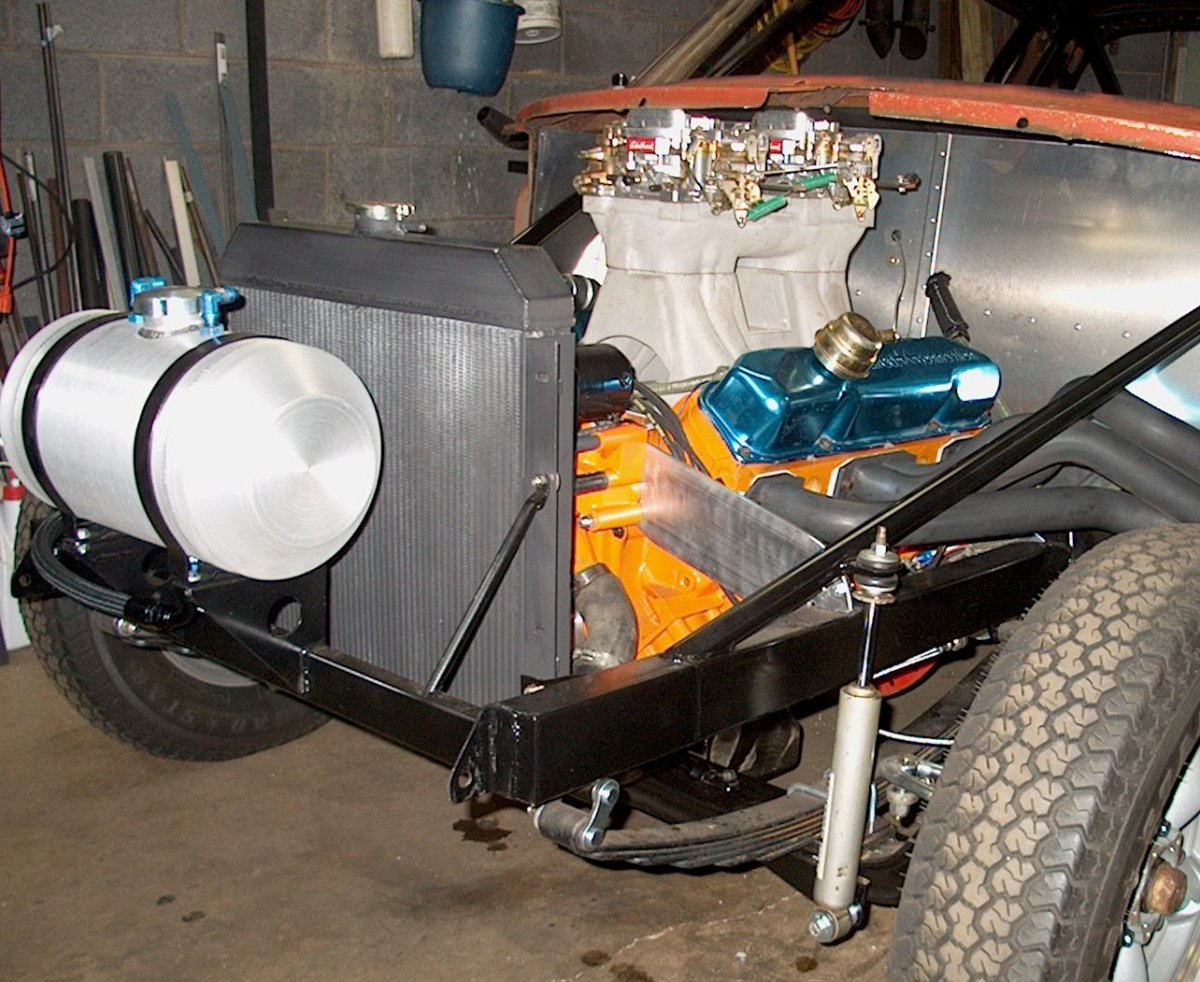

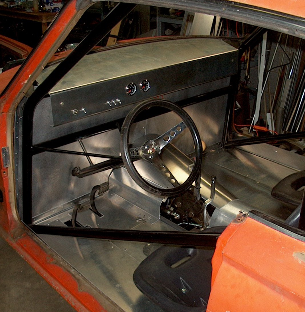

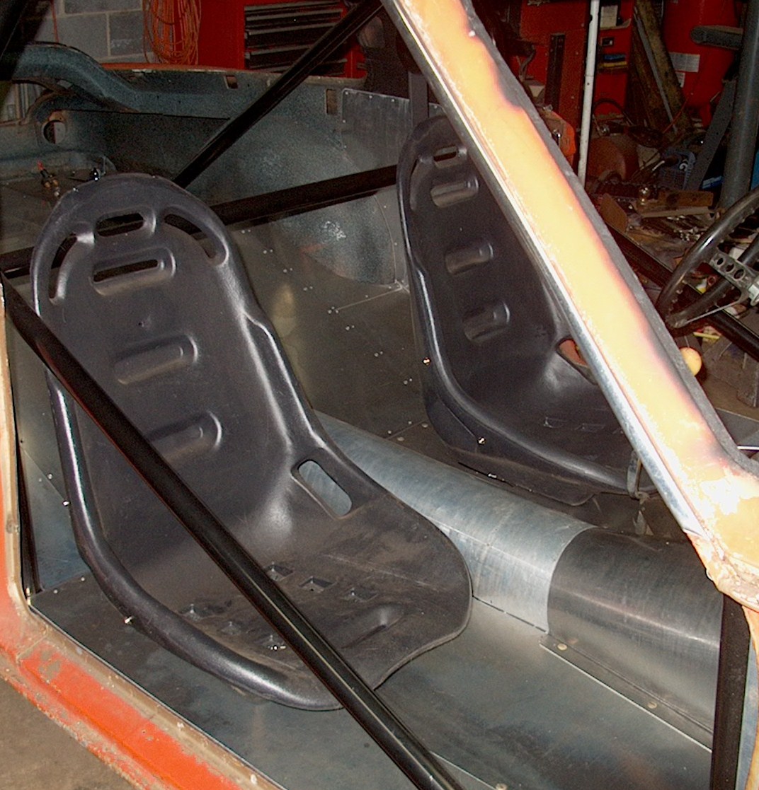

    Coming together. Engine ***embled and installed. Need to finish plumbing and electrics. Seats and headrest installed. Most of tunnel done, needs closeout for shifter. Dash installed and wired. Hope to get front and rear windows in this week and start on body work, weather permitting. Tons of obvious little stuff. I now have a side bet of a case of Moon Pies on whether or not it is ready for the opener! Inspiration! IM015077.JPG IM015075.JPG IM015078.JPG IM015079.JPG IM015080.JPG

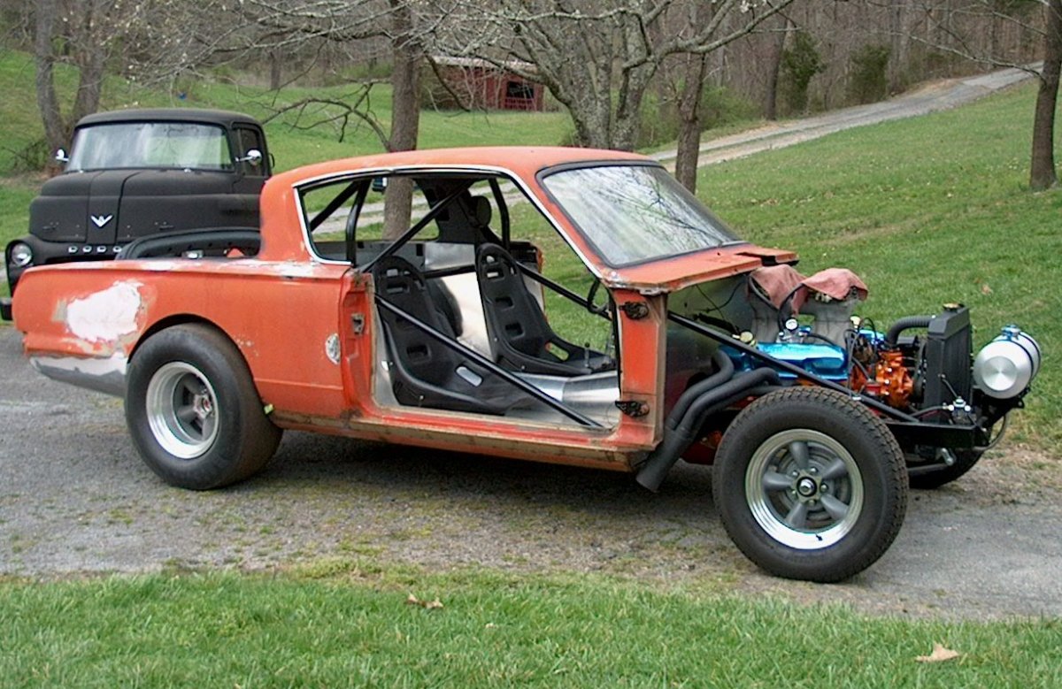

  18. HEMIBERT
    Joined: Jun 30, 2013
    Posts: 416
    HEMIBERT

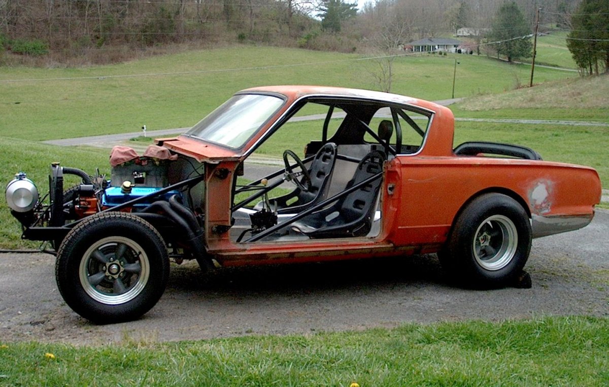

    After 5 months on build. OUTSIDE2.JPG OUTSIDE3.JPG Windshield in and outside for some body work.

    Not much in the engine compartment right now. Been close to 40 years since I ran a 4-speed. Don't need to re-learn on a really good engine. Just a basic 383. TRW 12.5 pistons, stock bore, stock stroke steel crank. Comp cams solid .557 lift, Crane rockers. 906 heads. Home made headers. Tunnel ram with 2 AFB's. Stock Chrysler ignition. Nothing fancy at all. It's easy to trick yourself into looking stoopid! Hoping to get down the track, get all the gears for a couple shows--then we'll talk.
    loudbang and AHotRod like this.

    I cut 5" out, re-welded it in a steel fixture and boxed the I-beam about 6" front and back of the weld. Shouldn't be a problem. The center of the axle takes the least stress, unless when jacking of course.
