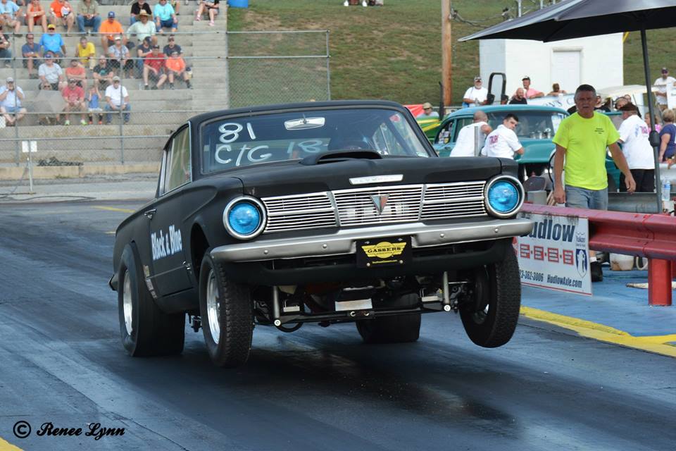

    I think you have the part about carrying the front wheels 1 foot covered. :)
  2. HEMIBERT
    Joined: Jun 30, 2013
    Posts: 416
    HEMIBERT
    That's a little too high. Makes a good picture, but if you're going up, you're not going forward. I'm going to start easing it down with weight. Wonder where the car in your photo is now?

    I know the g***ers like them high, but too high is too slow. 8-10" is plenty.

    I don't think I can agree with you on this one Robert. To be compe***ive in A/G you need to be about 7 to 8 tenths of a second quicker than the fastest C/G cars we have right now. I can guarantee that there isn't any wheelstands in C/Gas that are costing 7-8 tenths per run. Honestly, around 18-24" high and carry out about 60-90 feet is about ideal. Just look at the record setting NHRA Stock and Super Stockers and you will see that is about what they do. I have made runs where the front end barely comes off the ground and it isn't any faster.
    Yes.. when you get one 3-4 feet in the air it likely will hurt the ET some but I look at it like valve springs.. What it takes to compress a spring in power is given back on the back side of the lobe. I think you get some of it back as the car is coming back down. The thing that hurts a little is when you shift using the clutch so you do lose a bit of momentum with the clutch pedal depressed. But the fans like it and it is fun. Winning isn't everything... ;)

    I don't totally disagree with you Rusty. I think you and your car are perfection as far as wheestands vs speed goes. As I've said before, I like to judge mine by yours. I didn't say they could bring them down and win in A/G, just run A/G times. I run C/G times but am not compe***ive (yet). I also agree that the clutch kills the momentum, but the closer to the ground you are when you clutch, the easier it is to gain that momentum back. In testing, mine were getting too high and like you said, the clutch kills it. I was getting up in the 3-4' range and wasting the momentum going up, not forward. In a perfect situation where everything is right, moderate wheels up is good. Means more weight on the rear tires=more bite. Very few are right though. Those are the ones, like myself, that will go faster by bringing them down. No, winning isn't everything, but it would be nice once and a while!

    Based on the pic and what you said if you could take about 20 to 25 lbs from the rear of the car and bolt it as far forward as you can it would probably put you where you want.

    I've done almost that. I've already added 20# to the front frame rails forward of the axle, but didn't take any from the rear. No place to test over here before Myrtle Beach, but can easily add another 20 that I'll take with me. I'm plenty light, so I can now tune with weight. I listened to an interview you gave somewhere and I believe you said that's how you did it. My biggest downfall this year has been the lack of testing opportunities. We'll do better next year. The Carolina side of the mountain starts real early, so we'll be ready.

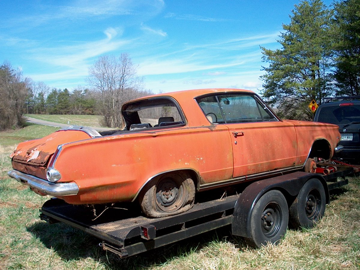

    It was one year ago today, 10/10/15, that we started this project. Then and now pictures.
    Been a long and bumpy road, but we are finally seeing some real results. Not as easy as I
    thought it would be though. I was going to come out and kick some ****, instead I got
    my **** handed to me! Don't regret a minute of it though. We learned so much for next year
    and met, without a doubt, the best racers on the country. Looking forward to next season
    with a word to my new friends--We're moving forward, not backwards!
