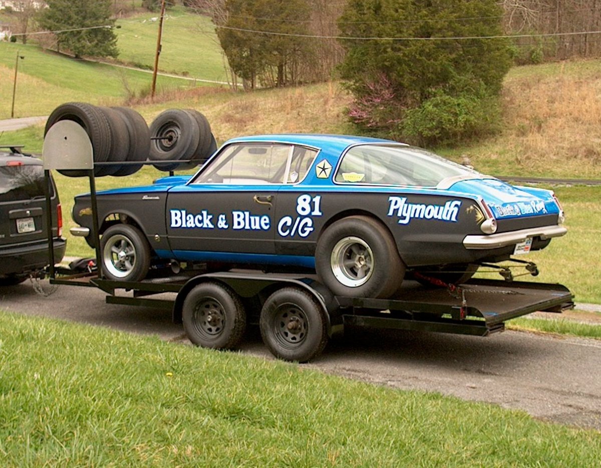

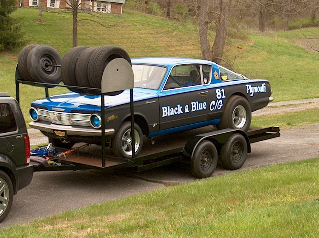

    Robert, do you know how good your car looks now with the blue on it. Everybody is really stepping up their game for 2017 in the looks department.
    I hear your stepping up the performance department also. I'll have the scales warmed up for you this year.

    Car looks great. Love the name as well.:D:cool:
