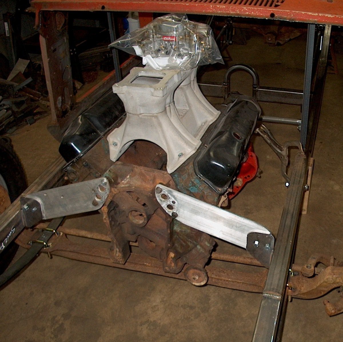

    Plans for engine setback?
  10. HEMIBERT
    Joined: Jun 30, 2013
    Posts: 416
    HEMIBERT
    As far as I can and still be practical. I'll see where the shifter handle winds up.

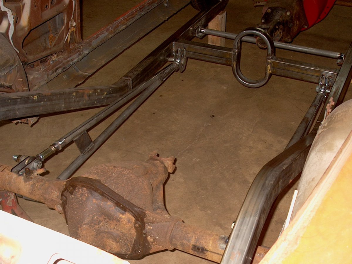

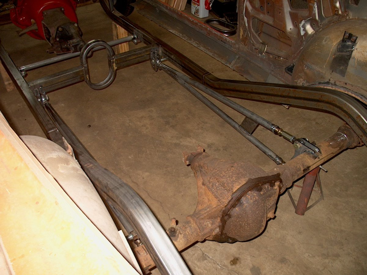

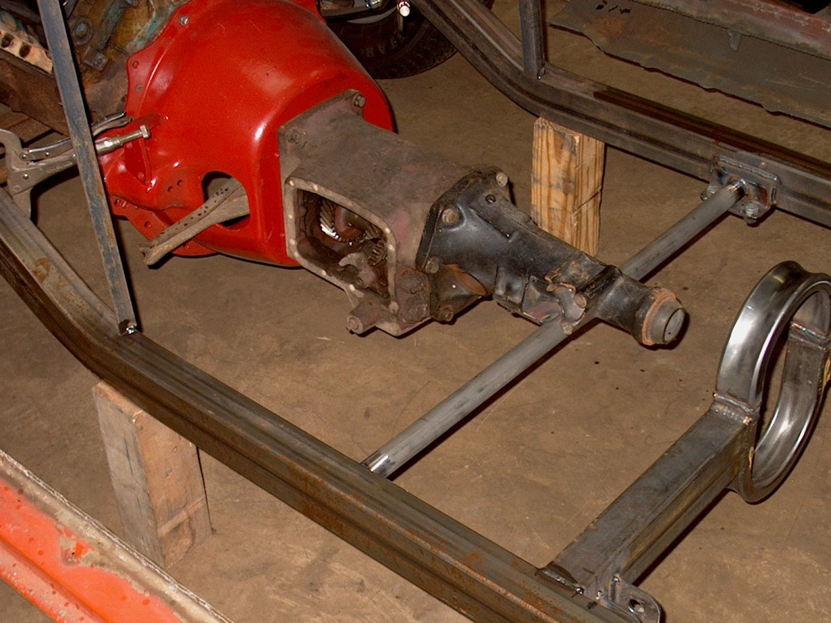

    Had a good week. Put together frame rails and located them in the body. Made the ladder bar x-member/drive shaft loop and located it in the frame rails. Then built the ladder bars, narrowed the rear end and attached them to the x-member. Temp installed the front axle. This got enough stuff installed to set frame and rocker panel heights so as to set engine in frame at proper crankshaft height. Then built and installed transmission x-member.

    I did not get near what I expected. I don't want to cut the cowl area at the base of the windshield. Just a personal prefrence. When I switch to the injectors, it would leave a big hole to fill. Barracudas seem to be arranged a little different than others.
