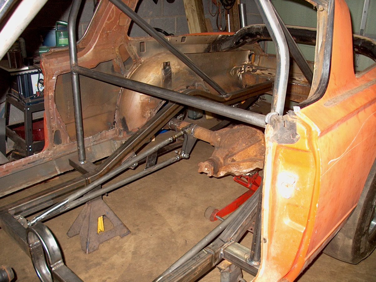

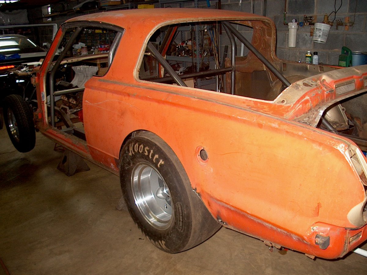

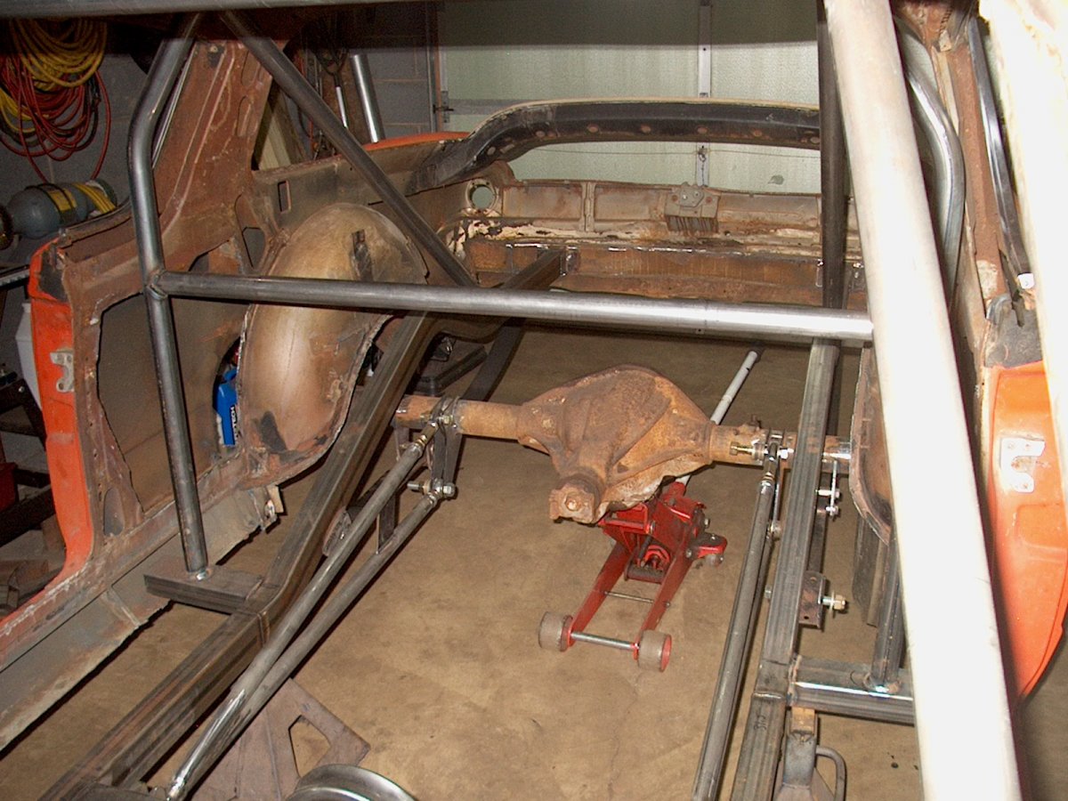

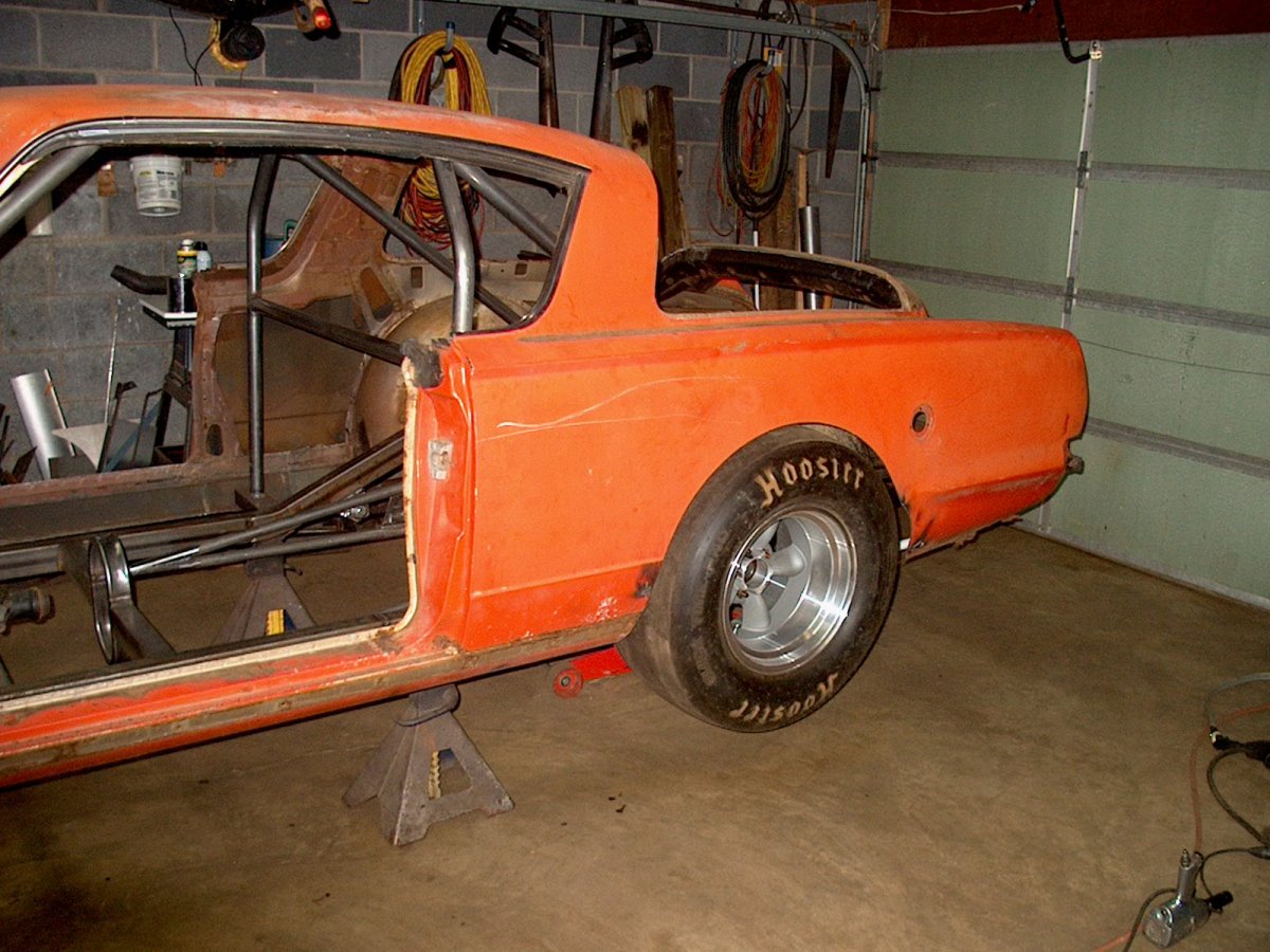

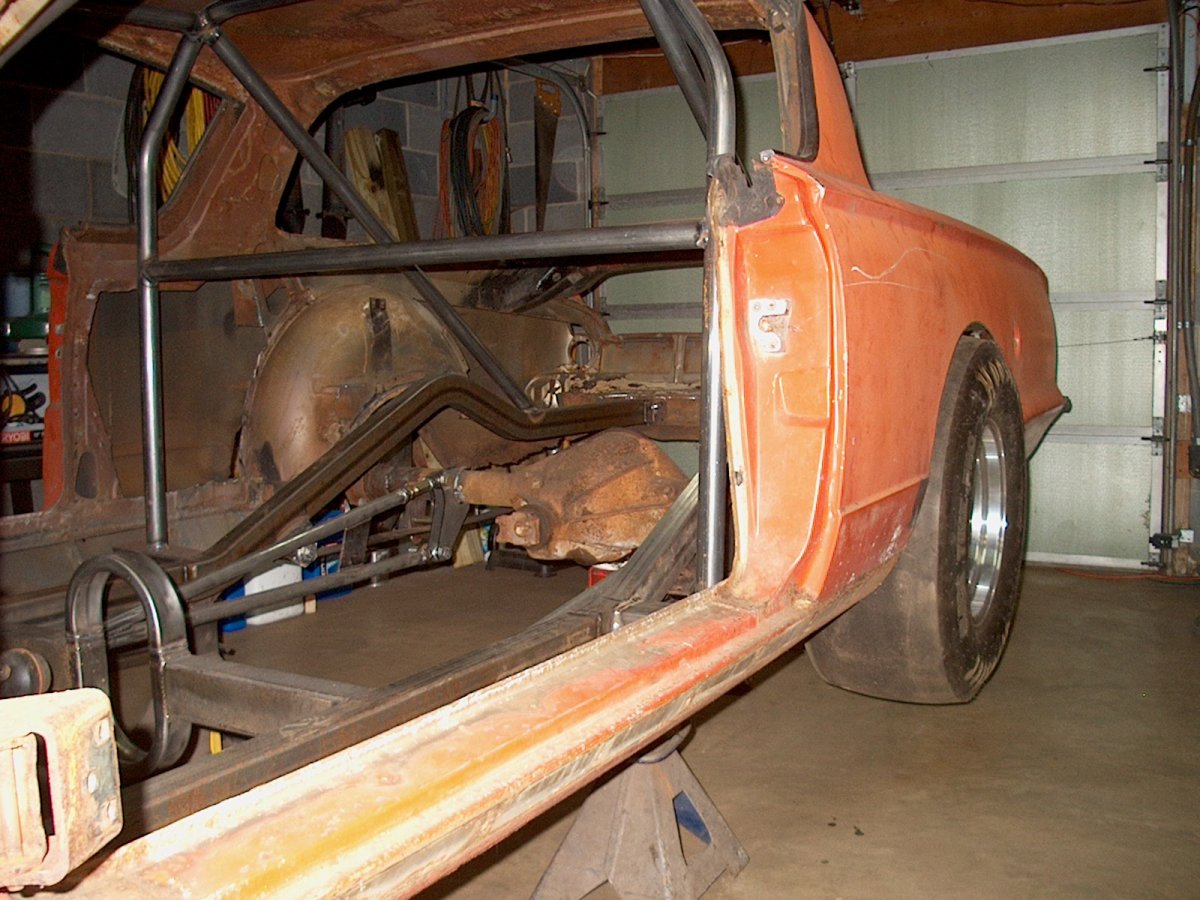

    Another good week. Located the rear springs. Installed the basic cage. Nothing fancy...simple and safe. Moved the engine back 4" more. Couldn't resist, installed one wheel and trimed the wheelwell. Had to see the look. This is where the cars develop WK4-1.JPG WK4-2.JPG WK4-5.JPG WK4-6.JPG WK4-10.JPG their personalities.

    I have never seen a build go so fast your going to be ready for the spring race with bells on. I,m glad you cut the wheel openings that's what makes them look like a gasser.

    Thanks. It all has to come back apart for paint and detail work though. Have to figure out a paint scheme too. Getting what I can done before cold weather sets in. Cold weather is the time for engine, transmission and rearend assembly. I'll see you saturday.

    Oh yeah !!! The rear wheel openings are "Spot On" !!!

    The rear frame rails are as wide as the stock frame, so I tied them in at the holes used to attach the rear bumper-using that rear structure. Frame attached to body shell at the bottom a & b pillar sills and where front down bars pass by the lower windshield bed. I'll get some pics later. Floor will be later. Have to deal with the front axle next...after Greer this weekend.
