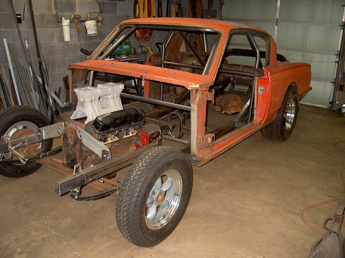

    It rolls!
    Monday was my wifes birthday. Instead of going out, we stayed home and worked on the car. She said--"we're going to Greer saturday aren't we?" I'm a blessed man! IT ROLLS.JPG

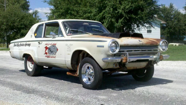

    No problem anytime I wasn't for sure how close the barracuda and the dart were I used the a-100 springs as well looked like you had new ones that's why I asked about them here is a pic of my dart it was a 440-4speed it ran good but not good enough to run with the southeast g***ers

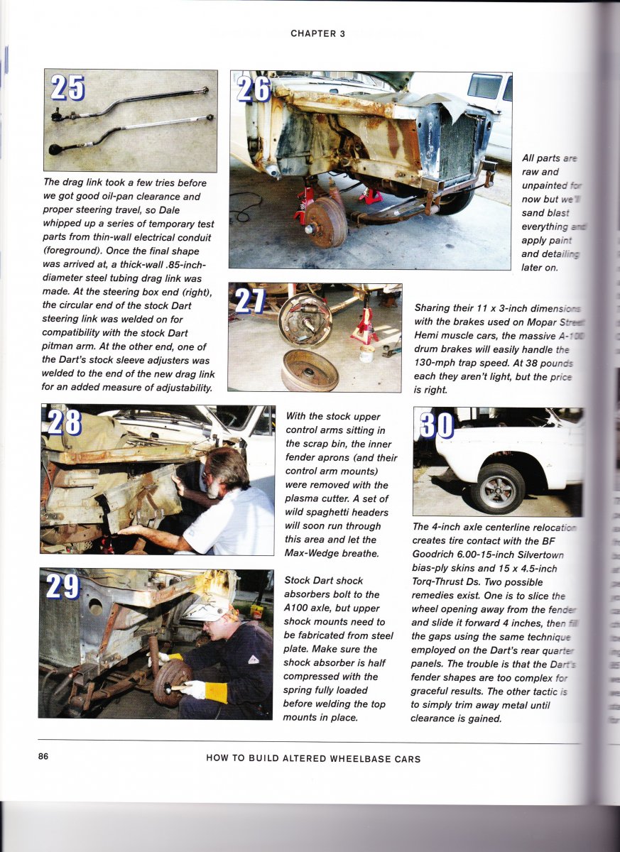

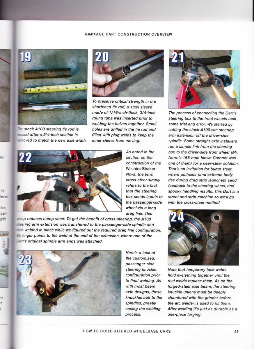

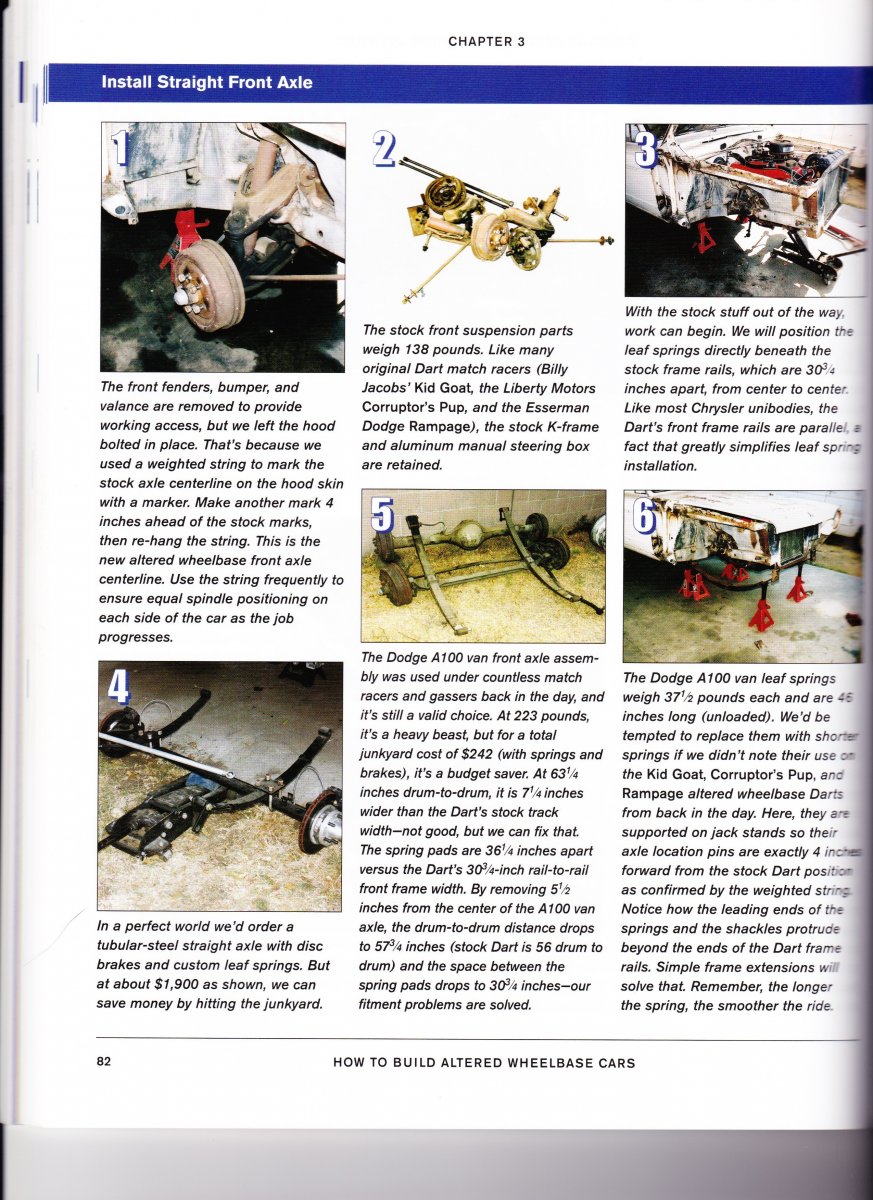

    Steve Magnante's AWB book starting on page 82 covers using an A-100 axle with an early (65) Dart including how he jigged and cut it. He took out 5-1/2". If that'd be helpful I can scan and post just say the word.
    loudbang and kidcampbell71 like this.
  13. HEMIBERT
    Joined: Jun 30, 2013
    Posts: 416
    HEMIBERT
    That would be great if you don't mind. Was building a jig for mine. Interested in seeing how he did it.
    Thanks
    fast30coupe likes this.
  14. b-body-bob
    Joined: Apr 23, 2011
    Posts: 712
    b-body-bob
    Here are those scans, I hope they help
    Image (27).jpg Image (28).jpg Image (29).jpg Image (30).jpg Image (31).jpg Image (32).jpg
    I'm pretty sure the guy who worked on the build (Dale Snoke) is a member here too

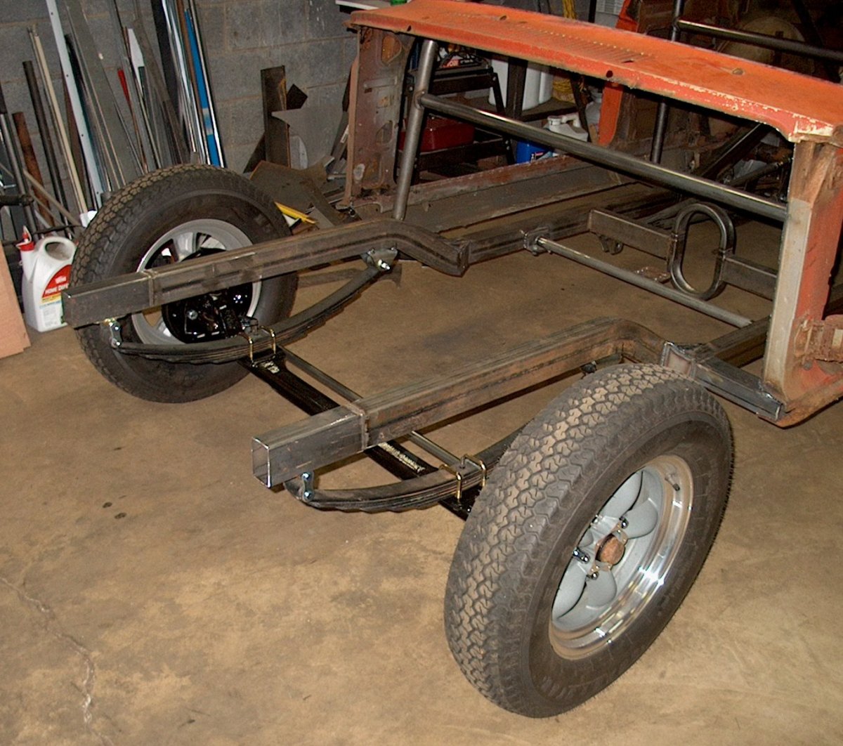

  23. HEMIBERT
    Posts: 416
    HEMIBERT
    Slow week. Narrowed front axle, made new steering arms and drag link, narrowed front frame rails same amount as axle, rebuilt hubs, ***embled and located all in frame. All = no visual progress.
