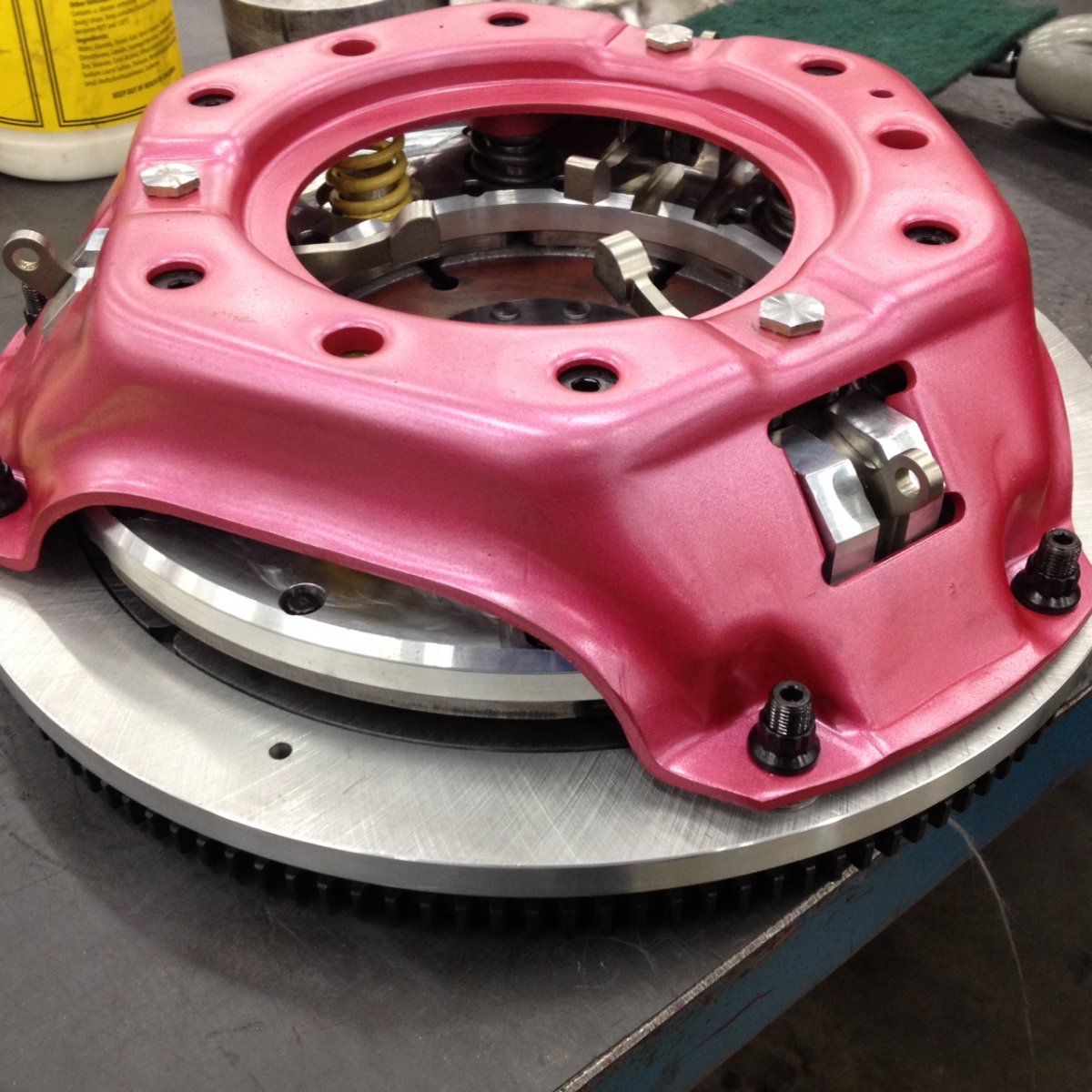

    Here's a picture of the RAM unit, its got a sintered iron disc

    This pic is the phase 2 unit. The cheaper one don't have the sintered iron disk and don't have the trick aluminum reinforcement added to the doughnut. The aluminum reinforcement was added after some testing in the Pale Rider 55 chevy. And yes they are fully adjustable.

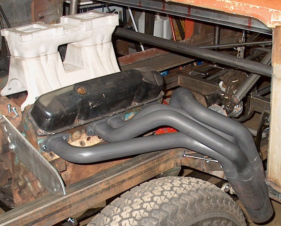

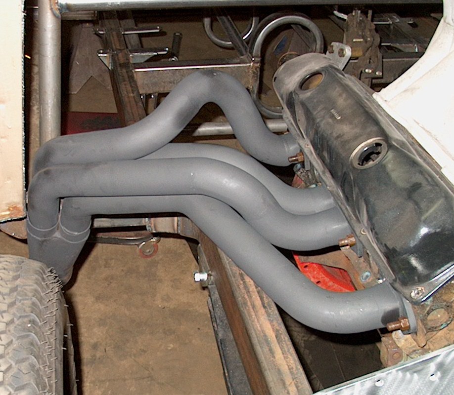

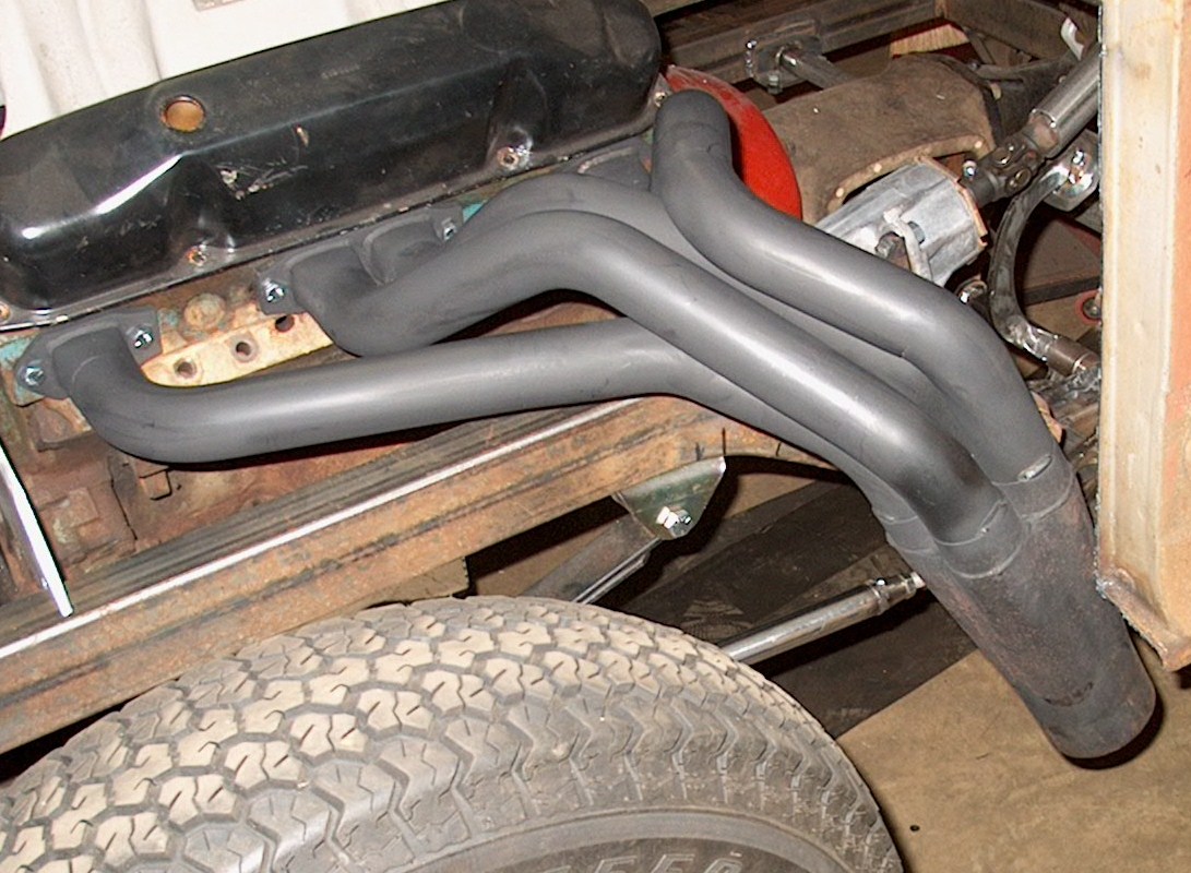

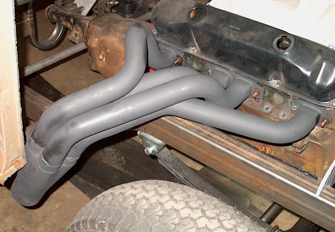

    I found a new set of bbc tri-five headers on Ebay. New headers that someone had cut the flanges off. Don't know why, but I got them for $117.00. Combined their pieces with an old set of Hemi headers I had + a set of******* flanges that were laying around to build my headers. Not bad for home-made. All the tubes wound up being < 1"> in length. Got steering linkage all fabed and installed. Turn the wheel right and the wheels point right--a HEADER1.JPG HEADER2.JPG HEADER3.JPG HEADER4.JPG lways a plus. Cutting and fitting my interior panels as I go, but not installing them til frame is finish welded and painted. Same goes for the door bars. Much easier to work around with them out. Have the last 2 weeks of the year off, so I'm trying to get all my little pieces parts together for a big end of year push.

    Really looking good, Headers look like they should.

  25. loudbang
    Posts: 40,346
    Any reason why one side was installed with studs and the other with bolts?

    "Any reason why one side was installed with studs and the other with bolts?"
    It's a junk block and heads. Studs didn't want to come out easily, so I just left them in.
